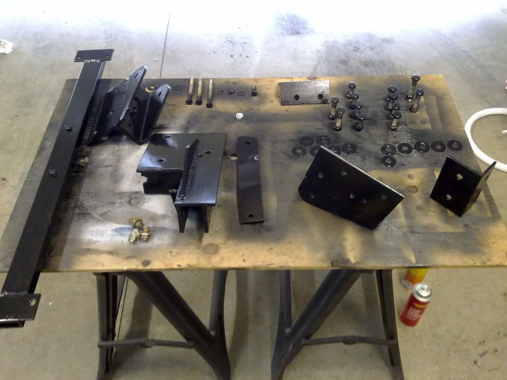

Got some parts cleaned and repainted. That's about all I have done so far besides taking measurements and ordering parts.

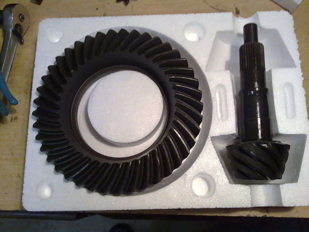

All the parts are ordered. Got a ring and pinion 4.56 to match the front. And ordered some rough country 6.5 xj coils. So everything is on the way for the swap and should be starting soon.

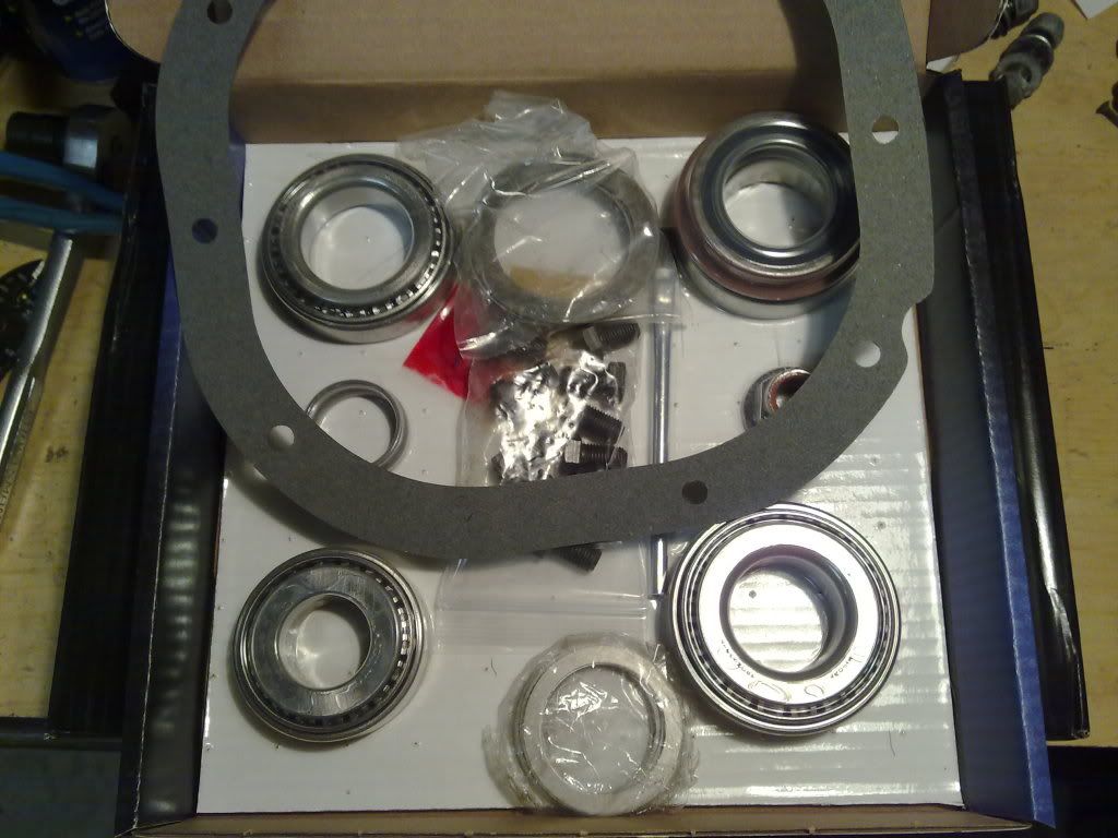

Motive 4.56 and Motive master kit and also got a solid pinion spacer so I dont have to use the crush sleeve. The solid spacer is nice when setting these up, if you make a mistake and need to take it apart, you don't have to get another crush sleeve.

had the last few of mine done with solid spacer when i had 8.8. had issues with yokes staying tight.
I'd rather setup my gears with a crush sleeve anyways. Much easier to sneak up on the preload than to torque it down - wrong preload - take it apart - new shim stack - torque it down - wrong preload - take it apart - new shim stack - repeat repeat repeat.
bobby - go check your pm's on rrorc. :thefinger:
Ive done a couple of 8.8's with the shim packs and I havent had a problem. Set it up, torque it, and forget it. If you use the thickness of the previous crush sleeve as a starting point, its a hell of a lot easier to get the preload right the first time. Both times for me, the thickness of the crush sleeve was perfect and I didnt have to pull it back apart. Id do a shim pack way before Id ever do a crush sleeve again, much easier...

If for some reason the pinion depth is not right and have to take it apart and add a shim, then the crush sleeve is not useable anymore. So that is why I choose to use the spacer instead of the sleeve. Also, if you have to change a pinion seal, then you dont have to take the whole diff apart to change the crush sleeve.

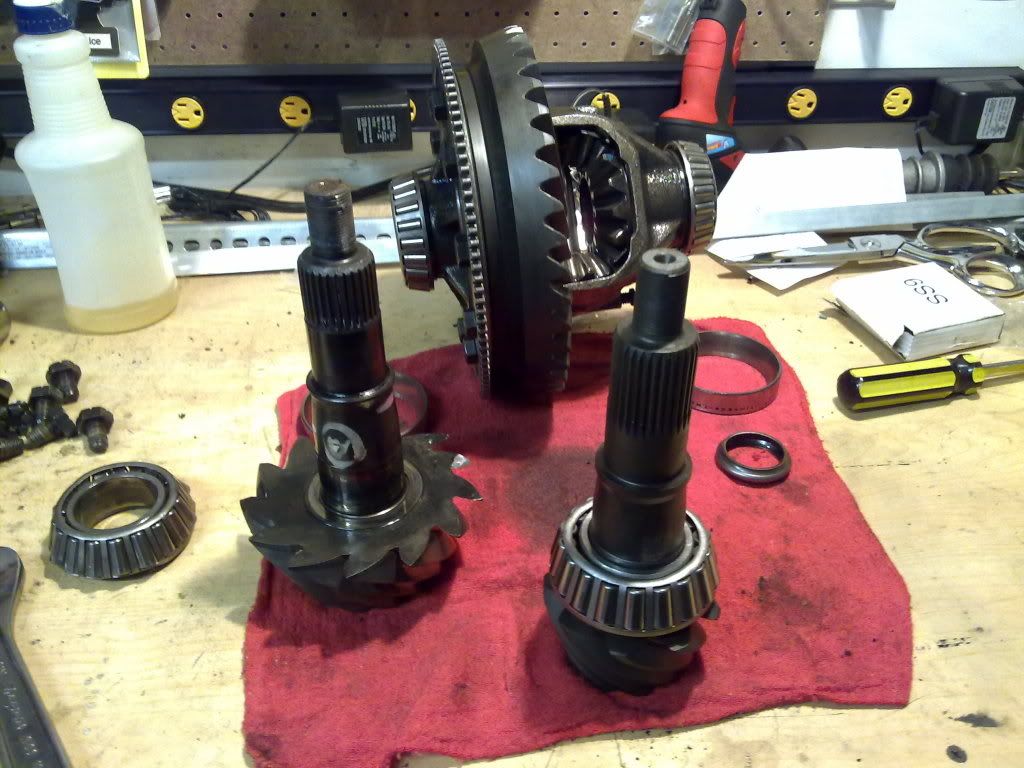

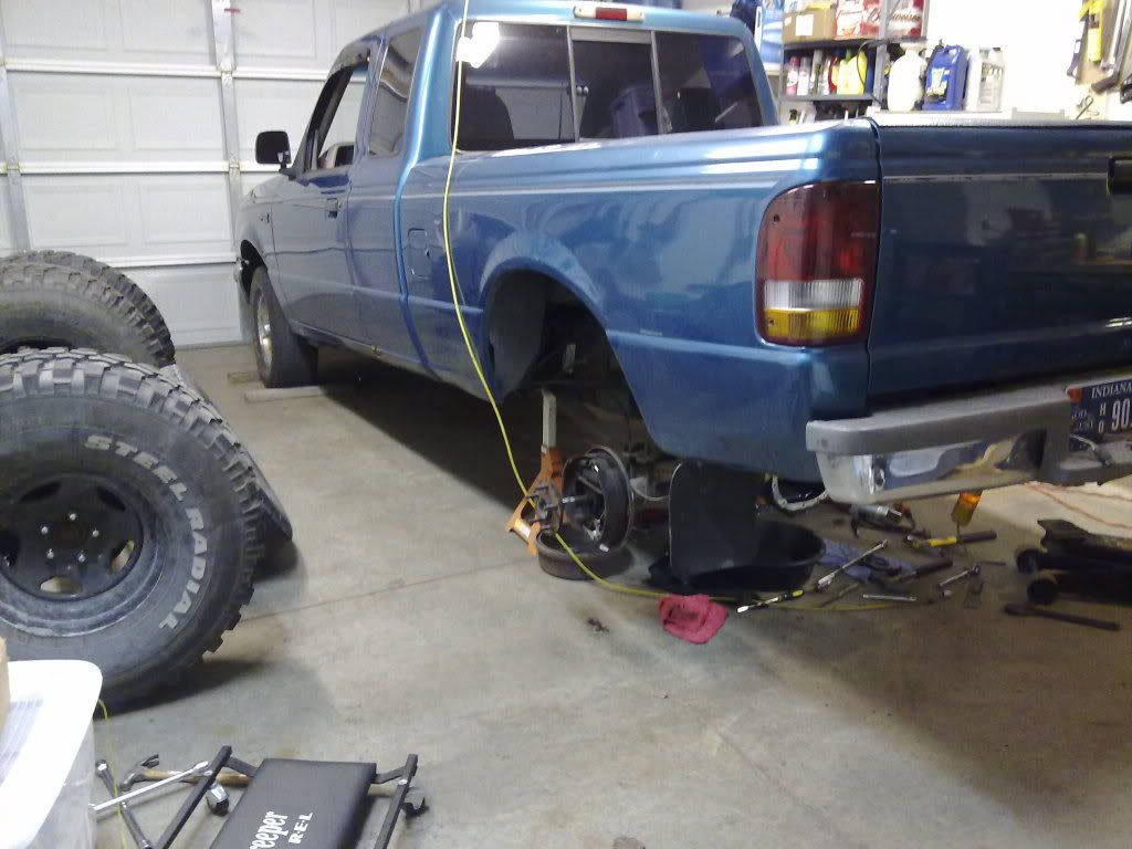

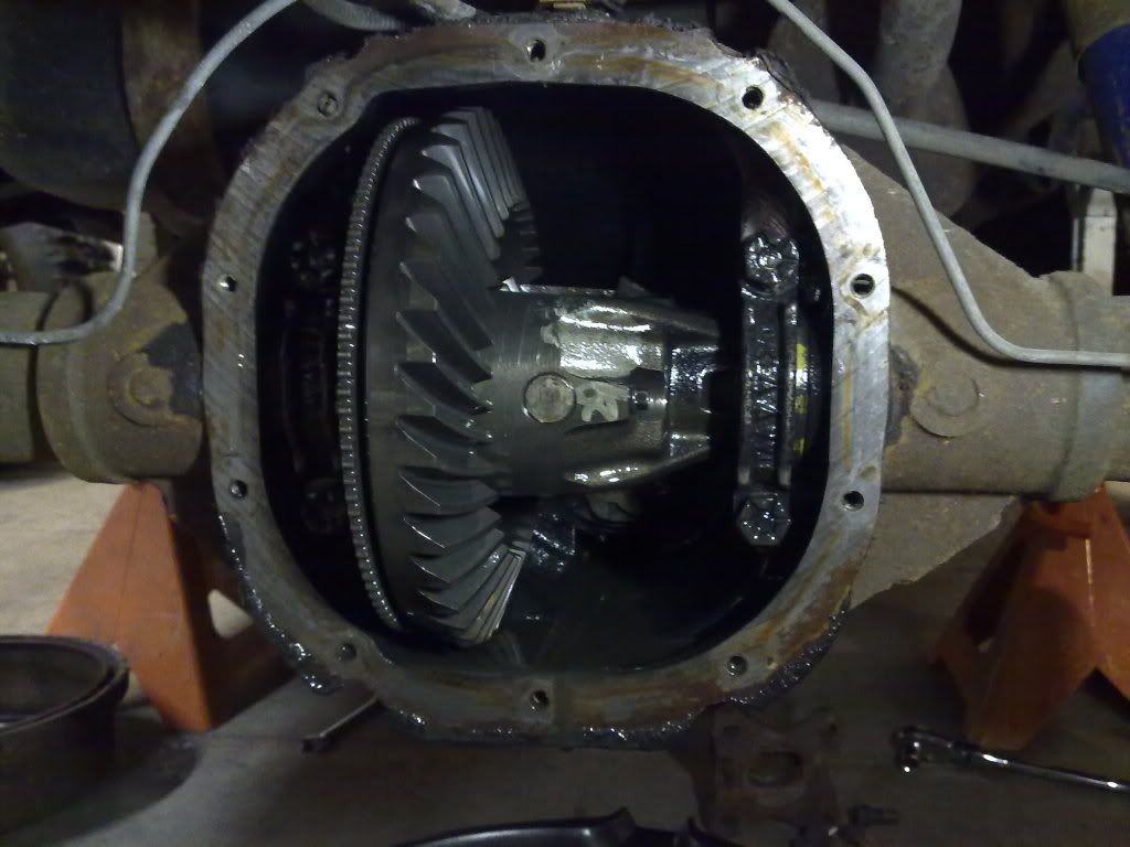

I ran out of time today to finish the gear change. Got it all torn apart and on the assembly side now. Here are some pics, it's hard to take pictures with dirty oily hands so I tend to forget to take them untill I am done...
