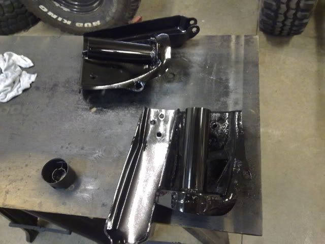

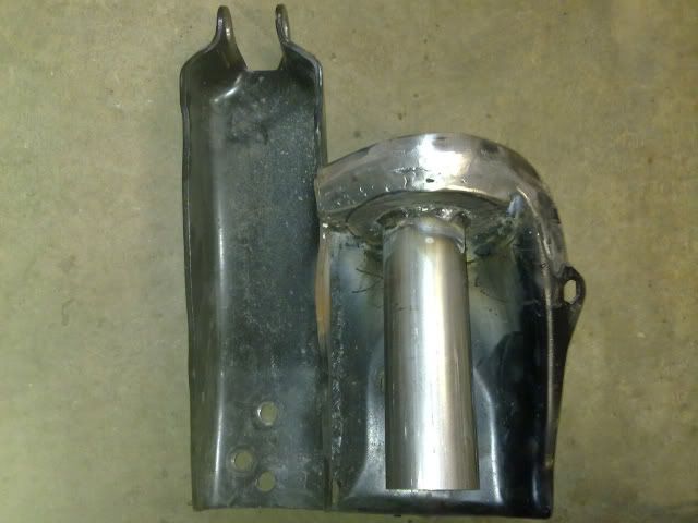

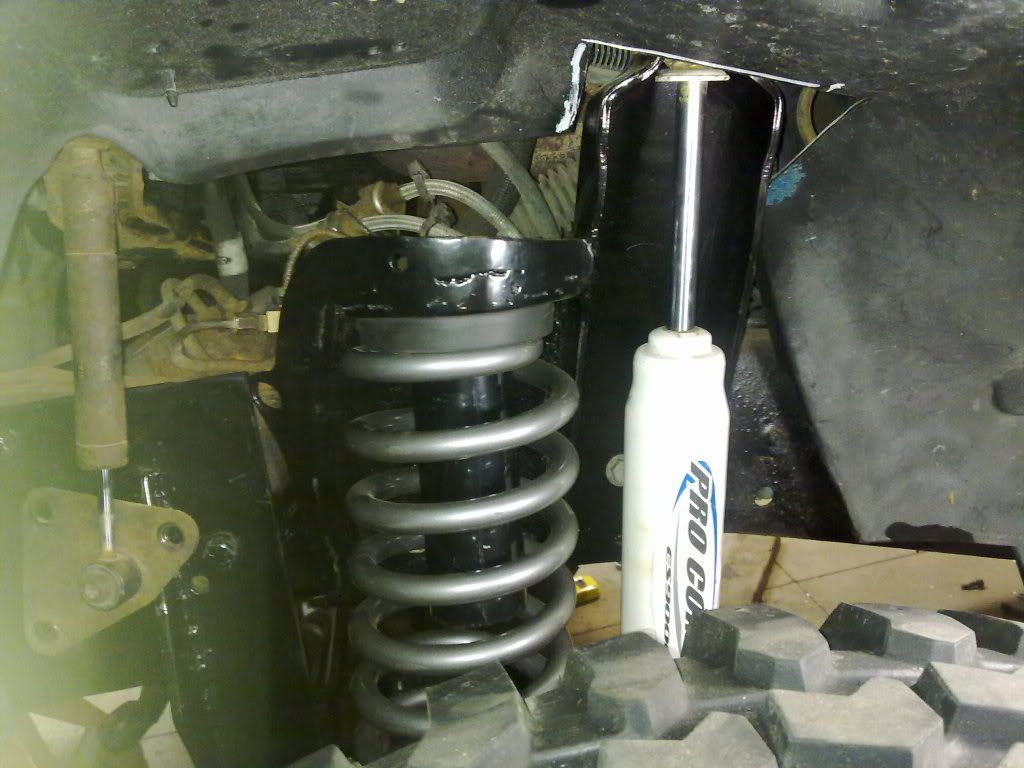

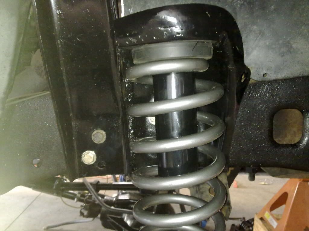

Had some free time today and modified the spring buckets to fit the XJ coils.
I have some rubber insulators/spacers for the XJ springs that will slide over the center. So now its all ready to get torn apart this weekend.

I used a J clip to hold mine on the top bucket.
Start ripping the new one apart, its dying to be 4wd D30 SAS'ed!!!!!!!!!!!!!!
Well that way the spring can unload under flexing. I figured I would try it and see how well it worked.
coil buckets look good. i need to get some 250 shock towers
Same here but mod them so that they can accept stud bolts on top, I know they are reducing how much I can flex and how well my suspension performs due to compressing all the way.
so you need early bronco shock towers then. Check Jeff's Bronco Graveyard, they have them.

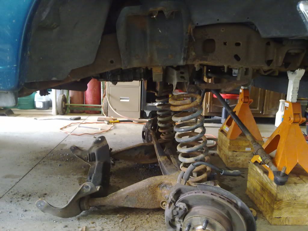

2WD TTB out. Only took me 3 hours. What a PITA.

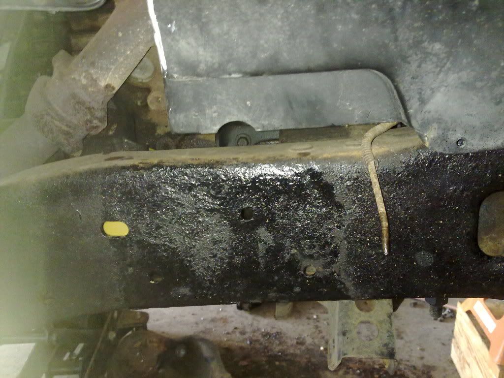

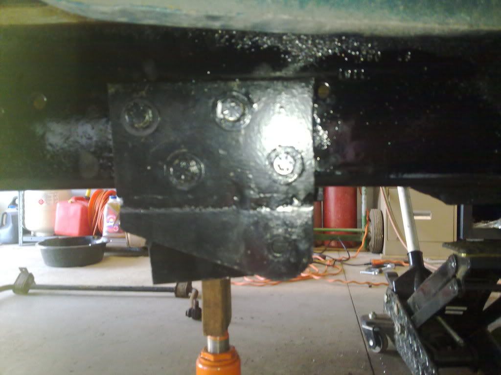

Holes drilled for the link brackets and frame rails painted.
Link brackets installed...

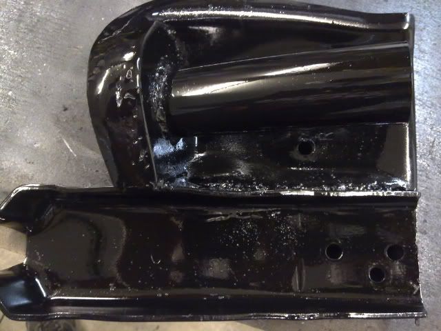

Frame prepped for the new coil buckets...
Driver side prepped... track bar bracket installed...

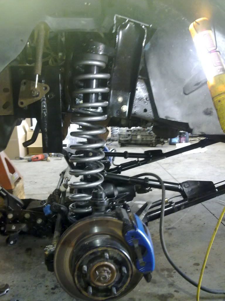

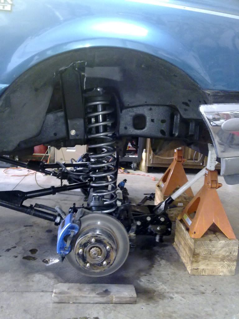

Axle in springs sit good in the coil brackets... no weight on them yet.

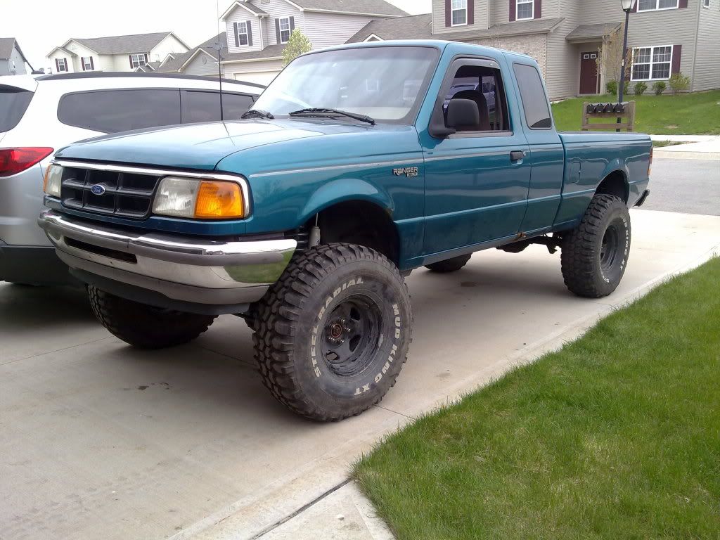

Truck is sitting on the tires on its own weight.

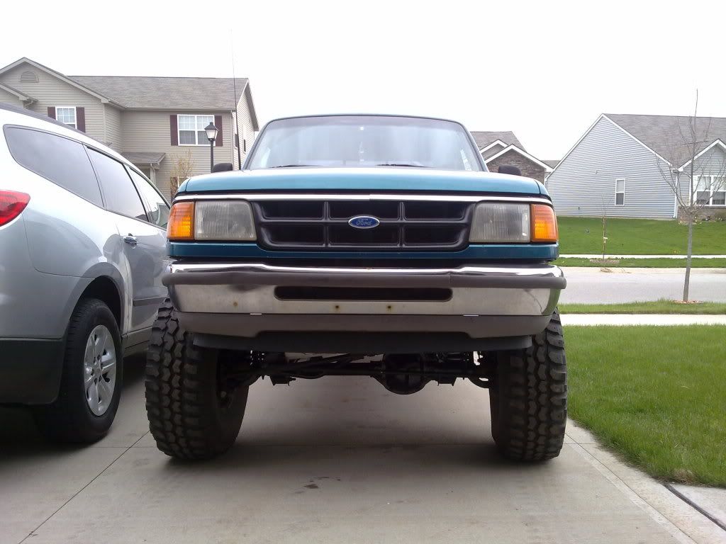

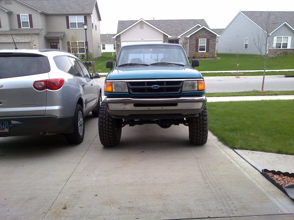

My plans are to drive it to work monday morning. Should happen if I dont run into any problems...
that was FAST!.....i guess it's a little easier since you've done it all before
Got it done today, went for a drive. Handles good, just needs an alignment. I got it close but still needs fine tuned.
