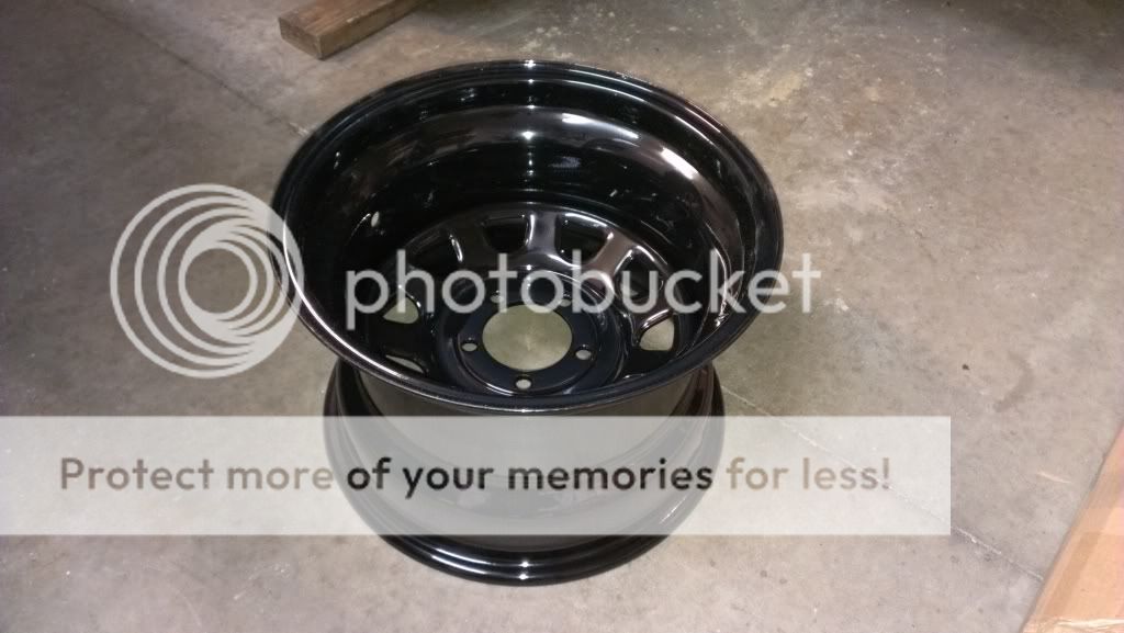

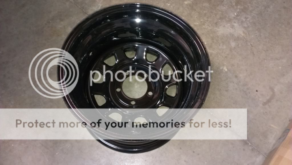

This came today

I also ordered some 7/8 rod ends to replace the GM 1ton TRE, along with tube adapters and jam nuts.
