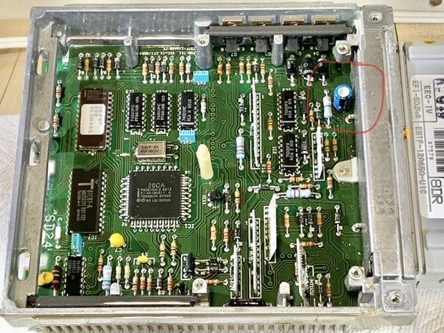

Listen to @RonD for the finer points of the ECM. Im far from an EFI guru. My speciality has a choke and idle screws lol.What do you make of the eec showing a huge decrease in voltage st pin 22 between KOEO and KOER?
