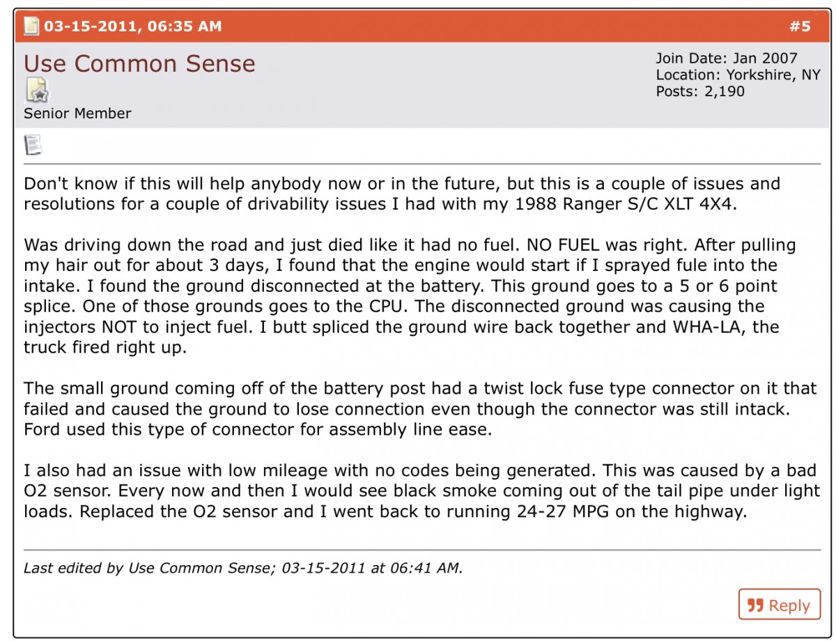

Missed this first reply, I’ve checked power to so many things I forget if I’ve done the high pressure pump but will do it again. I must have as I hardwired it at one point but I’ll get it done again this weekend. I’ll also grab fresh compression readings. The inertia switch was removed and wire nutted by the PO. I still have the switch in the box ‘o parts that came with it. The three relay harnesses were all rotted when I got the truck, so when this started I soldered in new ends for all three - eec, fuel pump, and wot. I still think there could be a rotten wire somewhere deep in the harness, but it’s not at the ends.
I did have a slightly kinked feed poly line between the tank selector and the reservoir. I replaced that in a long shot but don’t see any others. But now that you bring it up I haven’t removed the rubber surround on the lines that attach to the fpr and rail. They were moved off to the side during the head install and that polyurethane does seem to stiffen up. Maybe there’s a kink in the feed line? I have a roll of poly fuel injection line from a different project, perhaps just replacing everything is the way to go.
Going through the grounds couldn’t hurt either. Might try to find the 5-6 point splice this weekend as well.
The fuel system on this ting has been possessed since I got it. I replaced the high pressure pump shortly after. Then a year or two later going around a curve it sputtered and shut down. Checked the rail and there was no pressure. Had it towed home. Couple days later hopped in and fired right up.
