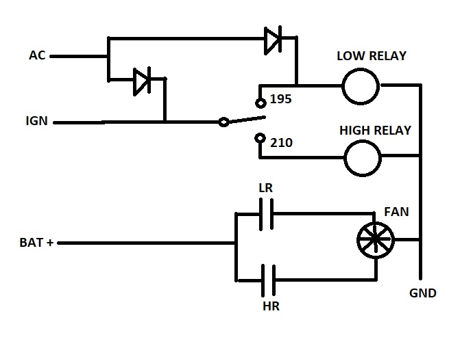

Here's what I have for a draft schematic now:
51799
In this design, turning on AC (purple wire going to the cycling switch on the A/C dryer) forces the "L" relay on (via diode), and via the "AC" relay, switches the output of the "L" output of the temp switch from controlling the "L" relay to the "H" relay. The arrangement of the high-current wiring (using the NC side of H relay to feed into the L relay) ensures that only one motor input is on at a time, and H side wins.
I figured this would provide better cooling when the A/C is on rather than relying on the increased temps of A/C usage (passive heating via the condenser) to up the fan speed. Given the 4.0's known tendency to crack things when overheated, I wasn't wanting to take chances. I still want to run a 195 T-stat for efficiency reasons.
I'll mull over it, but I could make the temp switch ground sided and still have the same net result if I swapped the diode for one more Bosch relay (two A/C controlled relays, one per speed range)... I don't see what that would gain though; many other things are run on the truck with high-side switches (such as the A/C, obviously). If the switch is rated for it, as long as I properly insulate things, I'm not seeing the issue.
It sounds like I might want to buy both temp switches... now that I think about it, wouldn't I want the high temp switch (195/210) for the lower hose, since that's the outlet of the water pump (hot coolant coming from engine)? If I run the low temp switch (180/195) there, I'll almost never get the L range (defeating the purpose of a 2 speed switch), since once warmed up (thermostat opened), my temps (current setup) run in the 190's to the high 210's, which is what one would expect with the stock 195 degree t-stat? I thought the low temp switch was for applications using a 180 degree (or lower) T-stat?
The other temp switch(180/195) is for use on lower radiator hoses, and its temp is 180 when upper hose is 195, radiators provide 15deg of cooling, so same on and off as upper hose(195/210) , just out of the way and no way for an air bubble to cause fan to not come on

You could add a 3rd AC relay(turns on relay with 12v) that would ground the low speed relay's ground wire(grey) and it wouldn't effect high speed coming on
Just don't like the idea of running 12v thru the temp switch, lol, it should work, just don't like it
How about this version?View attachment 51811
Not crazy about that. If, for some reason the high temperature switch closes and you have the A/C on, you will energize both high and low speed fan motor windings. Plus, why the A/C signal going to the common supply to the temperature switch? That is unneeded.

I saw the bit on the volvo relays (where I started my design from, actually)... the volvo relay module requires ground side switching, which is why such designs (and things directly modeled after it) use such. I'm not using volvo relays, hence why I'm asking.

I've seen automotive relays and actuators switched both ways... If high side switching is so "evil", why did Ford use for for the A/C clutch circuit? That wiring goes all around the engine bay...
One required thing your circuit seems to be missing: When the relay commanding "high" speed closes, it must also open the relay commanding "low" speed, otherwise you burn up the fan motor. If you look at the circuit on the tech page for "Volvo fan install" it will show you how it should be wired. To add the command for "low" speed when the a/c is on, you just add a relay that grounds the "low" speed side of the BMW temp sender circuit as was suggested above.
Whose schematic are you referencing?
My schematic (post #3) takes care of that issue by feeding the "L" relay contacts from the NC of the "H" relay. If both turn on (which in my design, will often happen with the A/C on), the fan will get high only due to the NC of the H relay cutting power to the L relay's contacts. Which is why I was verifying that the motor inputs are indeed 1 at a time.
Franklin2's schematic does indeed have that problem... but that's not the schematic I'm using.
12v switching is not "evil", lol, it comes down to wiring exposure
If you just need to run one 12volt fused wire to a "relay pack" and then the rest of the wiring can be Ground controls it reduces exposure to shorts because a ground wire short won't blow a fuse or melt a wire
One is not better or worse, as far as the "control", but ground control is "smarter" because it reduces the places the wiring might get a short that blows a fuse or melts a wire
If you have choice of running 4 12volt wires or 7 12volt wires use the 4 its "smarter", not better

It would only be 4 12V wires...one is unavoiablable (the A/C connection), and the other three are going to the switch. IMHO it's better to go with the 12V switch layout which is more reliable (3 relays and diode vs 4 relays).
