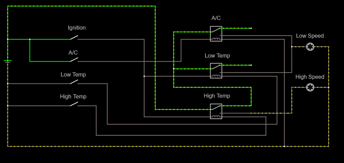

This is the circuit I plan to use:
69342
3 Bosch style relays and a 40a fuse.
