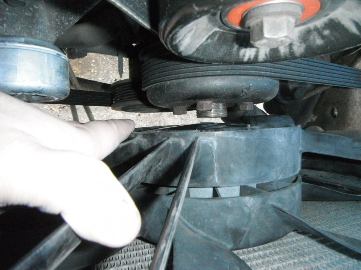

Went to test fit it, and it doesn't clear the water pump:

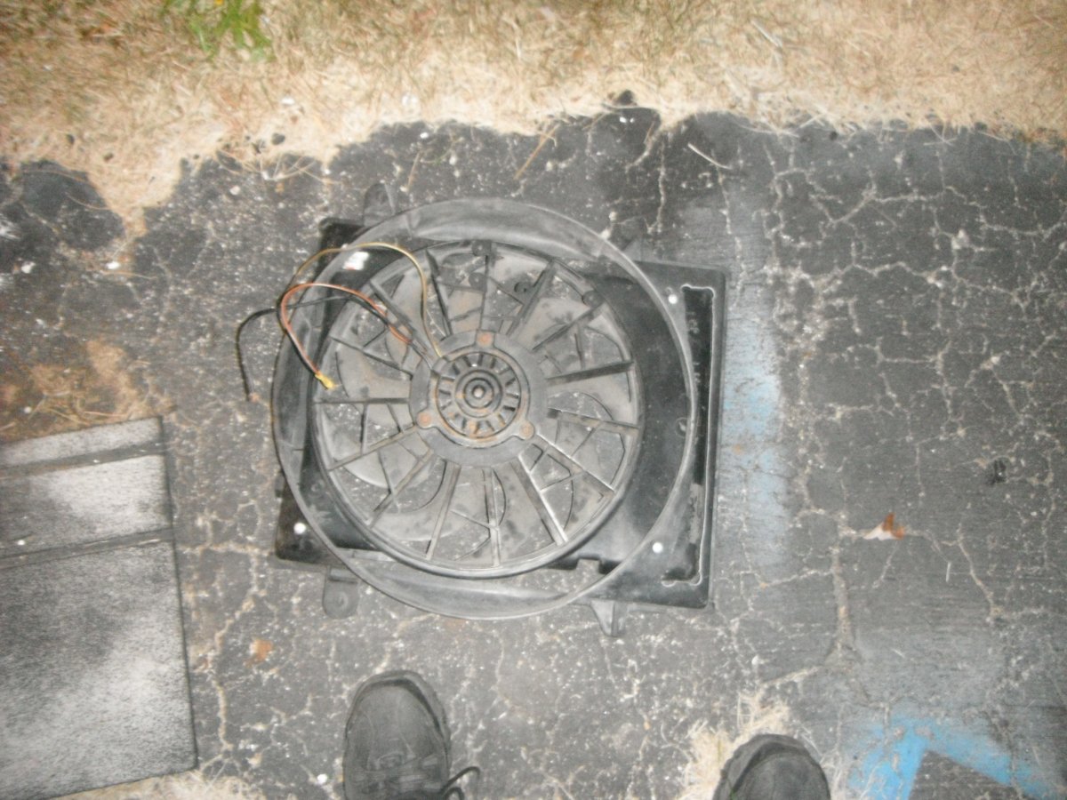

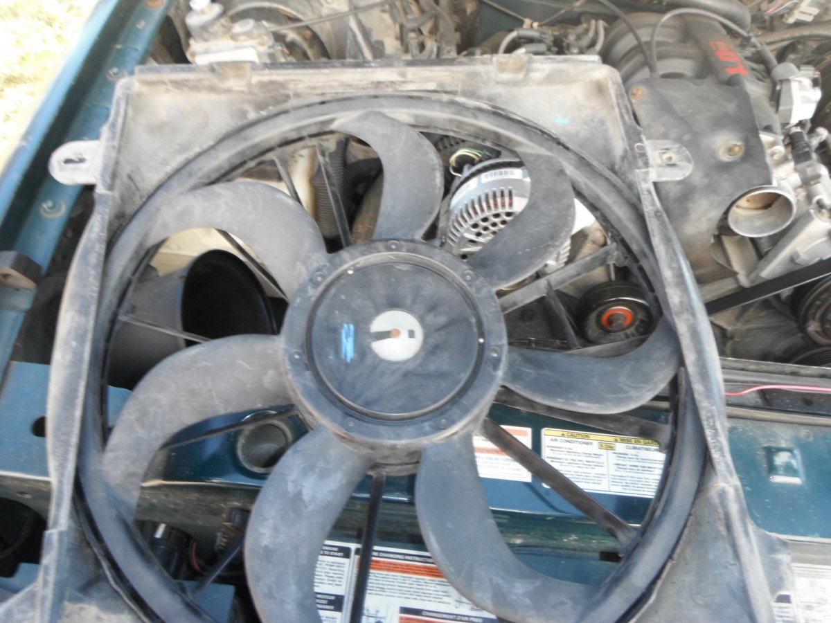

Pics of my assembly I made:
52451
52453
52454
(The wires were cut like that when I bought it. For $2.50, I'm not complaining!)

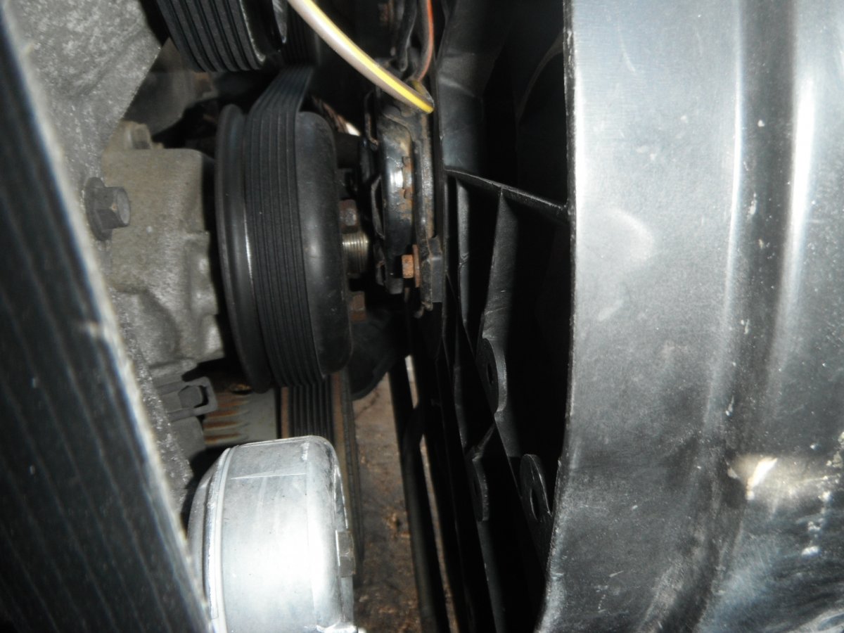

The issue is the bump on the back of the motor is smacking the threaded snout of the water pump. I clear everything else.
Do they make a water pump for the 4.0 that doesn't have the snout? I'm not too opposed to a water pump replacement considering that I hammered on it a bit to get the fan clutch off.
Or is there something I did wrong? I trimmed the Taurus shroud a bit shallower to clear already (1/8", on bottom end )... I'm not thrilled on trimming more as I don't want to risk vibration/flutter causing the fan to jump forward and kill my radiator.
Edit- Rechecked, no, the entire motor is hitting the water pump pulley. The last picture is misleading; the motor hangs out the back of the housing by about 6-10mm or so.
Going to see how much more I dare trim/shim the motor forward... ugh. Edit- about 9mm of existing clearance. Not much... about the amount I need, which is too close since I want to have some clearance.

Took some measurements, it looks like it's possibly a no-go due to the fan physically being thicker (110-115mm) than the minimum spacing between the water pump snout and the radiator (105ish mm)
One idea I've had is to jack up the fan in the shroud (no longer concentric) and see if that will give the clearance I need. But that's also no good, as I only have 35mm to move, but the radius of the motor casing is about 50mm.

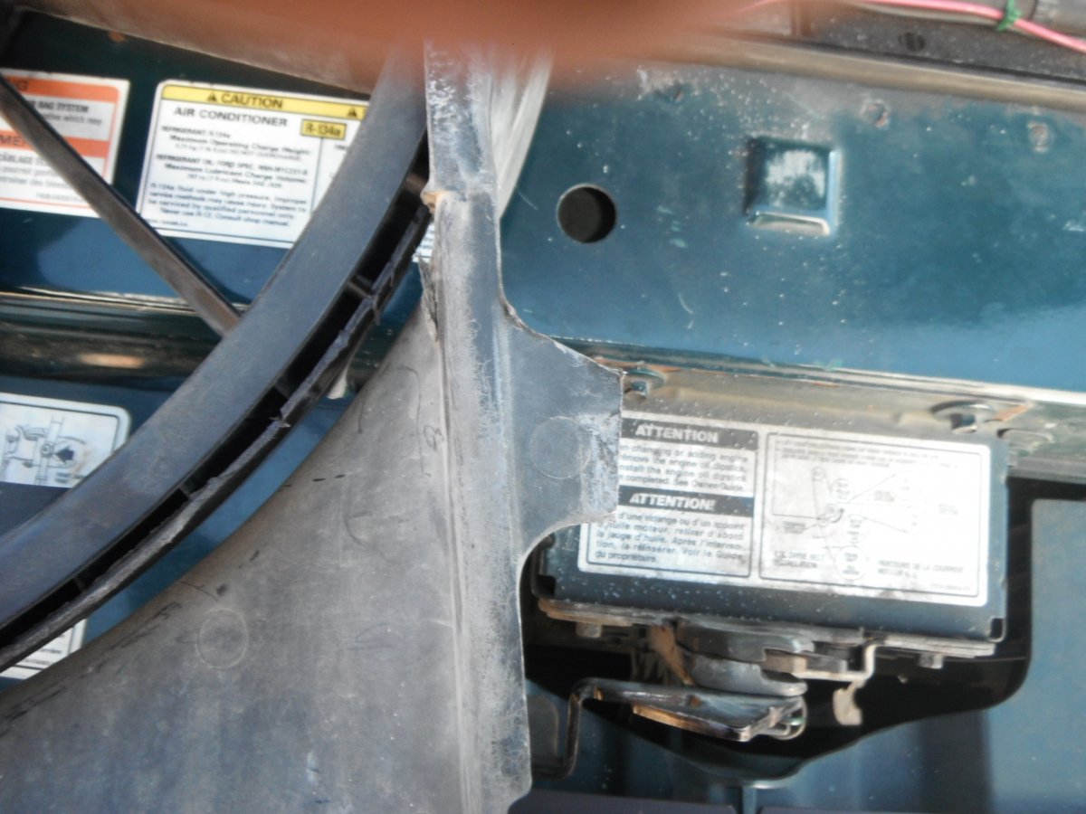

Trimmed the taurus fan shroud (removed from my modded ranger shroud) as low as I go (fan shaft nearly touching a straightedge), and nope, doesn't fit:
52464
At that point the top of the fan rotation is right at the top of the radiator, so mounting higher isn't really an option :(

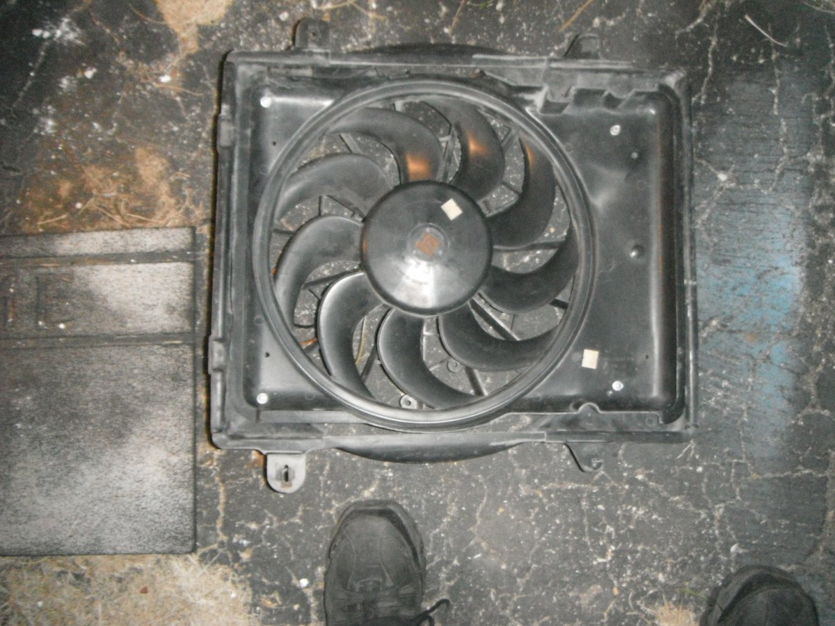

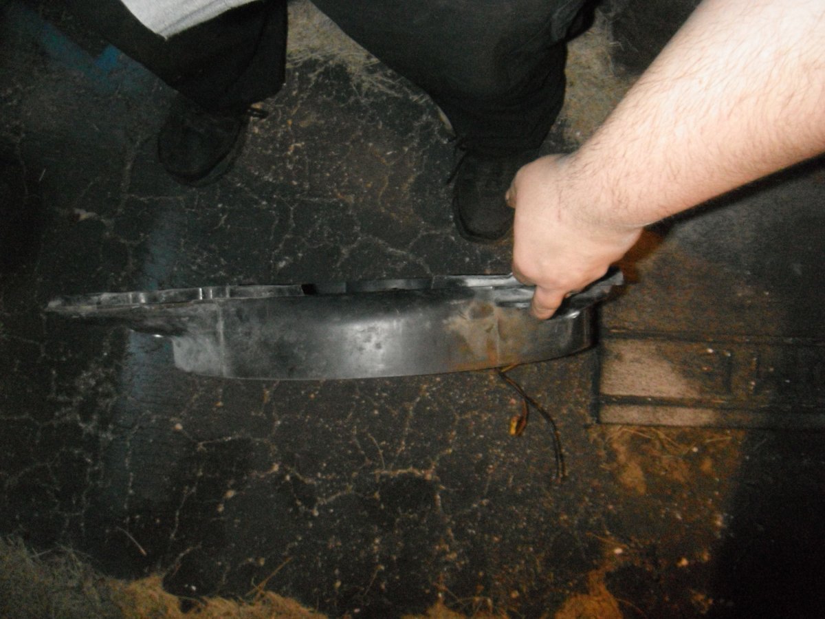

Went to pull-a-part in search of the Caravan fan. No dice. But I did see something that could work, sitting in the front of a Dodge Journey:
52490
(I also got the fan shroud off a 1996 4.0 ranger, same thing only with a warning sticker instead of raised letters)
The journey fan is only 90mm or so thick, and nearly the size of the stock fan opening. The fan and motor comes off the frame with 3 torx screws, making it so i can use off the shelf parts if I need a new motor down the road. All I need to do is figure out how to merge the two... Maybe there is an epoxy that works well with the fan plastic and fiberglass shroud?

Just got home (spent the evening at my parents' house, which is not far from Pull-A-Part!). Tested the fan... it does work (whew, the vehicle it came from had overheated and warped a bunch of plactic coolant fittings!), and moves a lot of air. Green is positive, black is negative. It came from a 2011 Dodge Journey with a 2.4L engine (and the only journey on the entire lot!). Per looking at the owner's manual online, it uses a 40A fuse, putting it on-par with the high speed of the taurus fan.
No picture, but it does fit if I mount it flush. I get maybe 10mm (3/8") of clearance in that case. Now I have something to work with.
