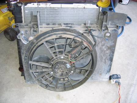

I installed the electric cooling fan from a Volvo 850/S70 because they are 2 speed fans and have a shroud that is easy to trim to fit the 4.0 radiator. The Volvo fan is 16 inches across and the 4.0 rad. is 18 inches wide. I wanted to use as much of the original mounting hardware as possible
Here's the Volvo fan with shroud uncut next to the Ford radiator.
Electric cooling fan mod using a Volvo fan/relay
Make sure you get the Volvo relay--it makes this job very easy.

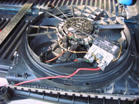

There is 5 inches of clearance from the radiator to the front of the waterpump, so the shroud must be trimmed down. I used a circular saw for most of the big cuts and a hacksaw for the finer work.

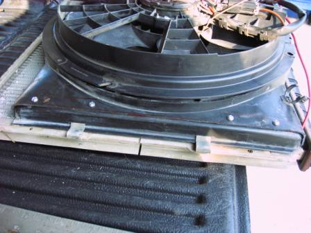

I decided the Volvo shroud fit best by turning it sideways on the radiator. I cut off the bottom section and then trimmed about a 1 1/2 inch section from the piece I cut off to insert at the bottom of the shroud. This provided a lip to engage the original clips on the bottom of the radiator and closed up the gap from the cut.

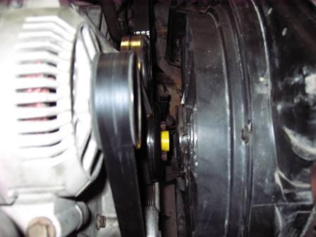

Testing the fan and radiator clearance and I have a little over 1/2 inch to the waterpump--plenty of space.

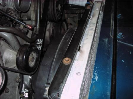

To attach the top of the shroud, I bent the aluminum on the radiator back 90 degrees and used the original spring clip nuts and bolts.
I'm going to temporarily connect the Hi/Lo speed wires to switches. Eventually, I am going to take an extra thermostat housing I have and get a fitting brazed into the pipe for a BMW temperature sensor that has both Hi/Lo temp. capability. Then I can eliminate the switches.
