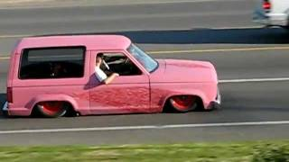

For handling, the lower, the better.
like this
NOT like this, unless you like this as much as I do
