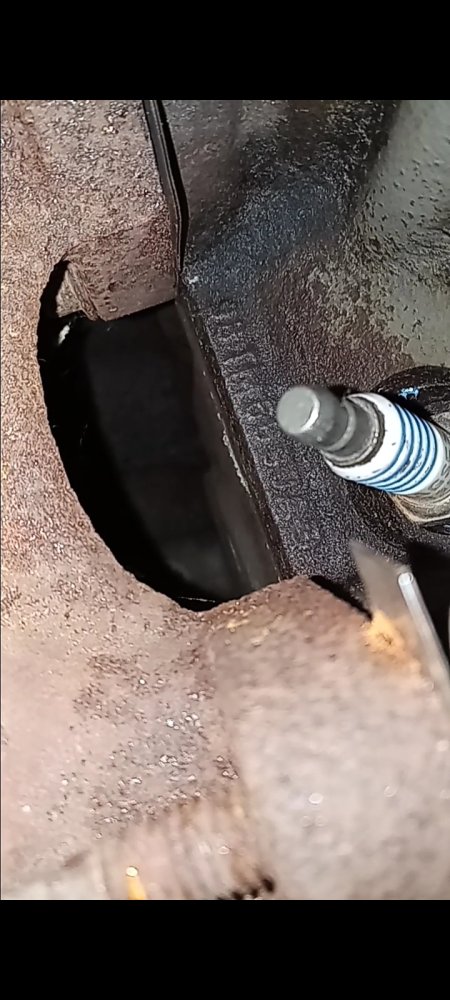

This is the number thats cast on the motor. If you can read it can you tell me year and ect.
That's the head casting number, "98TM" casting, so from a 1998 mold, used from 1998 thru 2000 on 4.0l OHV
Block and head casting numbers are not year specific, in that the same mold is used over several years if design is not changed
But unless the head was swapped it would be a 1998-2000 4.0l engine
So would the computer be different between those years
