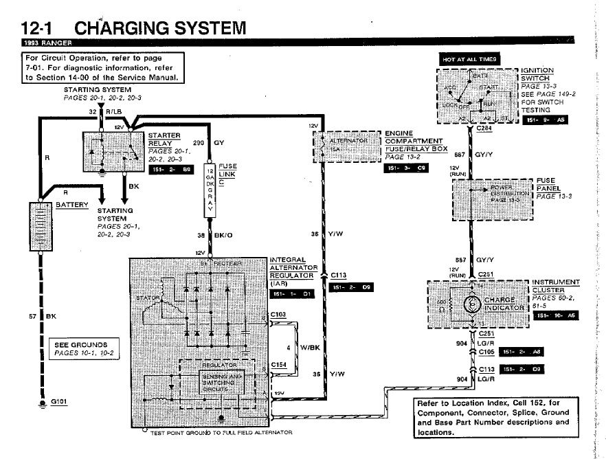

See that fuse? Check that.
You'll need a voltmeter to do any real testing.
