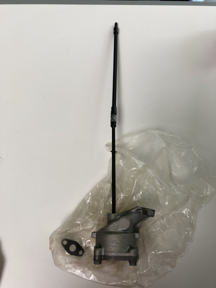

You pull the distributor, then use a drill with a socket to spin the oil pump drive shaft to drive oil through the system.
I have primed new engines through the distributor hole using a really long 1/4" hex bit extension. Works great and no chance of dropping any of it down into the engine. You can watch your gauge as you spin the drill.... should build up pressure after a while.
The machine shop I used for my last rebuild loaned me a pressure primer thing, basically it's a pressurized cylinder with oil in it that you screw into the oil pressure switch port on the block. It allows you to blast a bunch of oil in and in theory should kind of pre-lube the engine. Not sure if it worked, I did something wrong the first try and made a hell of a mess.
OK, that would make sense. Man, it's been way too long since I've done stuff like this. I forgotten most of what I knew.
:oops:
I think I used a 1/4 driver flex shaft and a drill, set up something like this.
