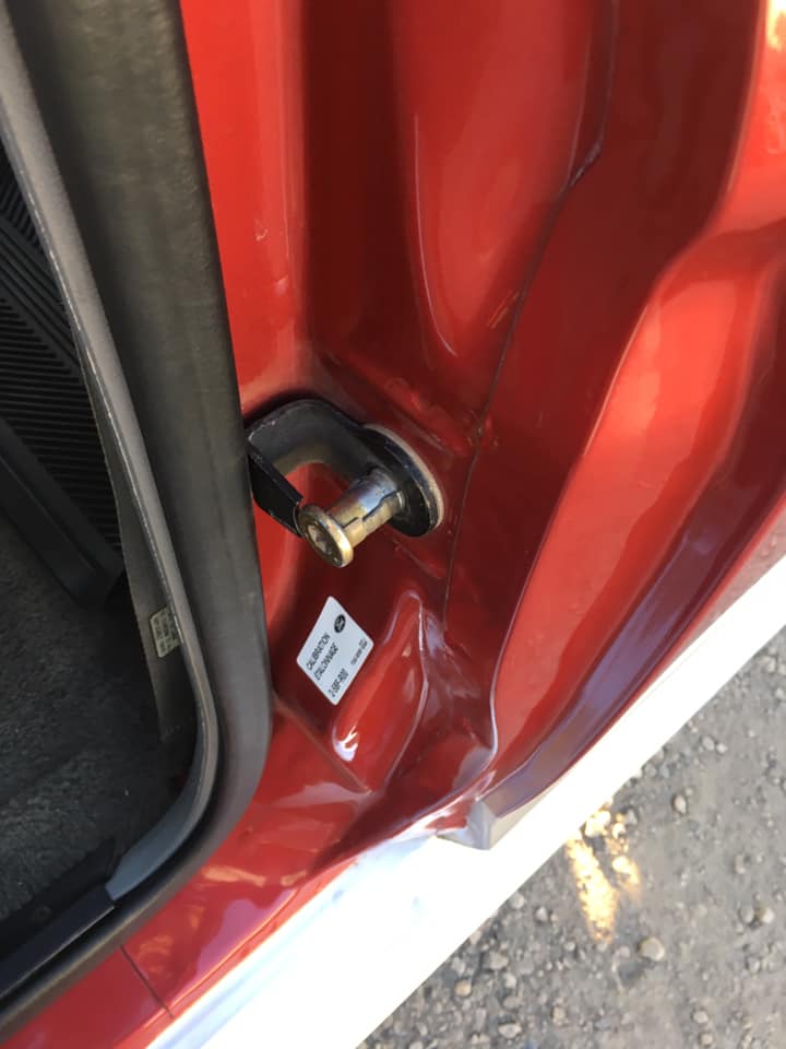

I know this may sound silly, but have you tried loosening it with a vice grip? The only other thing I could think of is maybe a higher quality TORX socket. Once you are able to get the bolt out, you will have to replace the "striker bushing", which is the little plastic piece that goes around the metal door latch. In my photos I have attached, mine are cracked, which is why my door was rattling so much. Replacing them fixed the problem immediately. Make sure when you take the metal latch off, that you properly align it when you put it back, typically there will be a ring from the dust that has accumulated underneath. I hope this helps.

I used clear tubing for the "bushing" and it works fine.If you can't remove the torx you can just slit the tubing and force it over the post.

Mine is not the bolt style striker. Mine is about a 1/4" thick round piece in the shape of a 90° bend
Post a pic of your striker and latch if you've removed the door panels and checked the internals.
look for movement marks on both the striker and latch. Had the same problem on my `04. Striker lost position and just needed to be moved inboard a little, not too much or you'll wear the latch and lose future adjustments. Happened to me right after my daughter slammed the door shut. Latch stayed but striker forced inboard. Let us know how you make out.
