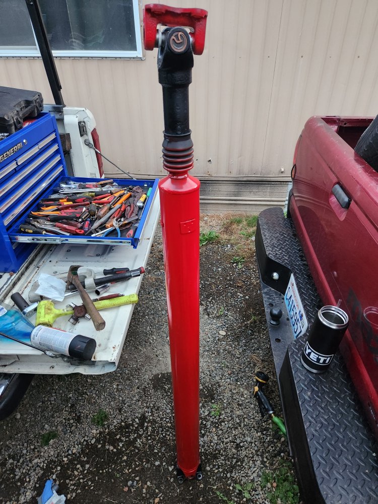

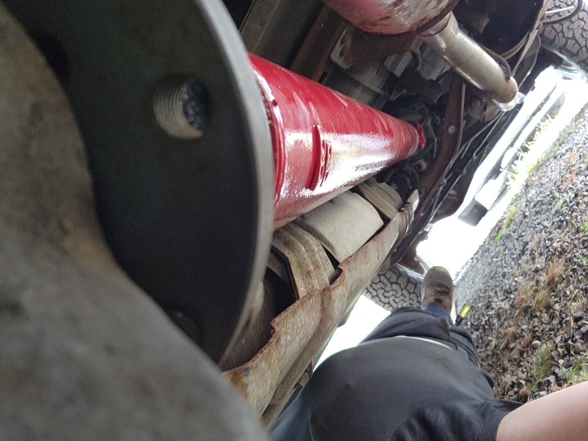

Just to complete this for others to see
Nice!!! So did you ever get an answer to question 1 ? Swapping and lifting has made me need to address those same issues.
Nope even the guy at the driveline shop was vague. But said as long as the driveline don't slam at full compression, or fall out at full flex it'll be ok. I guess my biggest thought for you is to make sure there is still plenty of spline in contact at full flex. Probably varies with use, I figure a torqu monster like the 2.9 needs miles :ROFLMAO: :ROFLMAO:. This driveline ended up being compressed about a half inch more than its free resting position.
