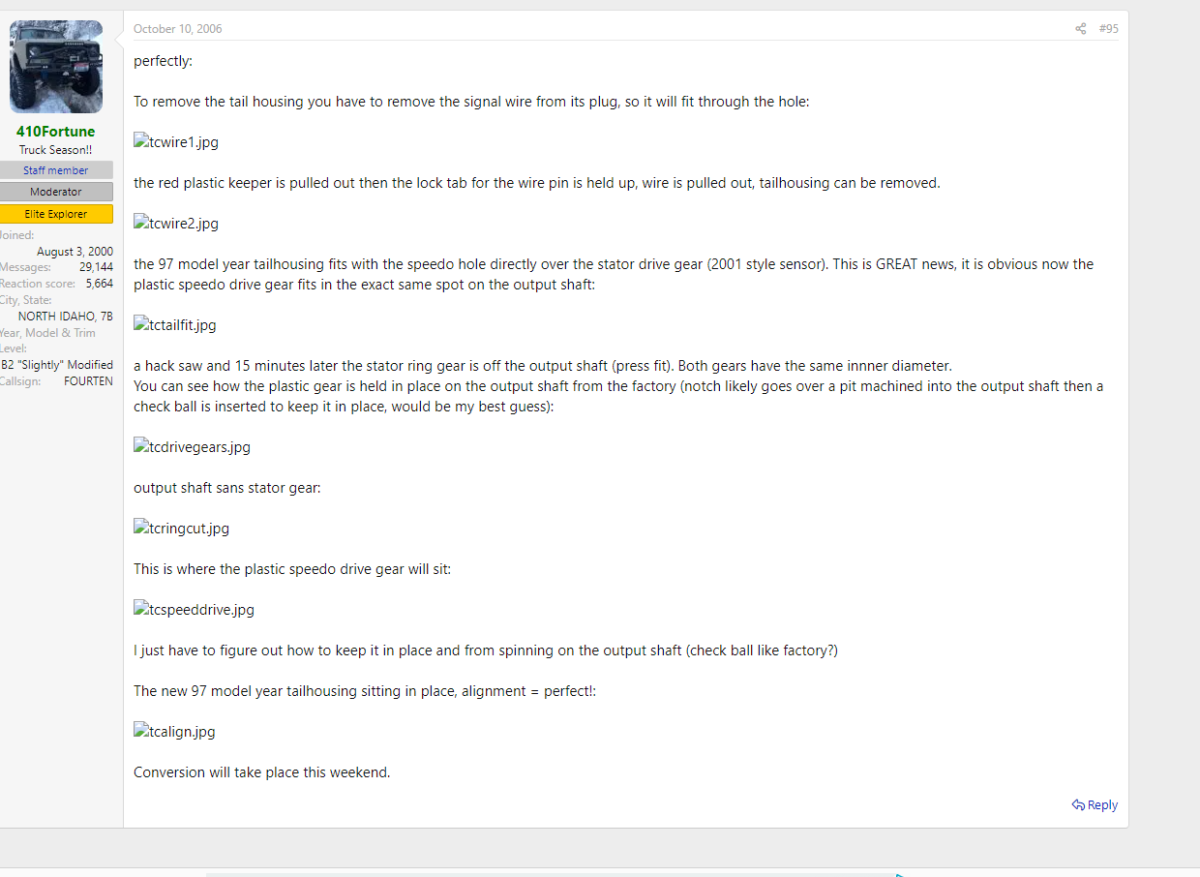

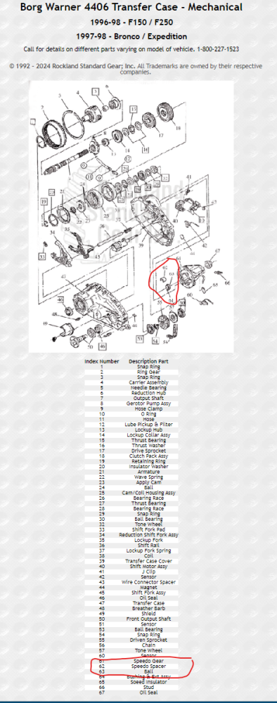

After checking out exploded views of both transfer cases, I believe the 1356 and 4406 share the same design when it comes to retaining the worm gear to the shaft (I would make sure to get the correct 4406 parts though). Looking back into my files I did find this thread from 2006 (attached). @410Fortune seemed to figure it out. However, due to the post being so old the pics were unavailable. I also remember another thread I had dug up where the author was successful at "machining" the 4406 output shaft with a dremel tool to accept the retaining ball for the speedo conversion. With you being a machinist I will follow closely to how you solve this one. From what I can tell it can be done. Just need to make sure you have the right tailhousing.

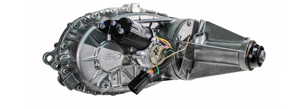

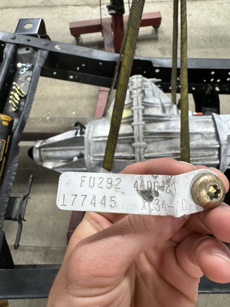

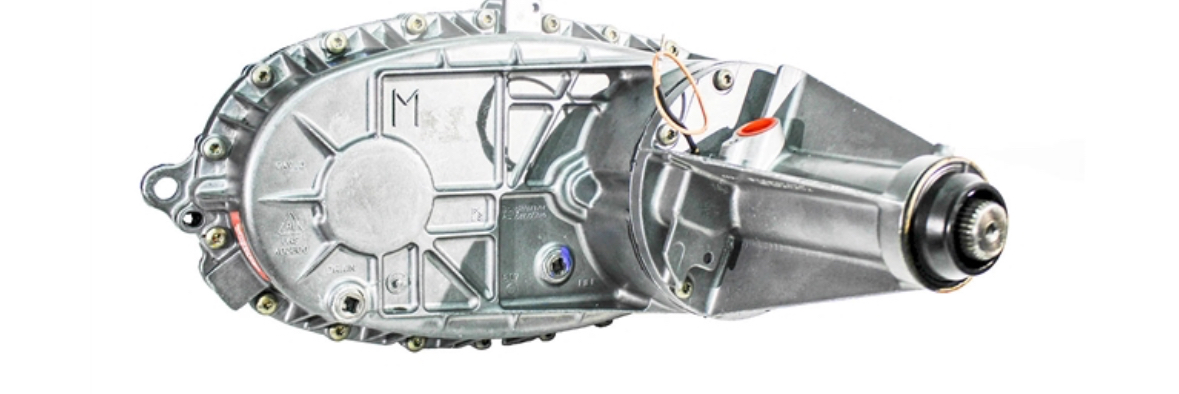

From what vehicle did you source your 4406? Does it still have the ID tag? My electronic shift 4406 came from a '99 F150 which I believe had the speed sensor located in rear differential. My tailhousing has the speedometer hole and mounting boss but the hole has an aluminum cap and the boss would need to be drilled and tapped for the speedometer sensor mounting bolt. No biggie. Im looking at going with a manual box but parts are tough to find out here in Hawaii. I located a manual 4406 in a 2003 F150 but it appears to have a speed sensor in the tailhousing. If I picked it up I probably could put together something that works between the two (manual box with speedo).
Thats the same case (4406-21 XL34-AC) that I was thinking of grabbing from the local junker. Manual w/o TOD and speed sensor hole. Hoping this goes smooth for you!

Nice job! So the retainer and ball are same p/n's for both the 1356 and 4406? Did you just source them from your 1356?

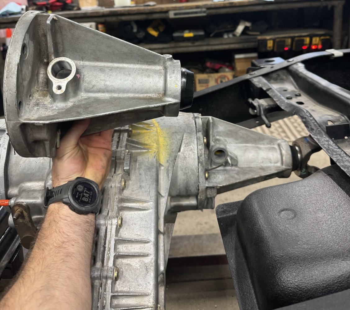

2) What is the difference between the speedo tail housing and the one originally on the case? Is modifying the electric case tail housing at all possible to accept the speedo?

The wires are part of the electric shift assembly if yours is equipped w that. It would have been bundled into the motor harness. I snipped the plug to get the housing off
As for your second question… angle, location and diameter of Speedo hole

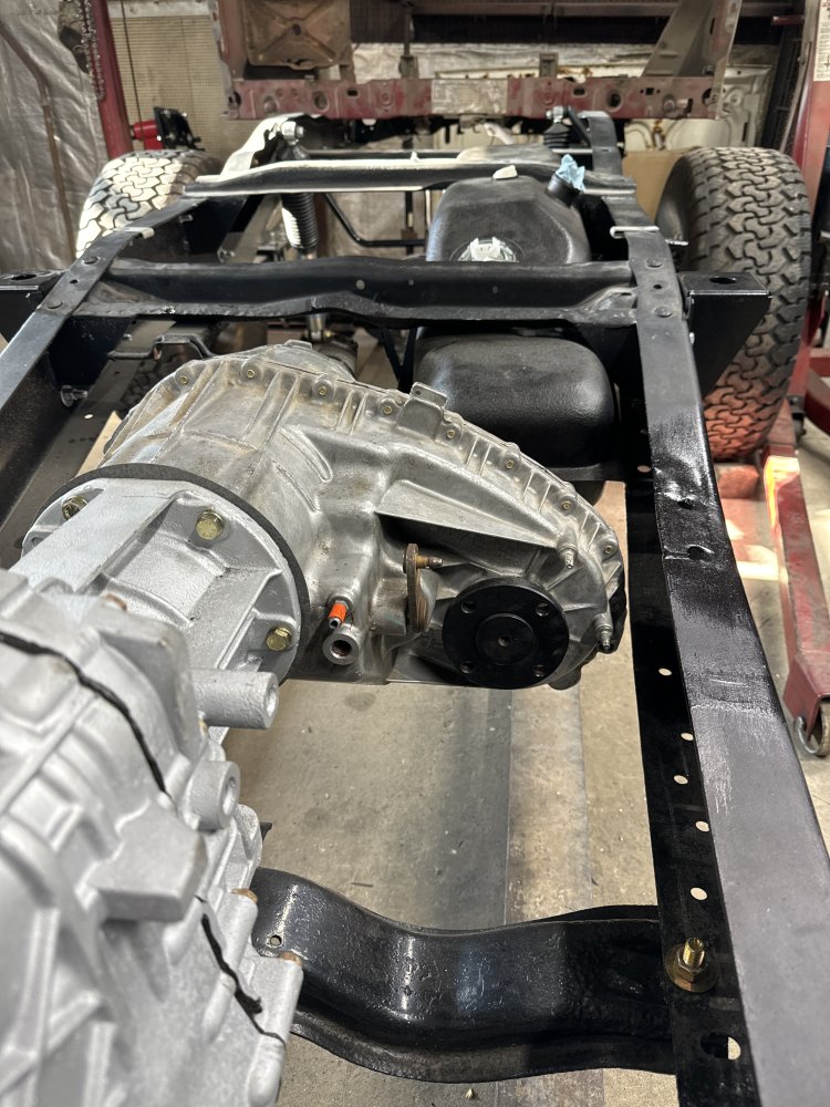

Welded the piece back in that I cut out initially for the BW1356 - considering using the 2 holes on the frame and studs on the Tcase to make a drop bracket to support the added weight of BW4406 being that the ZF5 tail is aluminum. Much more comfortable with front driveshaft angle now as well
