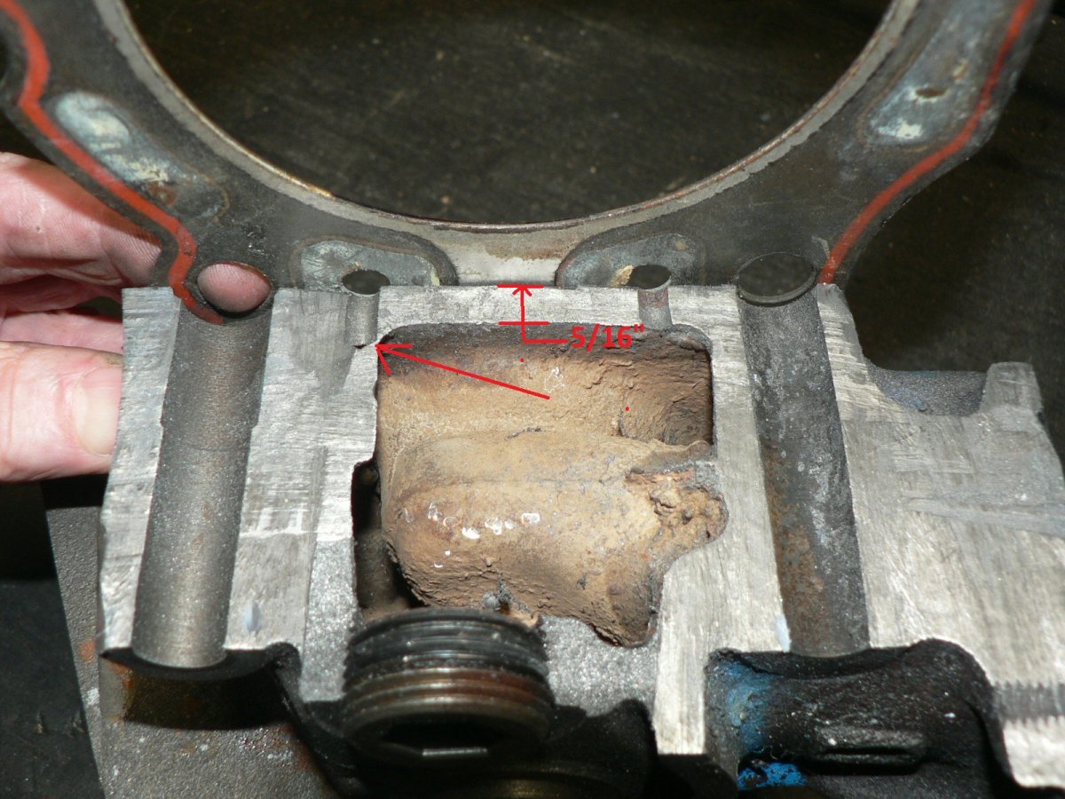

I cut a bad head into to see what the water passages looked like and at what depth one has to drill. Head bolt goes where my finger is on gasket. note the hole on the left (Red Arrow) is only partially thru due to casting. I think I used a 1/4" drill bit. Have fun.
I cut a bad head into to see what the water passages looked like and at what depth one has to drill. Head bolt goes where my finger is on gasket. note the hole on the left (Red Arrow) is only partially thru due to casting. I think I used a 1/4" drill bit. Have fun.View attachment 52260
@Jim Oaks
This should be added to the 2.8 page in my opinion. Great picture.
