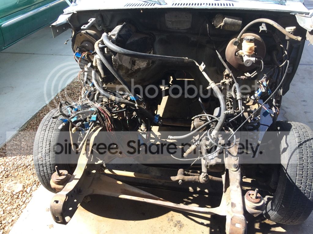

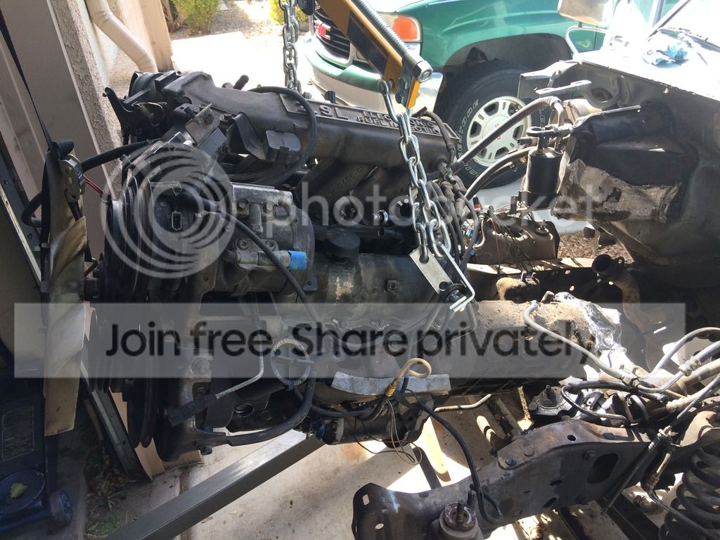

Saturday afternoon I got the motor and trans pulled in about 4 hours. This was my first time using a slip yoke drive shaft so I learned the hard way that tranny fluid comes out that opening. Conveniently enough, my housemate was using the oil drip pan to change the oil on his motorcycle so I had to use a cooking bowl to catch all the fluid that came pouring out. All the bolts were much easier to take off this time round as I didn't torque everything down to spec. I had to drop one side of the trans crossmember in order to get the tail low enough to get the oil filter and starter to clear the motor mounts on the way out. Now I have a rolling chassis and that makes me happy. Motor and trans will be in the classifieds once I can find the model # stamp on the trans. If you are interested in those, or really any part from the truck, feel free to message me directly.

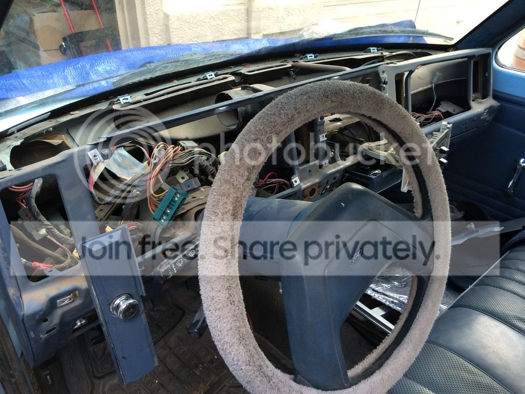

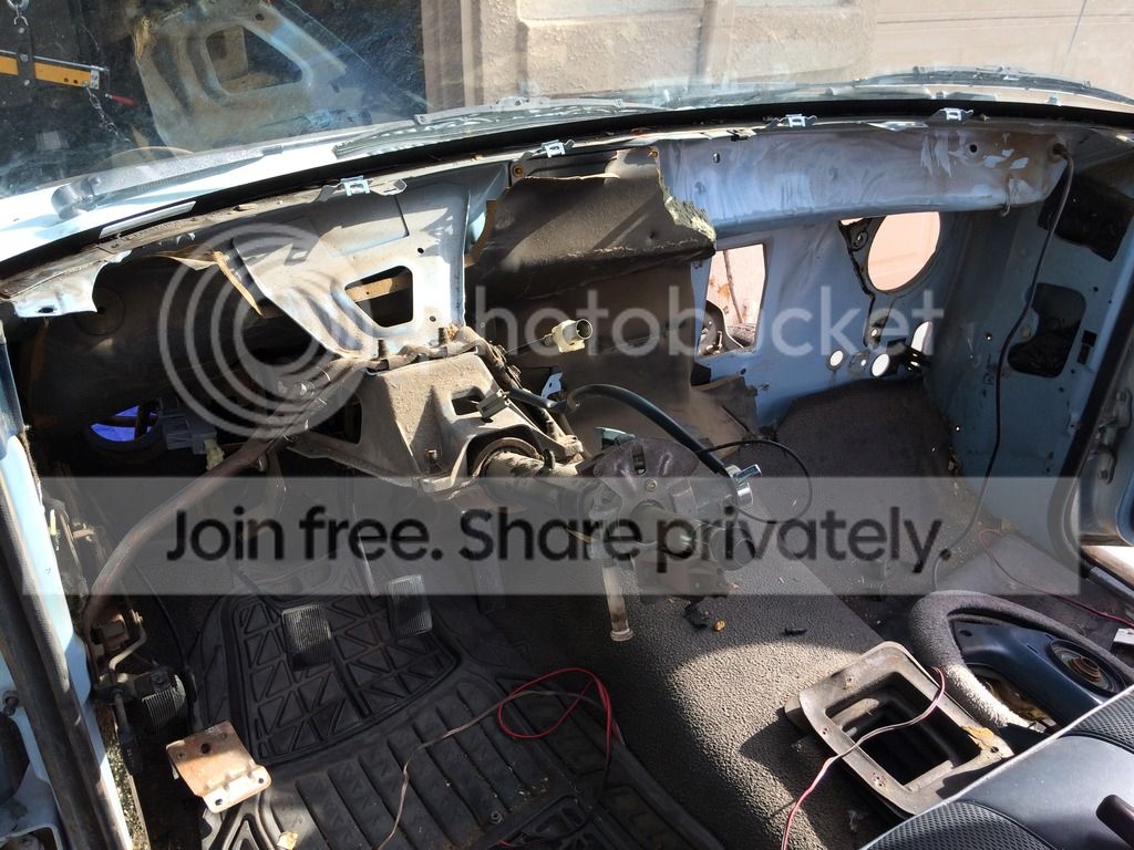

Wednesday I started getting the dash taken apart. Got the outer plastic off and the instrument cluster out and called it a day. The first pic is my progress at the end of that day. The two dash mounted speakers were a pain in the ass and they had to be removed in order to pull the plastic part of the dash. They are held in with 3 screws each and one is so close to the windshield that I had to use a phillips bit and a 1/4 wrench to turn it in order to remove the screw. Of course I dropped the bit and it conveniently landed *sarcasm* on the far left side on a wire harness that I couldn't see. It took me 20 minutes wiggling around the plastic part of the dash to get eyes on it.

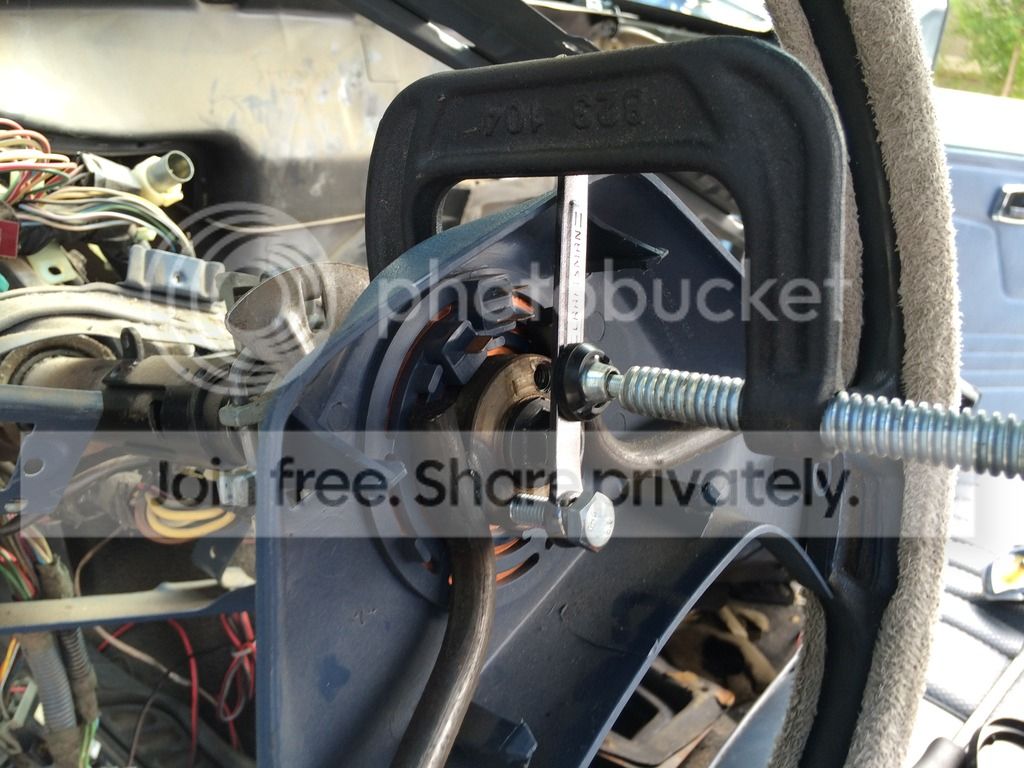

Today I spent two hours this afternoon finishing up the dash removal. Hardest part was pulling the wheel without a puller so I jury rigged something up with a C clamp and a wrench and got it off. Last two pics are of the contraption and where I left off for the day. Next step is to get the harness removed and pull all the HVAC crap.

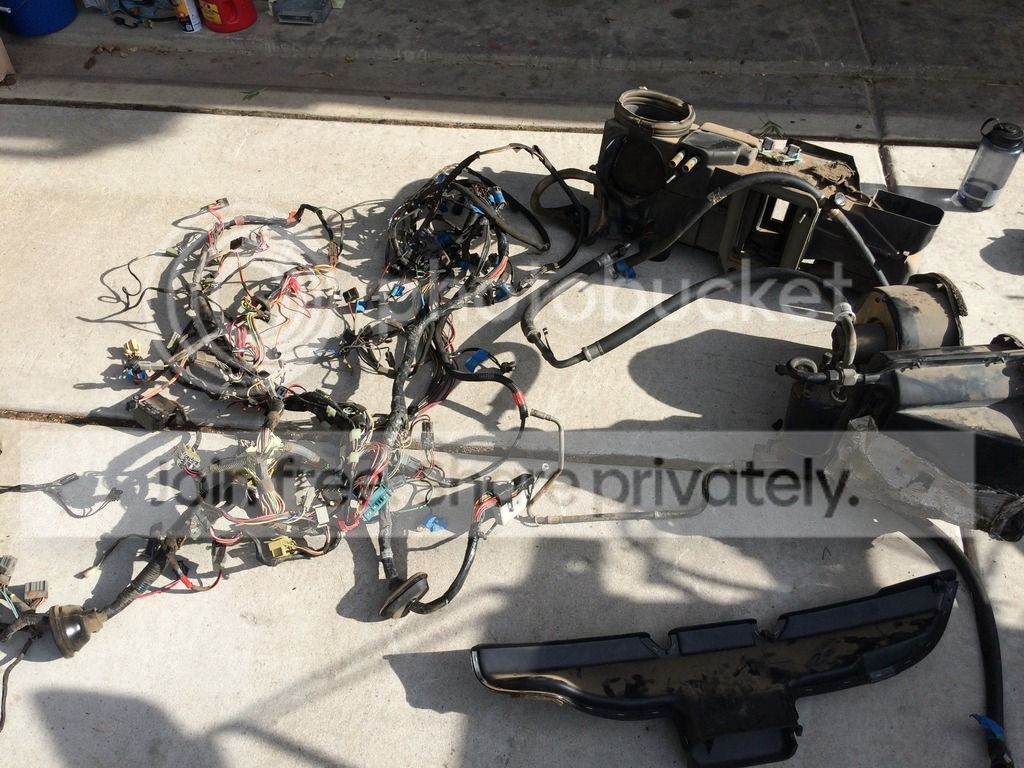

Spent about another 2 hours on it today finishing taking out the dash, HVAC and harness. All electrical is off the car except the one part of the harness that runs back to the fuel pump and tail lights. All that's left is to take out the insulation, floor and seat. Pedals and steering column will stay installed for when I move around the end of the year. The one connection that connects to the O2 sensor on the midpipe was fused together from the heat so I ended up just removing the sensor with the harness.

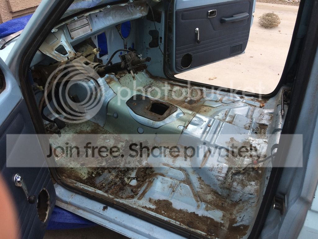

Finished up pulling 98% of the interior today. Really just had insulation, floor and seat to pull. All that's left is the steering column, the two seat belts, and whatever the membrane is between the floor pan and flooring. Door trim is going to stay put for now unless someone wants to buy it. I tried going at the membrane but that stuff is caked on there pretty well so I'm going to invest in a decent scraper and go at it another time. Hoping to get an 8.8 from pull and pay on Sunday with a pull-a-thon they have going on.
looking forward to your progress as ill be doing a 5.7l lm7 t56 swap myself. What was your reasoning to remove the front clip?

Just easier to access everything. Totally worth it in my opinion. If I had a lift then maybe it'd be a different story

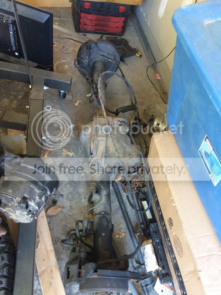

Woo Woo! Got my 8.8 today from the Pull-a-Thon. Cost me a total of $74 between admission and the out the door cost +tax. Brought my housemate along as he also needed a couple parts to put the steering column of his truck back together...someone attempted to steal it about 2 months ago but failed to defeat the anti theft. Anyway, we spent about a half hour getting his parts then headed over the the ford truck section. Yesterday I went and scouted out what they had and where the trucks were that had what I wanted. I'll tell you....I scraped off quite a few tags yesterday checking the gear ratio. Finally decided on a 98 Explorer with a limited slip 3.73. It was in good condition, still had the brakes on it, and the rotors still have some life in them. I started by disconnecting (cutting) the ebrake cable and brake line going to the axle. My buddy started working on the u-bolts with some PB Blaster and a crescent wrench. NOTE- BRING A DEEP SOCKET 19MM. The crescent didn't have enough room to work so we asked the guy working on the interior of the truck if he had a deep 19mm. HE DID! Saved our butts. My 200pc Craftsman set only goes up to 18. Anyway, got everything disconnected, removed the bump stops and was able to pull the driver side between the frame and leaf springs. The other side however....pain in the butt. The passenger side was supported by some tires under the leaf and not the frame like the driver side. This was loading the springs and made the gap small enough that we couldn't slide the brake assembly through. Ended up having to stack some tires under the bumper and unbolted the rear of the leaf to get a gap big enough to drop it out. I don't know what it is for, but there is a sensor at the top of the diff (ABS maybe?) and we cut the harness a few feet down the line and used that to tie up all the pieces for my buddy and headed over to the line. Lots of people carrying transmissions and interior/exterior pieces with seat belts. Nothing said you couldn't jury rig your own carrying harnesses. I think the best one was a bed liner full of stuff with seat belt handles on either side. We didn't need any of that nonsense. My buddy just picked it up and carried it (we're both capable but he's the stronger of the two so he did it. Earned his free parts). Paid for the parts and pulled the truck around, loaded up, and headed home. It is going to sit on the floor until I'm ready to get it shortened. So for the day, we had fun, I spent $74 and got an 8.8 with disc brakes, a clock spring, blinker assembly, steering column support, a side mirror, a cold bottle of water, and a T-shirt!

Nothing super exciting to report. Yesterday I bought a paint scraper and spent 2 hours pulling that crap up off the floor. I think it is sound deadening but who knows. Folks and girlfriend are in town for the weekend so I won't be getting anything done.
Started taking apart the 8.8 today so I could get it to the shop to get shortened. Got the disc brakes, lines, differential, axle shafts all removed. In the process of doing so, dropped one of the c clips down and it ended up in the oil passage next to the pinion gear. Tried fishing it out but to no avail. I need a 3 jaw pulley anyway to get the pinion flange off so I'll retrieve it then.
Called the driveline shop in town that came up top of a google search to see if they did axle housing shortening and of course, they didn't, but referred me to anther business. FIVE referrals later I finally found a machine and welding shop that does it for $150. Little steep compared to other places I found online, but that's life in a smaller (relative) city I suppose. I'll get it to them once I get the housing taken apart.
Once the housing is shortened, I'll order my axles, c clip elims, and clutch pack along with any other little odds and ends I need to button up the rear. I am going to hold off on moving the shock and spring mounts until I'm ready to set the pinion angle.
