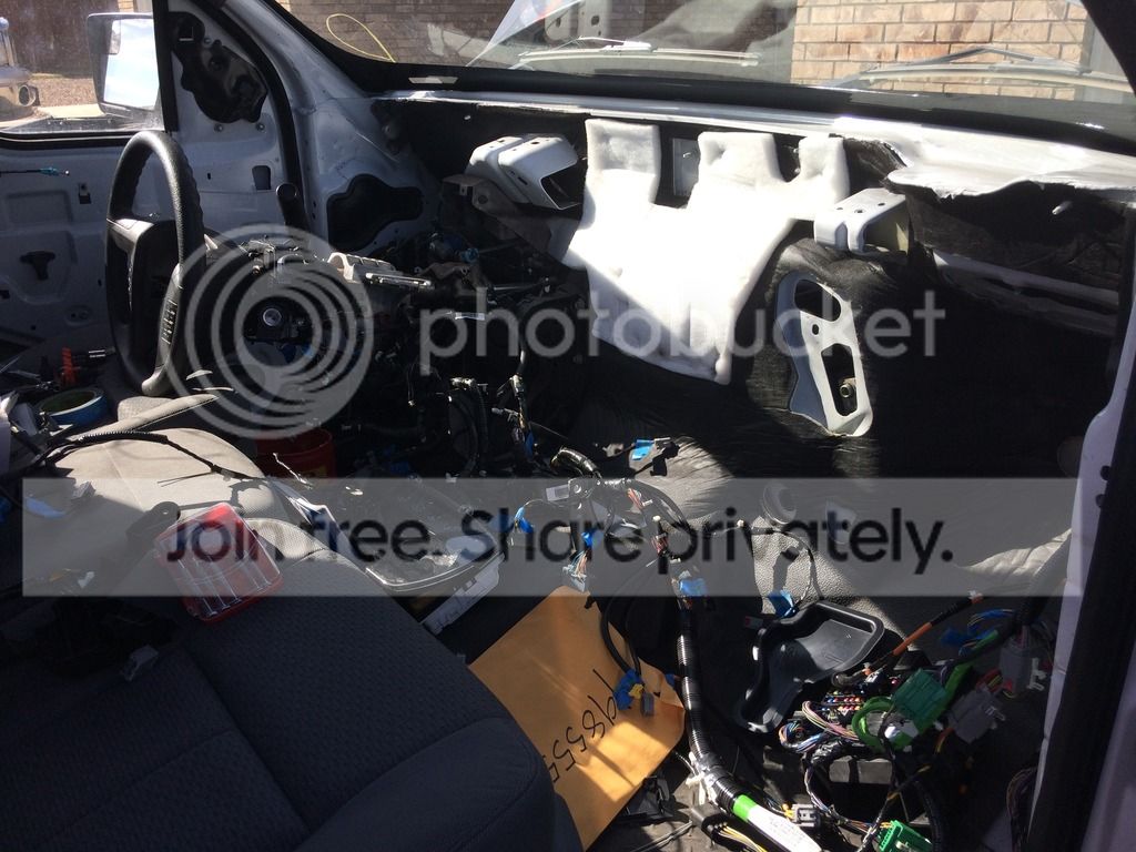

Got all the HVAC out along with the steel structure that supports the dash and everything. I can now easily access all the interior harnesses and have begun my testing for what can be unplugged and not piss off the computer. So far I've learned that undoing the brake reservoir sensor defaults the parking brake light to on, unplugging the headlight switch defaults the lights to on, and unplugging either the TCS button or the abs wheel sensors trip AdvanceTrac service. Also tried unpinning the PATS from the connector on the junction box....disables the ignition.
Interior as I left it today.

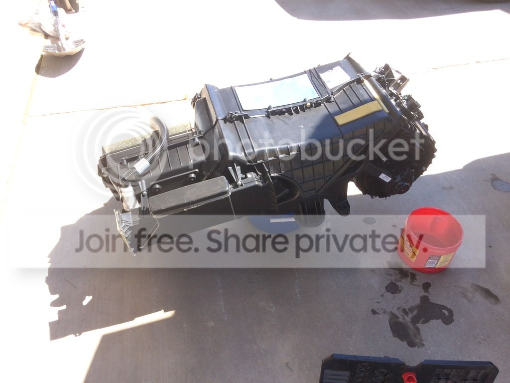

The hvac unit. It was annoying because it has both the AC and heater cores built in and the lines run through the firewall (vice being in the engine bay and just running the conditioned air through the firewall. I have upside down on a bucket to let the residual coolant drain out.

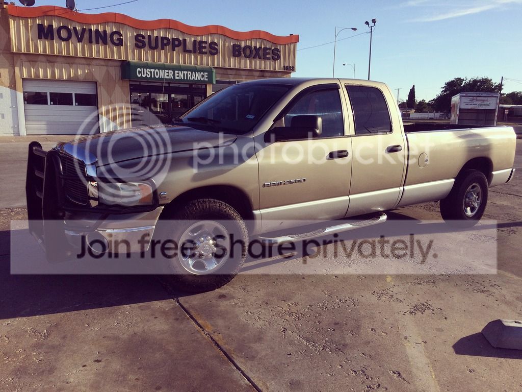

No progress on the truck lately. Been out of town and busy with work. I did however pick up this bad boy yesterday. 03 2500 with the 5.9 Cummins and a 6 speed. Wanted something bigger with 4 doors so I can actually take people and crap places unlike my single cab Ranger. And once this project is done, I'll need something to tow it to the track with!

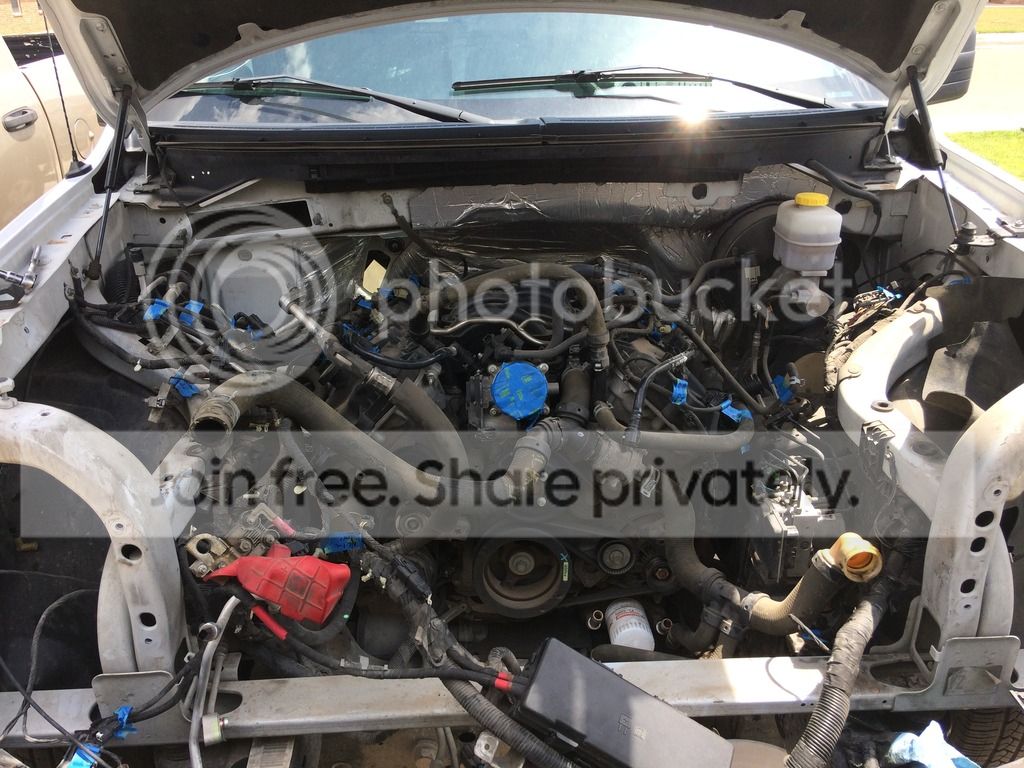

Turned out the new truck had a leaky water pump and power steering pump. Don't know how because I specifically crawled under the damn thing looking for exactly that. Anyway, both are fixed now but that took away time from the swap. I spent about an hour starting to unplug the harnesses from the engine bay and labeling everything. I'll need another hour or two of unplugging and labeling and a couple hours disconnecting cooling system and everything on the trans and should be good to pull.
Had a morning off from work and got some good progress. All the wiring from the motor is disconnected, radiator and front support is out (all came out as one unit which is nice). Drained the trans and removed the oil cooler. I plan on deleting it but still need to figure out how. I'm assuming there's a pump in the trans to move that fluid up through the cooler so I can't just plug the holes. This trans is also a pain in the ass to drain as you have to take the whole bottom pan off. Anyway, I'll be tapping the pan and adding a drain for the future. Right now I need to disconnect the shift linkage, driveshaft, cross member, exhaust, fuel line and motor mounts and it should be good to pull. Hoping to have it pulled this weekend unless something comes up.

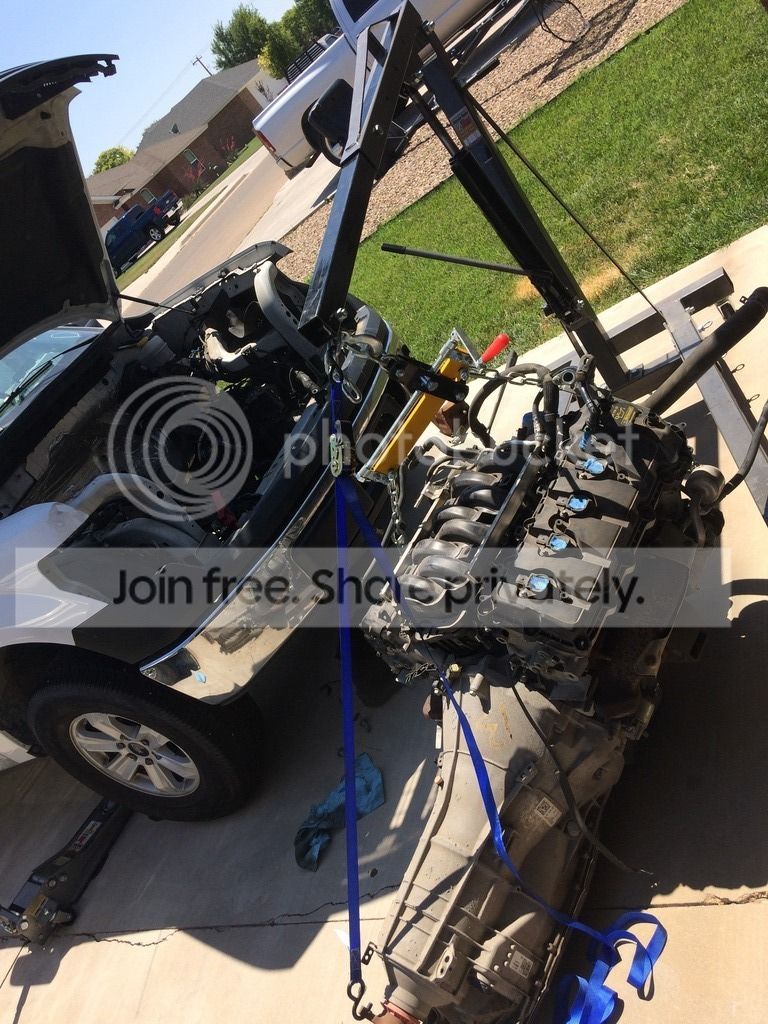

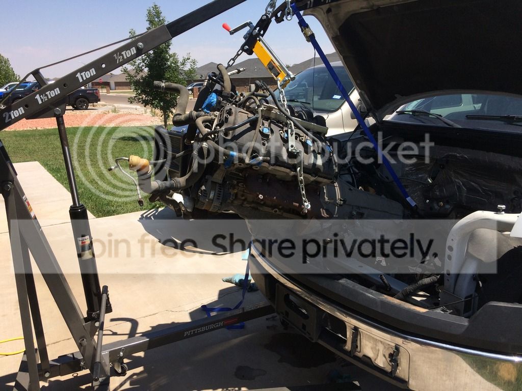

Whoop got the motor and trans pulled today! Biggest pain was doing it myself. Took an hour to get it out with constantly having to move between the hoist and the jack under the trans. Second biggest pain was the motor mounts. Pax side was a breeze. 2 bolts from underneath with the impact and done in seconds. Driver's side is a different story...3 bolts from the top. It has one of those stupid plates underneath with the nuts welded on. Can only access 1 of the 3 bolts without taking the exhaust off. I decided to pull the 3 bolts that connect the mount to the block and lift it enough to get access to the bolts on top. Sorry I don't have any pictures of that.

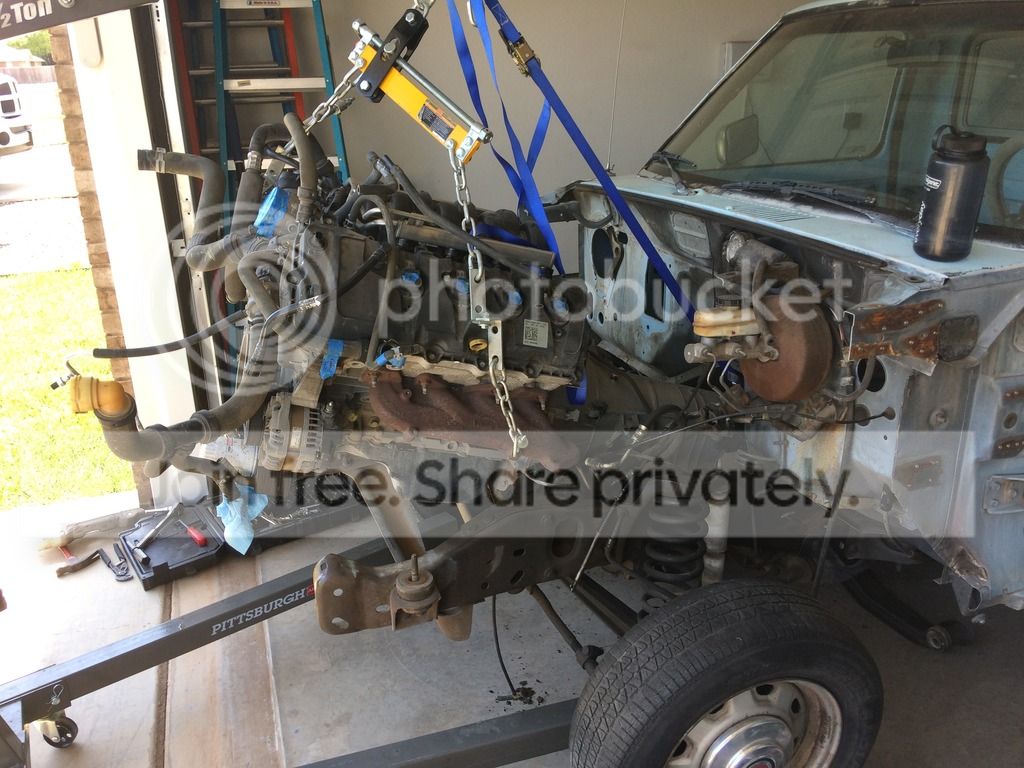

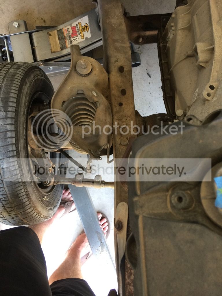

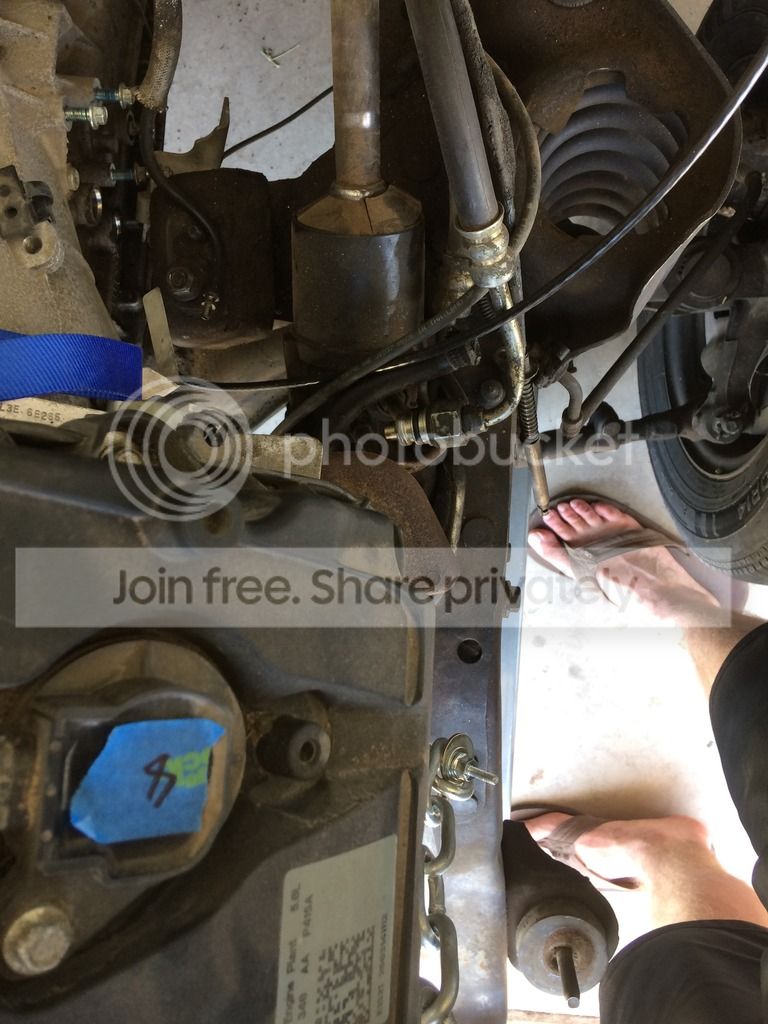

Tried test fitting the motor and the pic shows as far in as I could get it. The old steering box gets in the way....along with the headers being wider than the frame rail. Can't wait to do some fab work to fix that problem! Made a list on some cardboard to keep track of everything I need to do, Roadkill style. I'm sure there's plenty more little things I forgot. My buddy also gave me crap for working in flip flops and accused me of being Freiburger. I prefer just hosing off my feet than having my shoes soaked in coolant and oil. And I get a wicked flip flop tan too! Up next is going to be modifying the frame and crossmembers to get this stuff to fit!

I think we all know how roadkill would handle the header clearance. Got a sledge? Lol
I wish it were that easy. No way I could pound in these stock cast headers
Turn em up-side down? :icon_hornsup:
