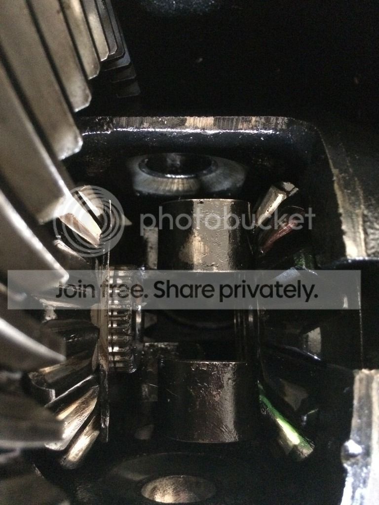

any reason for the c-clip eliminator?
Z
Some tracks require them if you are so fast on a C-Clip axle.
Otherwise if a shaft brakes you screw up the track and lose control.

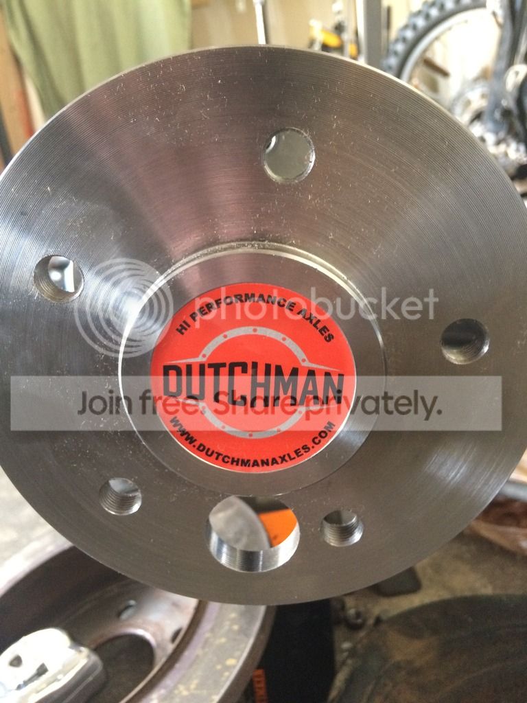

Got back from a week at home for the holidays last night and figured I'd spend today finishing up the axle before I move next month. Turns out the side that was shortened was shortened a bit more than the shop told me....the axle shaft came out too long and hits the pinion shaft. Gonna have to send it back to get shortened and resplined.
Parking brake does not work with the ARP wheel studs. The elim kit retains it with lower profile hex heads where as ARP has the taller 12 spline heads or whatever you call them. Decided to take out the parking brake.
Lucky me, Dutchman makes the splines extra long so I took it to the machine shop and they lathed 1/2" off the end and it fits exactly as it should now. Happy happy happy. Just in time to move.

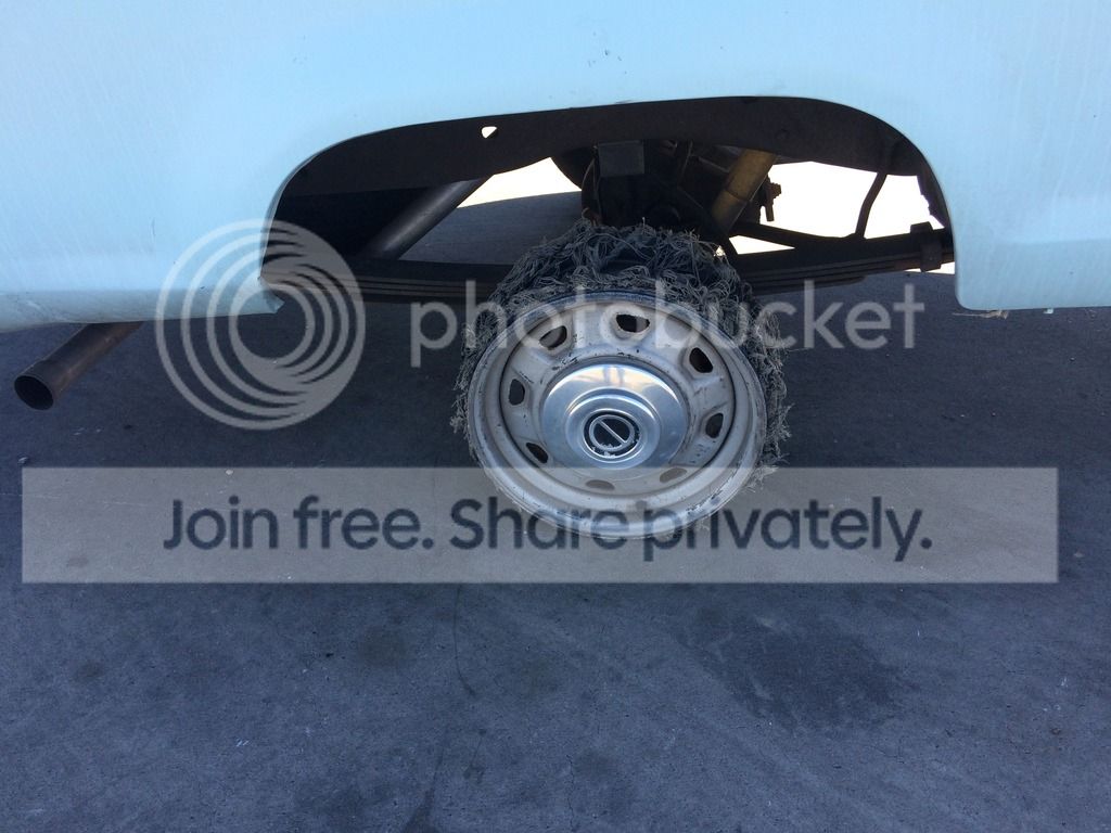

This is a pic 20 miles from my new place. I stopped to pee and out of habit did a walk around to make sure everything was good. I had no idea I had blown it and it was 100 miles from my previous stop. The rim is trashed now but I'm sure I'll find use for it around the garage. Luckily I had a spare and aired it up at the gas station and swapped it out. The tires seem to be pretty old and I was doing 65-70 so I'm really not surprised it blew.

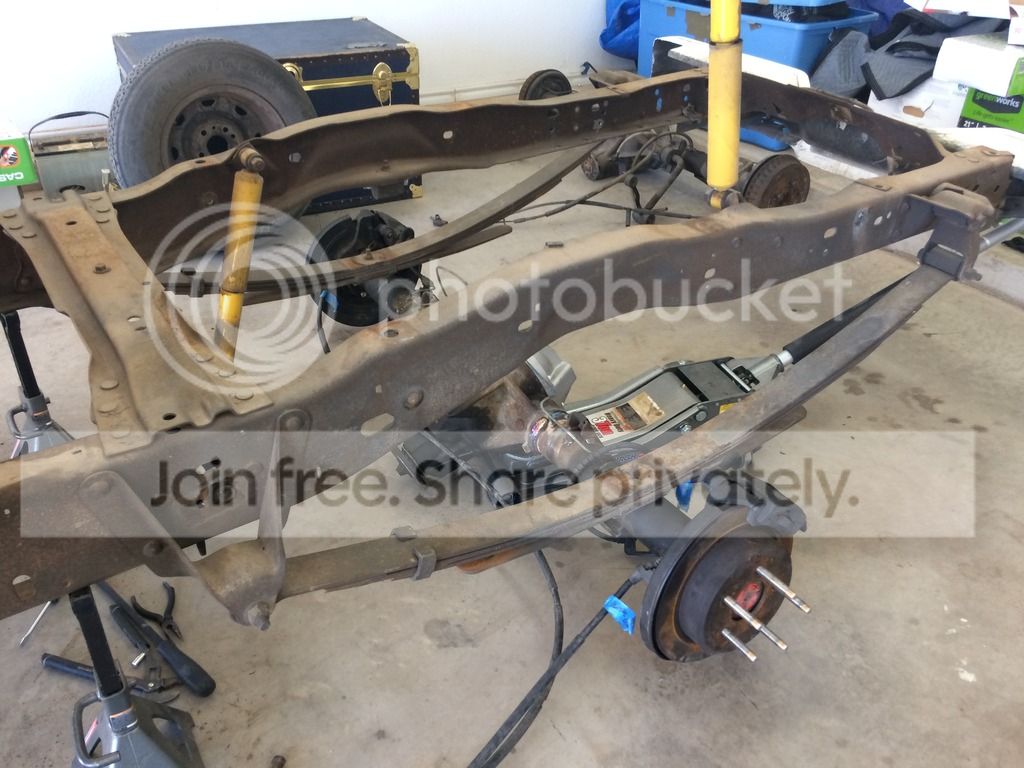

Here's how she sits as of last weekend. Removed the bed, exhaust, and rear axle and mocked up the 8.8. Need to transfer the shock mounts and spring perches over from the old axle as these are different designs and sizes. Next weekend I'm hoping to have some exciting news for you guys as to where the project is heading.

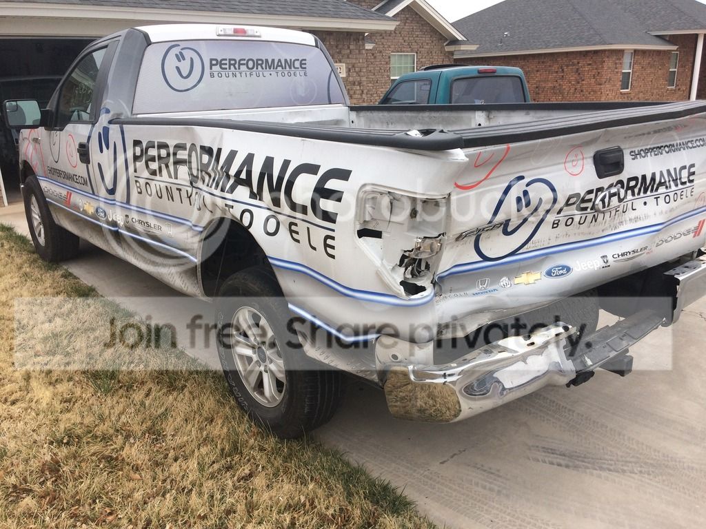

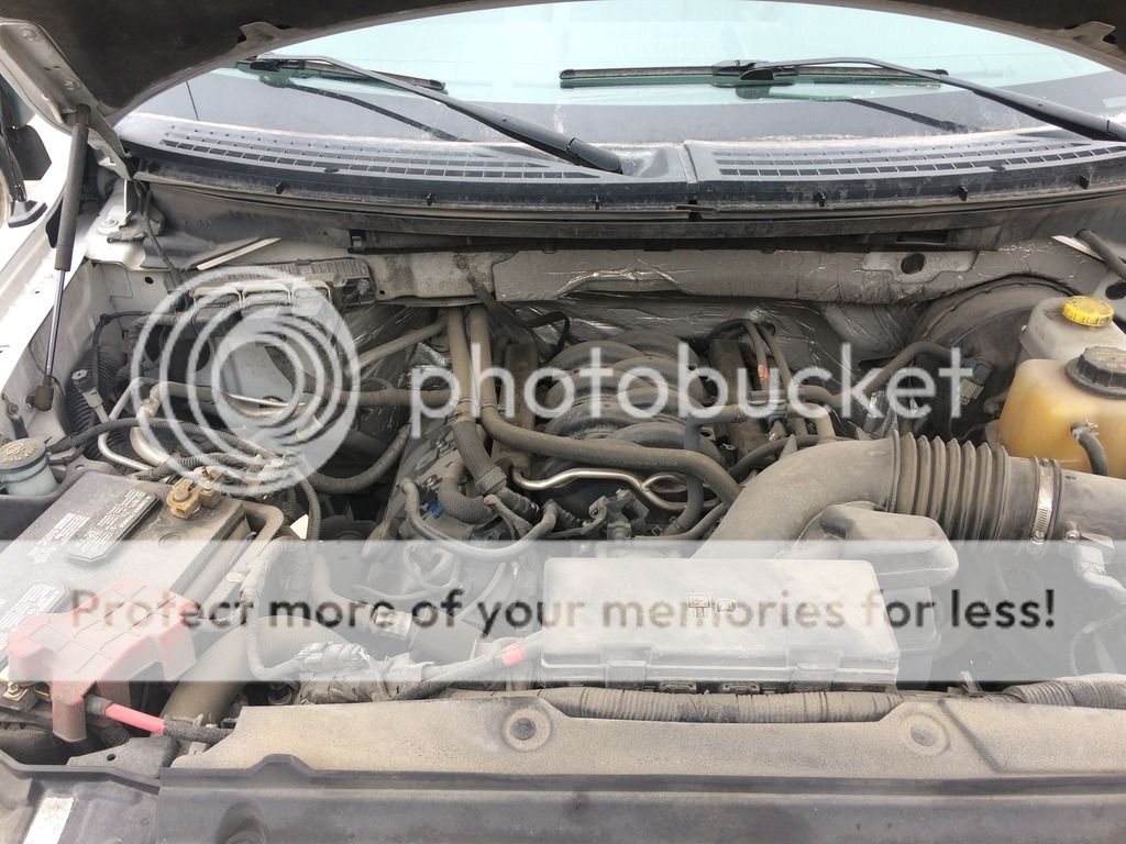

I'm excited to finally announce the plans for the build since I now have the parts. Last night I took delivery of a 2014 F150 with a coyote and 6R80. Copart find and it is a run and drive with 100k miles so everything is mechanically sound. The ranger will be getting a drive train swap along with the instrument cluster. Everything else will be parted out to recoup some of the cost. First step is to find out what I can unplug without pissing off the computer and putting it into safe mode. I will post the findings of that as I get them. Future plans for the build are to first get it working N/A. After that at some point I would like to turbo it and shoot for ~600hp on a safe turbo tune with stock internals. After that it will be money and time driven. I may as an in between step cave in and slap some happy gas on it. We'll see. But like I said, first step is to just get it running. Why was it totaled? I don't know but my guess is bent frame.

So how much is a totaled 2014 f150 worth? From an auction?
This one sold for 4.7k because it is in relatively good shape. I watched a run and drive one that had the front smashed in go for 3.2k a couple weeks ago. That is before the copart fees.....

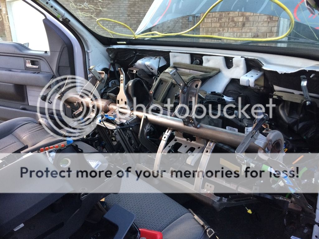

Progress for today. Ripped apart the dash so I can easily access all the harness connectors and start doing my testing. Let me tell you- These trucks are built way better than they used to be. The Ranger was cake to take apart. This...pain in the ass. I did my due diligence and tried to take off everything without breaking stuff so I could resell it. I eventually got to the main dash piece and it is screwed in to not only the steel dash structure, but also the duct work for the defrost. And of course this is stuff you can't access unless you pull the entire metal framework out. I eventually caved in and just took the dremel to it. I doubt anyone will want the full big dash plastic anyway.... Here's how it sits when I called it a day. I'm at the point where I need to discharge the AC lines to disconnect them from the box in the cab. The local Sears Auto Center said they'd do it for free so I'll be making a trip sometime this week to get that done.
