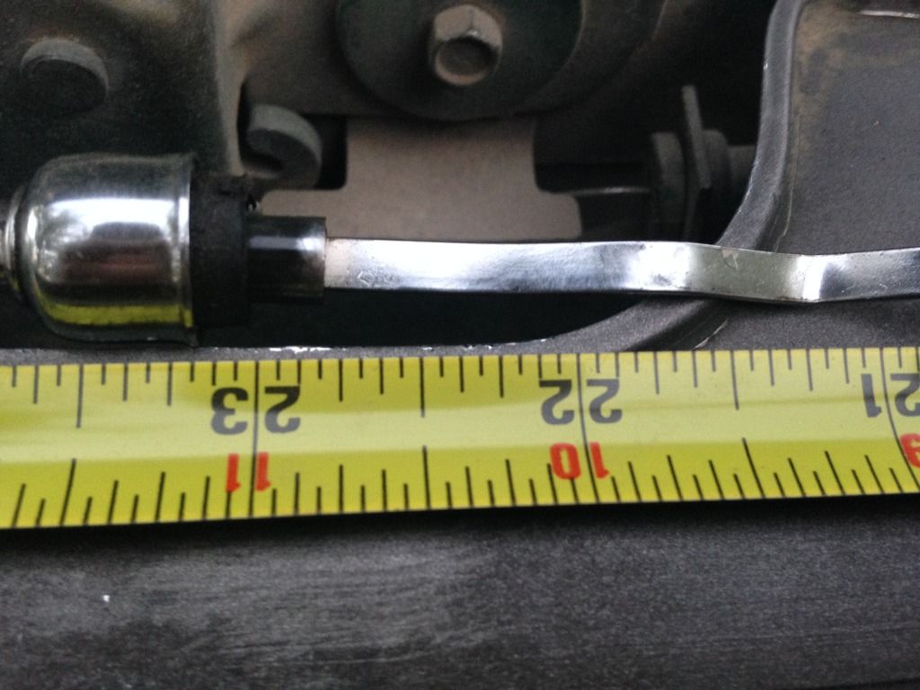

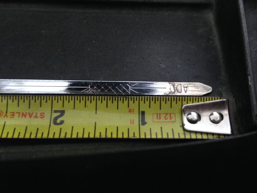

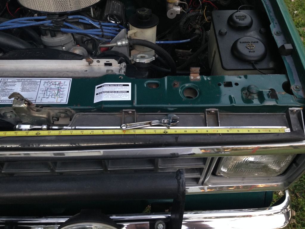

Sorry for the delay, been doing a big overhaul of my garage and I keep forgetting to measure.
The dipstick is pretty much flush with the tape, the end of the tape measure pushes it up and makes it look like they are not lined up.
