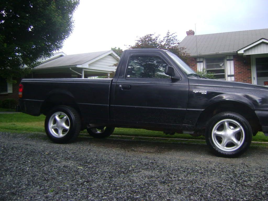

I scored these 1994 mustang wheels mounted with next to virgin 225/60/16. Tires still had the little fingers on them too. Stolen for 250 bucks!

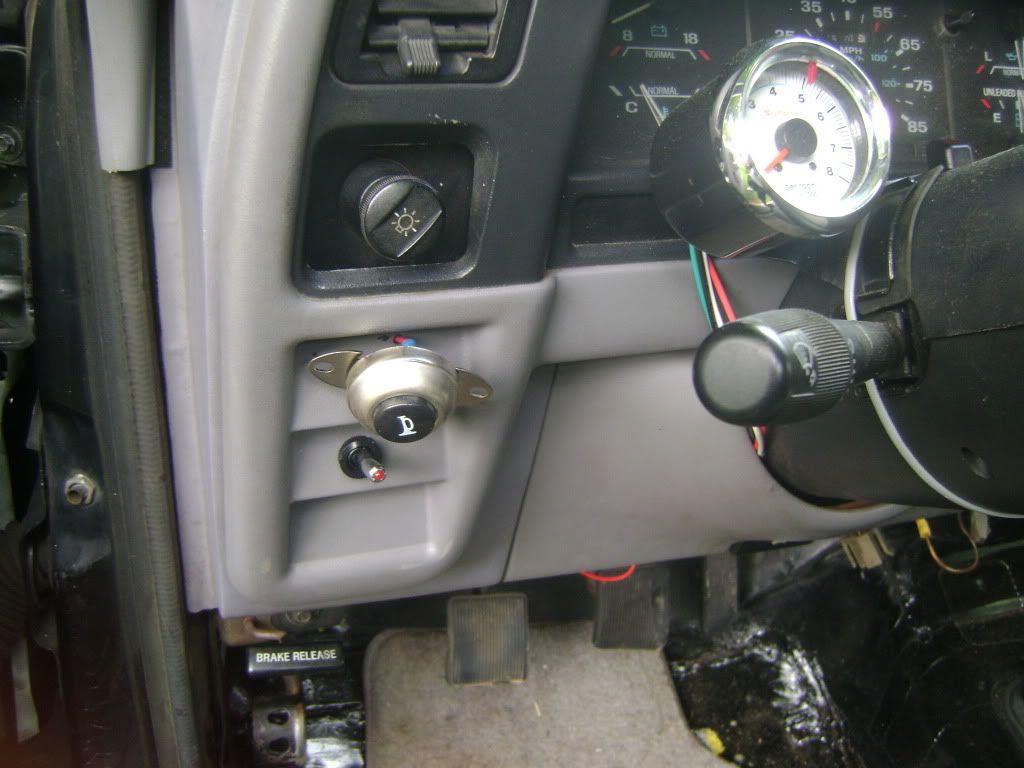

There you can see where I mounted the steel LED switch for the driving lights. The horn button is functional but not screwed in yet as I want adjust some things with the wiring yet. I'm looking for the loudest electric horn you can buy if anyone knows of any. I'm not that impressed with the Wolo I got!
