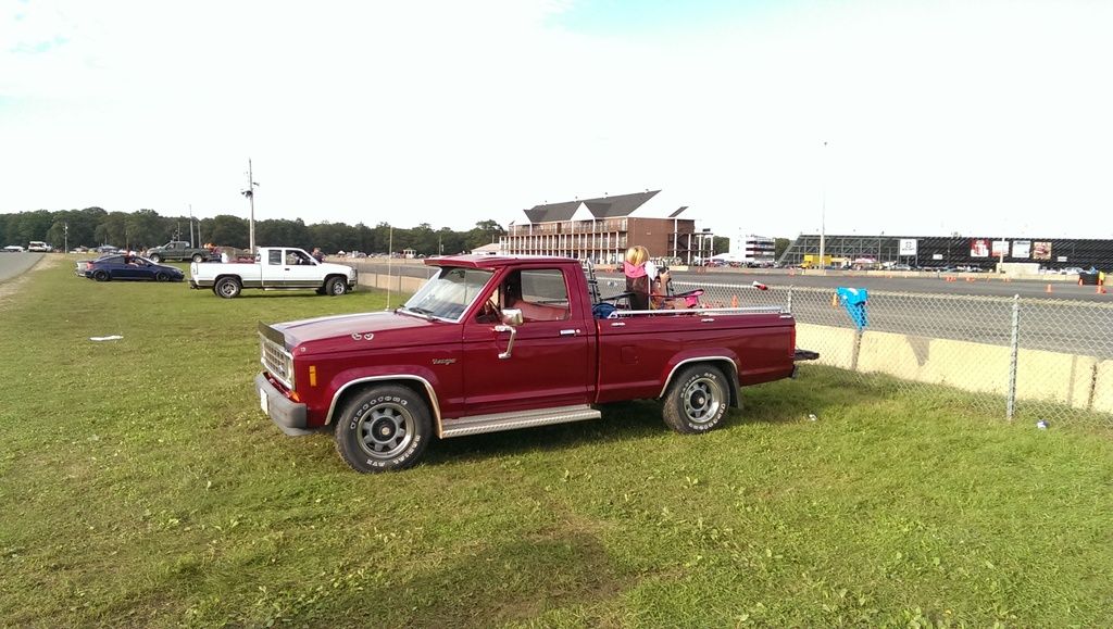

Last September my fiance surprised me by getting me a ranger for my Birthday (shes the best). It is an 84 super clean 2x4 I had been eyeing for a while. 2.0 four speed.

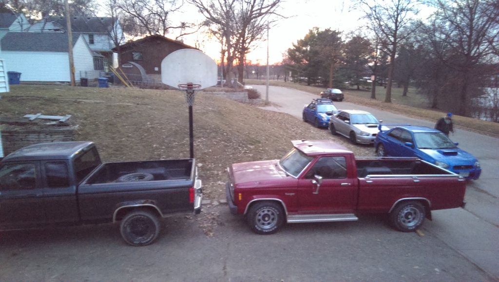

A couple weeks ago I picked up an 87 4x4 in decent shape. The idea is that I would use it to replace my Subaru Forester as a daily. It has a 2.9 5 speed. It is pretty decent for MN but still worthy of being a beater.

So I picked up an 88 2.3 motor and tranny last fall and started to tear it down before winter. Hoping to dig it out from my storage unit soon for final teardown and get it to the machine shop for a little work. The 84 had a earlier non-feedback carb put on and was stripped of a bunch of important components. I got a new yfa for it a couple weeks ago and am still trying to get it to start consistently. It runs and drive great when it starts but the choke is very hard to get just right. That is all for the drift ranger for now.
As for the 4x4, I pulled it in to clean up the engine bay and strip some components and found it was leaking gas from the secondary fuel pump. I cleaned up the connection and fixed a fuel line clip but in the process broke a return line hardline. Everything is very rusty. So I have a fuel tank, sender, and straps on the way. Also I played around with the carrier bearing alignment because it had a bad vibe issue. We will see if thats fixed soon enough.
