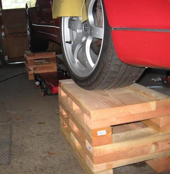

I got most of the car suspended on a collection of cross-wise stacked 6x6x2' drops and I also used a bunch of cut off railroad tie's and even a few cinder blocks and smaller pieces of ply to make sure the car is flat and very well supported. I used the welded on lift spots, the frame and the frame behind the bumper giving me 5 solid support points. I used the frame behind the bumper to lift from with a 22ton house jack. Every time I work on a wheel/arm I built a new little 'tower' to support the knuckles / calipers. There are 2 jacks in use which have been set to just kiss the frame, they're not the main support, just a back-up and they move whereever I work. I have two more jack stands left which don't really reach properly, so I always place somewhere in a 'just in case this suddently drop it ain't gonna drop very far'.
Always do a thorough, thorough shake test. My hardest challenge was finding out where to properly support the car so I could work on the suspension. I'm a weekend mechanic at best, so it took me a while. Make sure that you really chock any wheels that are left on the ground in both directions.

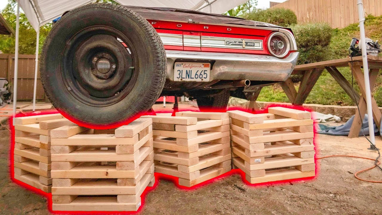

That illustrates my usual method. Of course the front hitch makes it a little easier. At that height, I had room to install the 4" lift and keep the tires off the ground afterward. Unless I used my weight to stretch the springs. Never felt unstable. Too bad it's not that tall all the time. LOL
Doing entire front end, best way to jack up truck?
I'm not sure what you had under the concrete block, but if doing this on grass or even gravel, make sure you have plywood or 2x12 under the block. You want to make sure an edge doesn't start sinking.
Just grass, but I did hunt a bit for a VERY solid patch of ground. I could see how that could be a problem. I wish I had a concrete pad to resolve that problem. I'm hoping to eventually build a garage where that mobile home is now. I'd probably do a pad with a tent style building at first.
Yeah, at the very least one of those solids should have been on the ground or if the block used is a “termite” block (solid top, webbed bottom), put it solid side down. Better to be on 2x12 or plywood though. Even doing it that way it’s still a little risky. I’d love to have a solid slab to work on but that’s likely a couple years down the road.
