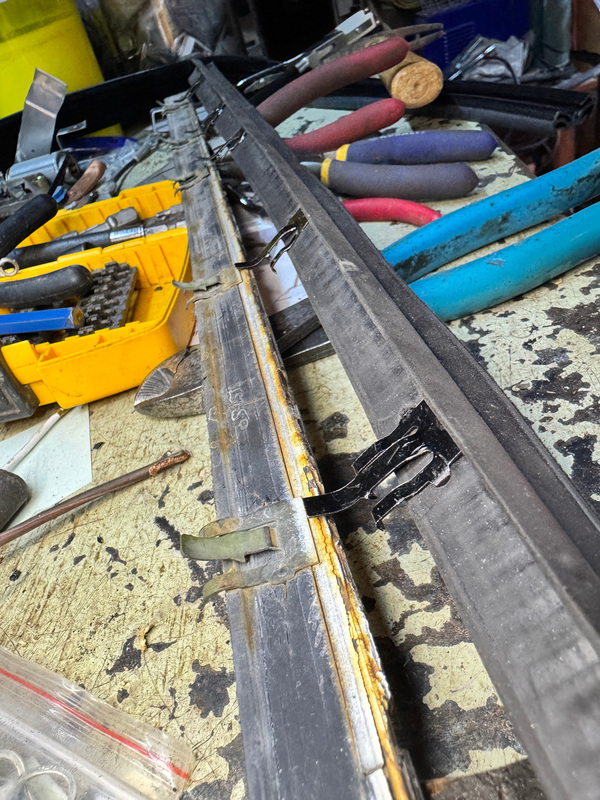

I purchased a universal window sweep kit for my b2.
The clips need to be attached, once you've identified the correct spacing.
Any pointers on how to install them would be very much appreciated.
I am starting to regret my decision to purchase a window sweep universal kit :p

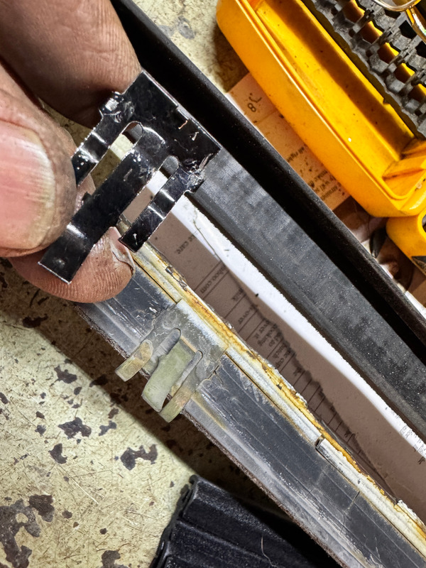

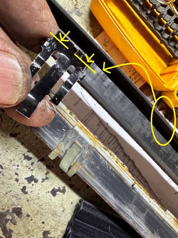

From what I can see in your pic, my take on it is that you push the top of the clip onto the lip that's on the sweep:
Of course, you need to put the clips on the new sweep in the same places that your original sweep has clips. I doubt that they're very forgiving if you try to move and reset one after it's been put on.
