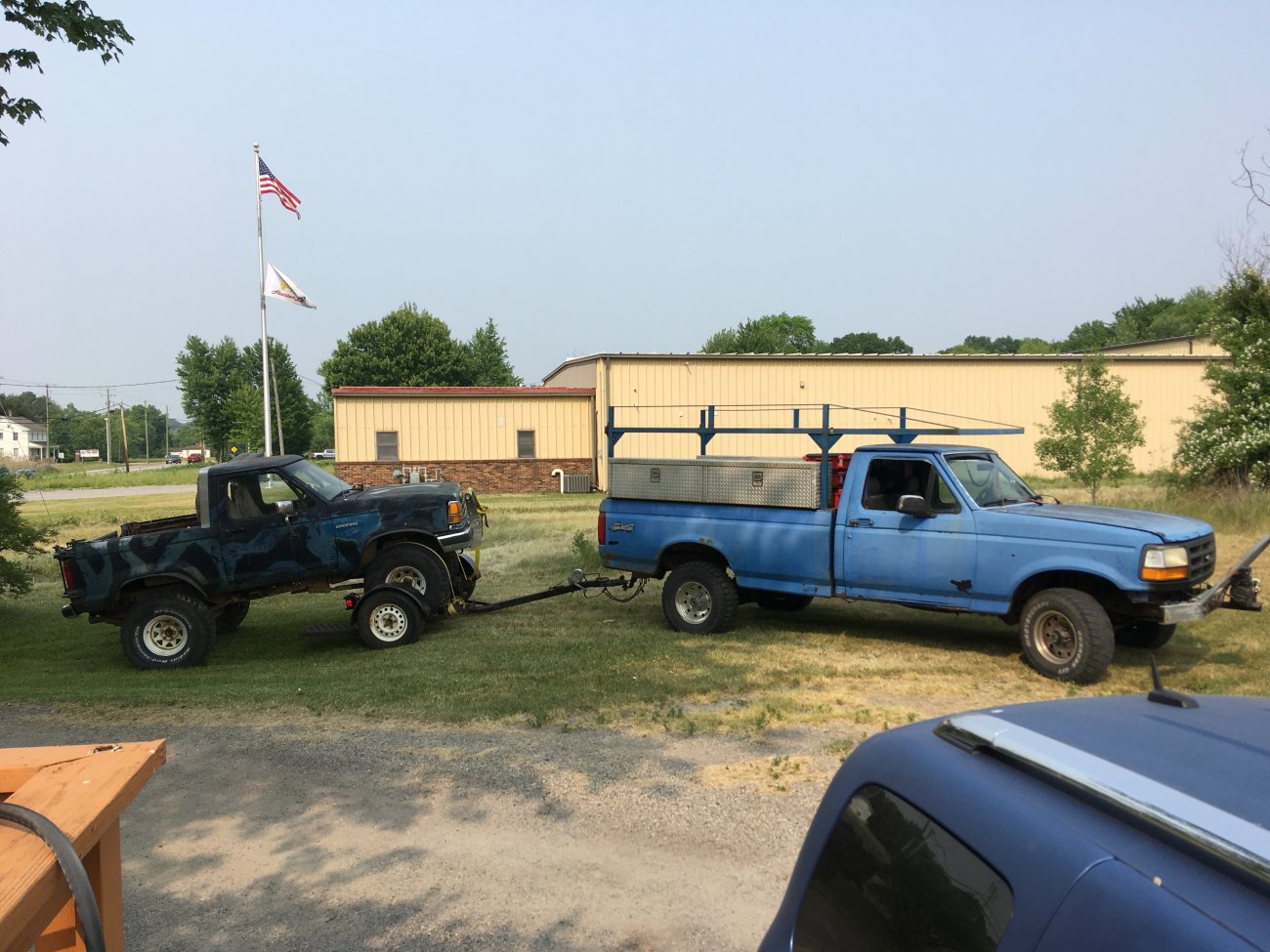

My dad used to haul a 3 horse gooseneck with 3 horses in it all over the place with a 94 F250 (light duty) with a 300 and an auto, 2wd with a 3.55 gear. Itd pull it 65-70 on the freeway with no real issue. It didnt accelerate up ramps and stuff nearly as good as his previous 351W did, but it wasnt bad. From a dead stop it pulled it with hardly any effort....and it had well north of 200k at the time.
I had a 96 F150 with a 300 that i once pulled 10k of skidsteer with. It did it, but it wasnt real happy. That was a 4wd with 3.55's and an auto. However i did tow my 77 LTDII (4100lbs) on a 20ft car trailer (2300lbs IIRC) with it and it motored right on down the road with no issue.
So yes....i think youd be fine unless you were doing alot of mountain running or wanted to tow an excursion on a stupid heavy trailer.
Also...just a note...up untill i think 81 or 2 ford used the 300 (with a few tweaks) in trucks up to the F700 (20k GVWR). So they are capable of more then you would think. Plus they are beyond bulletproof...basically nukeproof.
The thing about the 300 is empty they feel pretty slow...but you hook a load on them and they are basically the same amount of slow.
