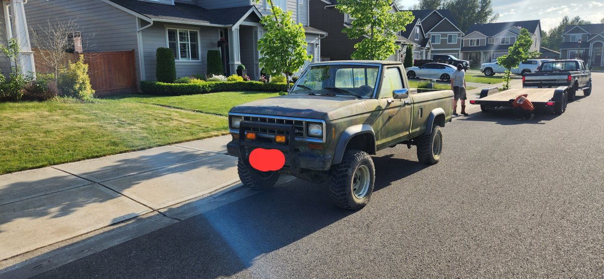

Well I'd like to thank you all for your help! I was able to get it running, and it was able to drive, the brakes need some work, because they're sticking, but regardless thank you all for your help! I'll attach some pictures and videos we took of it
