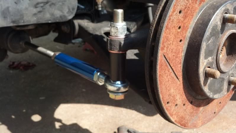

Talked to a buddy who is into Mustangs. He had a Moroso bump steer kit brand new sitting in his garage. Picked it up from him today and installed it.

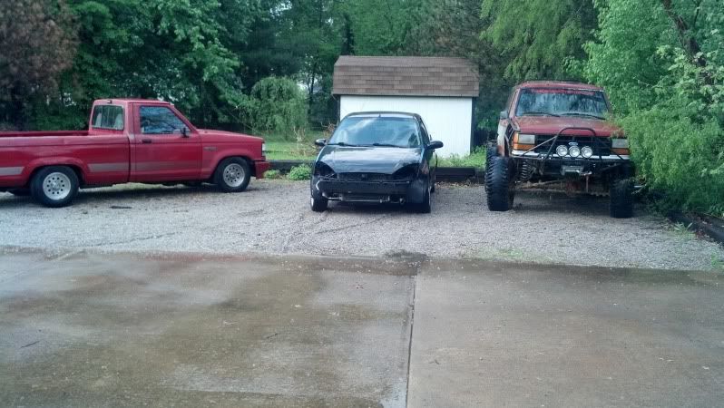

Got her to move. Still needs major toe adjustment.
