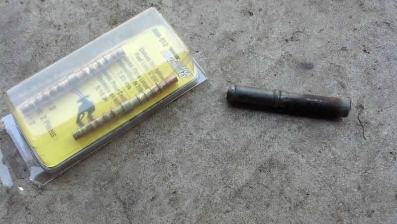

Bought the wrong size couplings. Took a leftover trans line from the B2's auto swap and beat the end to make a lip.

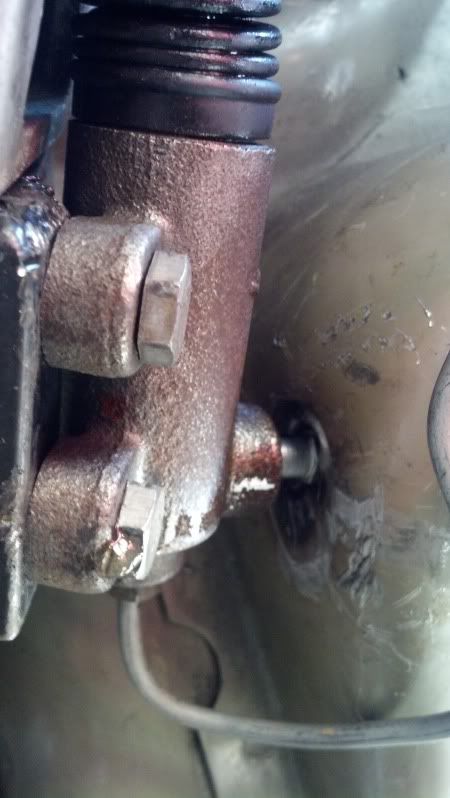

Bleeder wouldn't fit so I punched a hole for it. Although it appears that it is still leaking.

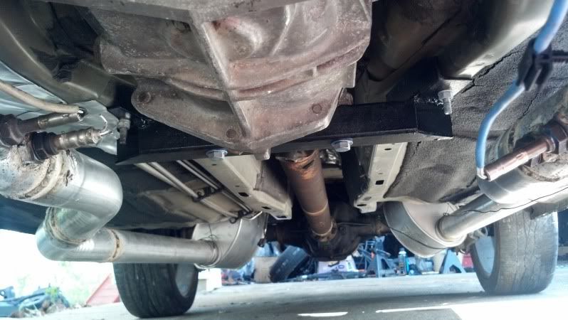

Exhaust is still temporary. But you can see where I had to avoid the fuel lines. And where the driveshaft is rubbing in the middle.
