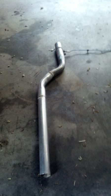

Changed the exhaust a bit so it wasn't running next to the fuel lines.
