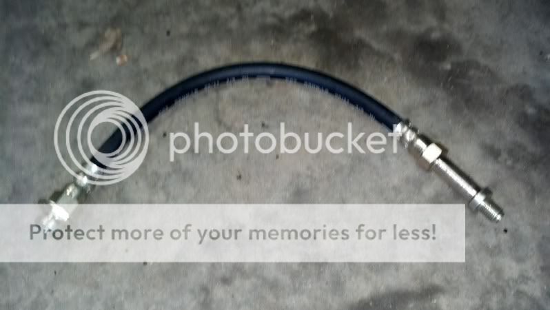

Got the missing piece for my clutch line.

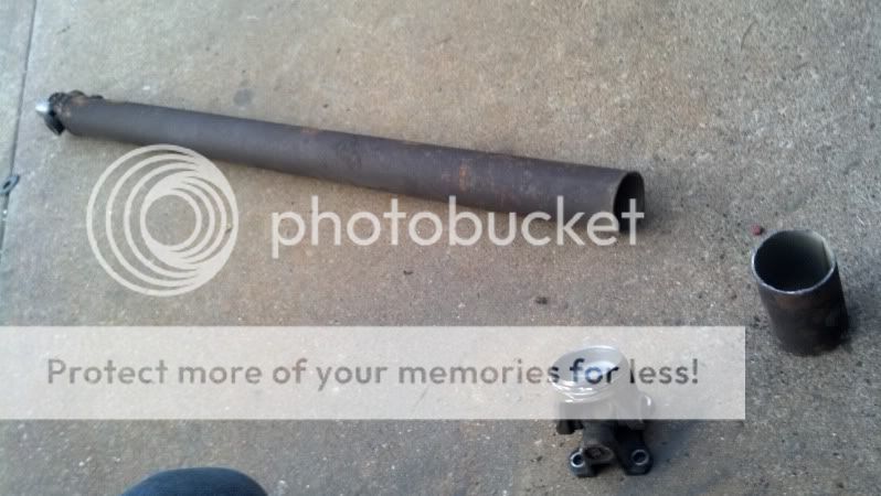

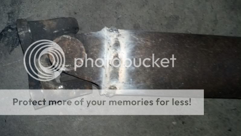

Also picked up a driveshaft from a Town Car. Shortened it 4.5". I'll have it balanced later on.

I leave the driveshaft shortening to a shop, only 35 for them to shorten plus replace the u joints if I supply them.
Sent from my rooted SPH-D710 using Tapatalk 2
I always have before, but I have been told by several locals to do it myself. Figured it was a good opportunity to on a $10 shaft.
Just balance it yourself. All you need is a pair of hose clamps and a buttometer.
Now if the shafts were 10 bucks then yes but I get mine for 25.
I've heard of the hose clamp thing but figured I would take the easy way out plus help keep a small business in business. The guy I take it to is in his 60s and works alone but is well known and the only guy in town that will do it.
