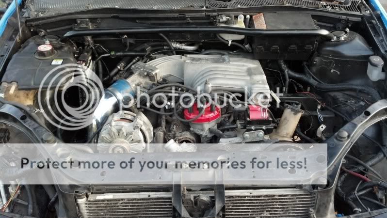

MAF? Yes its plugged in
No, map sensor. The little black box attached to the firewall normally.
you forget to put the drive belt on the front !?!?
Robert
posted with a non-rooted ice cube, and a box of pills.
Not a speed density motor. No map sensor.
Ok, a bap sensor. They are both the same sensor, SD or maf. Just one is vented, one isn't.
Right. I knew that. Wasnt thinking. Yes it is hooked up.
Edit: its not hooked to vacuum
You can check for good fuel pressure with a tire pressure gauge at the Schrader valve to get an idea if regulator and pump are working right. Then check to see if the injectors are firing by back probing the wires it should flash 12 volts on a multimeter or flash a testlight on and off or you could get a set of injector noids.
I'm still thinking its a vacuum leak. It ran before and the only thing I changed was the intake. I'll know more once I pull the intake back off.

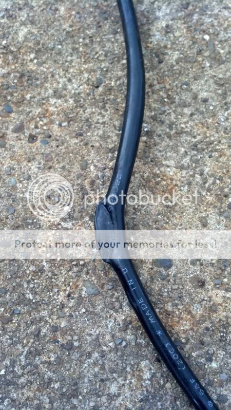

Found this hiding under the back corner of the intake.
disciplerocks's Ford Focus "build" thread
I guess that would be a problem.
though I would check just to make sure, who knows, it might have come that way:)

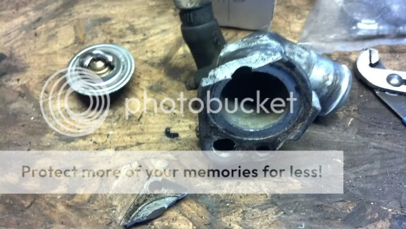

Oops. T-stat wasn't in line.
