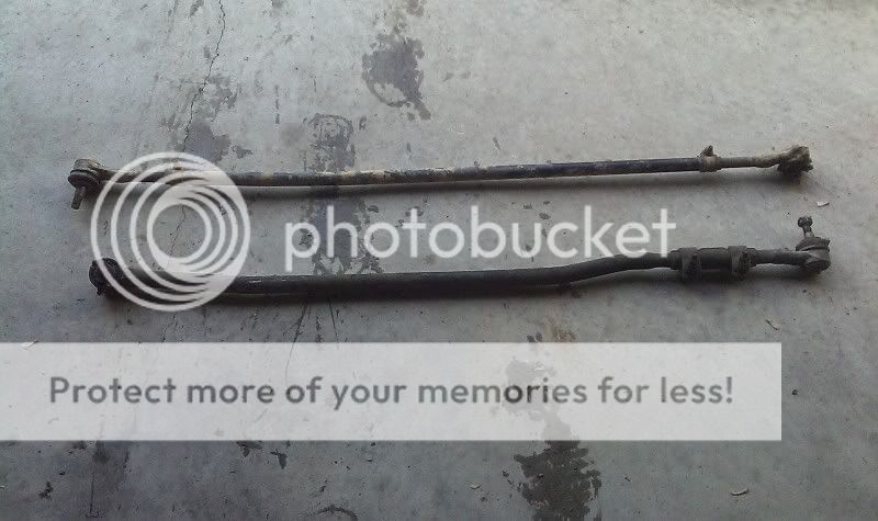

Here are a couple comparison pics
XJ on top ZJ on bottom

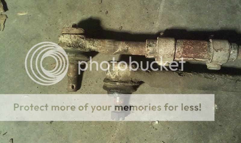

Stock RBV D35 TRE on top, ZJ TRE on bottom. Note the length difference.

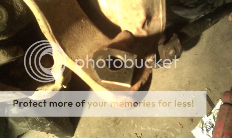

This is what I am going to end up doing. Gonna tack this to the top of the knuckle. I am sure washers would work, but I couldn't find any 5/8 ones laying around and this piece of scrap already had 2 holes in it.

Maybe I'm lost, but whats the washer/spacer for :icon_confused: From the pics, it doesn't look like the ZJ TRE has a longer stud, but actually a shorter one :dunno:
SVT
To reduce the inlet hole. Since it is shorter, it doesnt fit in the knuckle properly and stays loose when tightened all the way.
I was thinking of some type of sleeve or bushing or something to use in place of the washer, since the washer would take up the slack, but still allow the TRE to "move" inside the knuckle...Any way to source/research a bushing/sleeve :icon_confused:
SVT
I gotta pick up one for the bottom too to make sure it stays in line. I'll admit its not the best idea, but it is going to be 100 times better than the way I was running the XJ setup. I would love to find something I could use for a sleeve. Someday I'll invest in some hiems and build my own setup.
