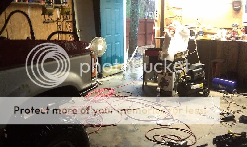

Used the winch to pull the B2 in the garage out of the rain.
