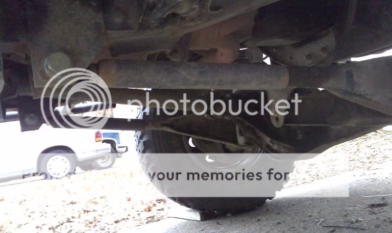

Ok here is the Stonecrusher arms.
disciplerocks's B2 build thread

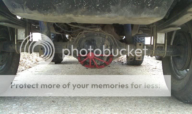

And I got my diff protector on.
Where'd you get those arm extentions? And how much do they run?
