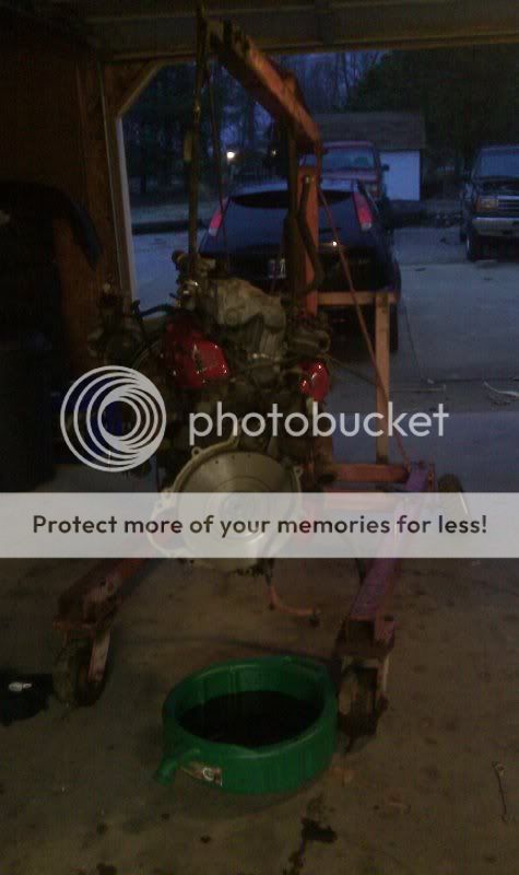

Made it to the u-pull and got my $10 PS pump installed. Also got the oil pan gasket, thermostat, and spark plugs done. Also drilled out the exhaust bolt and welded a nut on the back. Motor is now ready to drop in. Just need to pull the harness from the Ex and work on the 2.9 will begin.
The only thing I still need to figure out is the fuel lines. I know they are not supposed to match up, but I cant find any real info on what to replace them with.

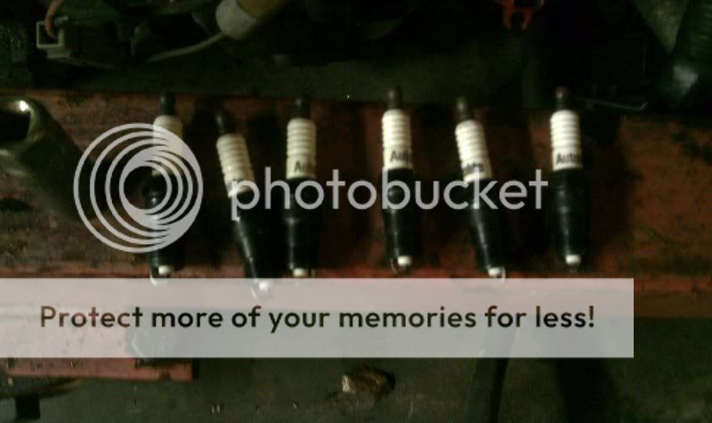

I think these were due for a change
disciplerocks's B2 build thread
Coppers FTW!

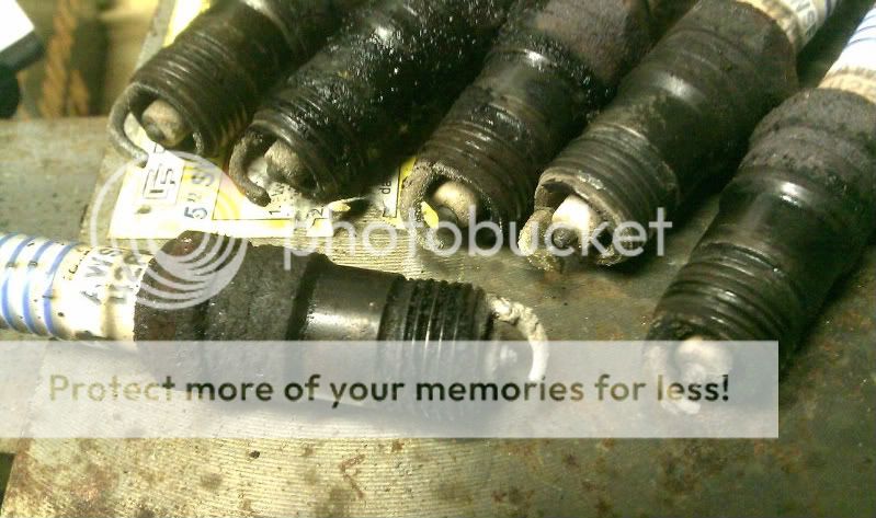

those are some grungy plugs.......
