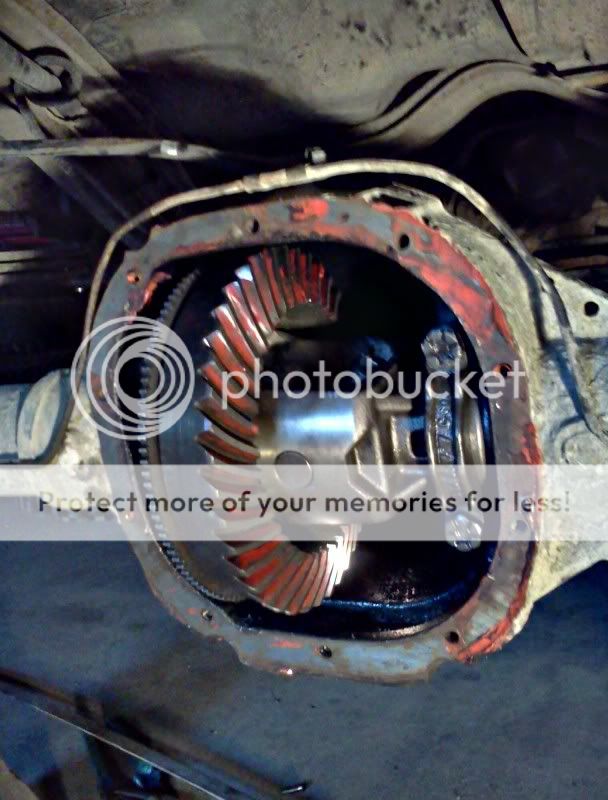

Bought an indicator on my way home today. Measured .012-.013ish.
How's this for pattern?

You won't change the pattern much. Don't worry about it. When I set up gears I read the pattern and adjust pinion depth accordingly. You're not changing the pinion depth. Once its pretty much dialed in I'll set the 'lash and recheck - it rarely changes.
.012 may be a bit tight, but check the spec for your rearend/gearset and see what it is. For reference, mine measured .015 when I swapped in the welded carrier a couple weeks ago.
You can use the shims you've got, just move them from one side to the other. I can't say what you should do without knowing what the BL was before you removed it. You'd probably be fine with the .012 lash, but if it were me, I'd try and pull it out closer to 16.

Ford spec is .008" - .015" (preferred .012" - .015")
I always try to get it tighter rather than looser. My 8.8 is set up at .009".
.007 to .015 is the tolerance for the 8.8's...anything .010 to .015 is acceptable and expected for used gears...
