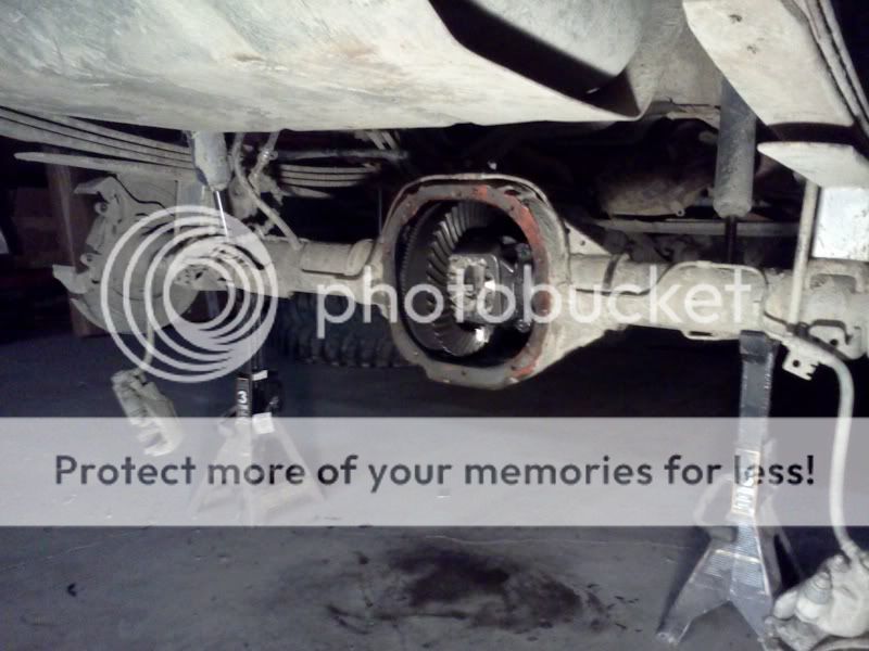

Been a crappy few days, but I finally got back in the garage today and got it welded up, ring gear swapped, and carrier installed. I reused the shims that were in there and it feels like a perfect fit, but I've never setup gears before. Going to try to find some marking compound tomorrow. O'riellys didn't have any.

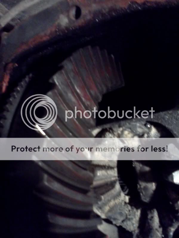

Worked. Thanks. Looks like I need to increase the backlash.
You can't tell by looking. Put a dial indicator on it. Even then, you don't know what it should be because you didn't measure it before removing the old carrier, or did you?

gotta bust your balls on this one, made me laugh....being able to tell the backlash by looking at a ring gear with lipstick on it :D
Ive heard of lip stick and even white tooth paste.
Saved me a trip to the parts store. And no I dont have a dial indicator.
no indicator? you need to be able to rotate the pinion flange about 1/4" to the left or right once the nut is torqued down before it turns the ring gear.....(check the pinion slack on a newer vehicle to get an idea how much the flange should rotate before it turns the ring-gear while the vehicle is in nuetral--BLOCK the wheels first!)
