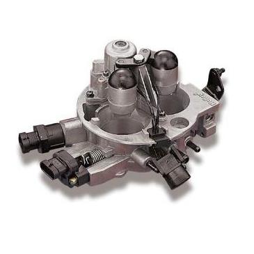

Got me thinking... I bet you the feedback carb system got them a spot in the scrapyard. These early systems had limited diagnostic abilities and next to zero tunability. It's one of those weird relics of the '80s, half-TBI, half-carb. Exactly the thing I like to mess with out in the shop.
I want to make a direct-swap tuneable computer for you guys that have these trucks, seeing as how there isn't one. Make it a package - computer, connectors, wiring perhaps? Just a Plug-N-Go? No, I won't be getting rich, they would be a limited run and I know no one really wants to spend more than a Megasquirt conversion on their old trucks. I also have a lot of experience in software engineering (backup career) and think this would be fun for me.
Now, before I go get one of these BIIs and start screwing with it, does anyone on TRS still have the feedback system on their trucks in somewhat of a stock form and would you guys be interested in a factory-looking tuneable carb "PCM" with useful diag info?
