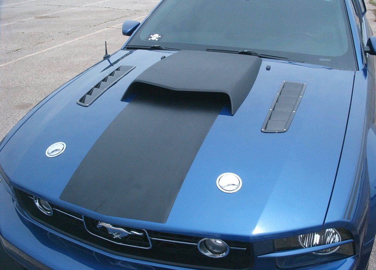

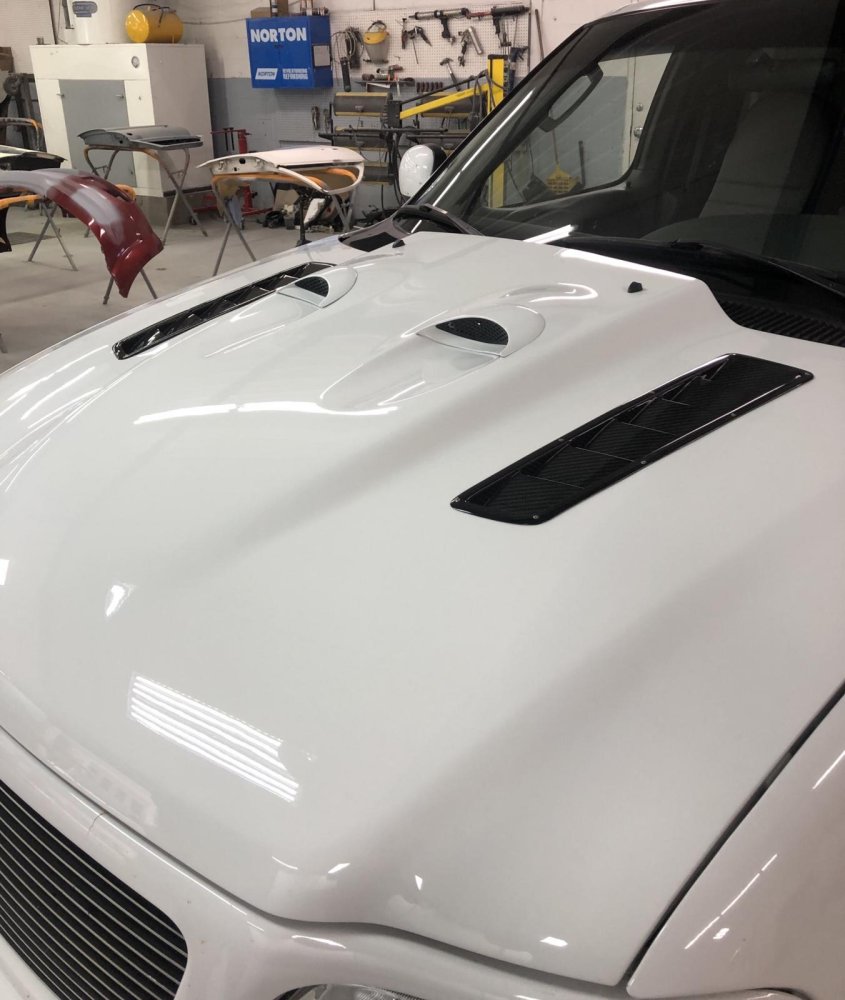

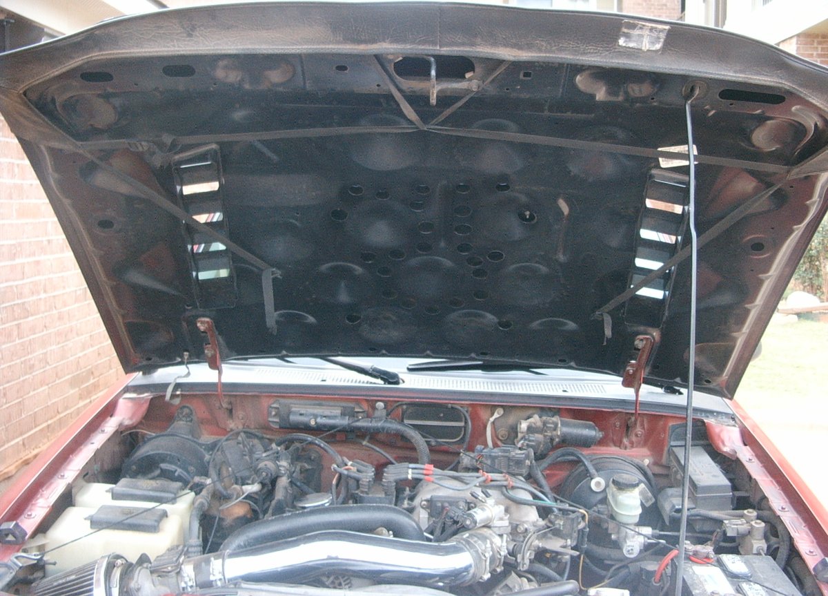

As a rule, for better body aerodynamics, modern vehicles are designed to channel airflow through the engine compartment (after the radiator) down under the body/frame instead of up over the windshield when in motion. This is why you now seldom see factory performance cars with big engine vents in the original hood. Just wanted to mention that, as you might have to go to extremes to get a lot of heat to vent up instead of down.
Notice that your coolant temperature is just fine despite your performance mods. That's a sign the airflow is still venting as the factory designed, under the cab and frame. That's why the cab interior stays warm.
Modifying the fender liners will do more than worrying about changing the hood.
I had always been under the impression that a high pressure area forms at the base of the windshield so this makes sense. The cowl I have was done out of necessity because a part of the engine just barely hits the hood, I've always disliked the look and may replace the hood, along with adding a lump to clear what I need to.
