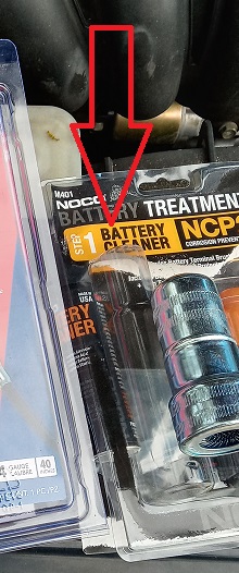

How did you clean everything so the liquid electrical tape would stick? Brake/Carb cleaner?

74773
Used the battery Corrosion Cleaner stuff in this kit. Then alcohol or Brake cleaner, something to flash dry the area. THEN the liquid tape. If I could, I would try to get some heat shrink on there to hold it all in place.
