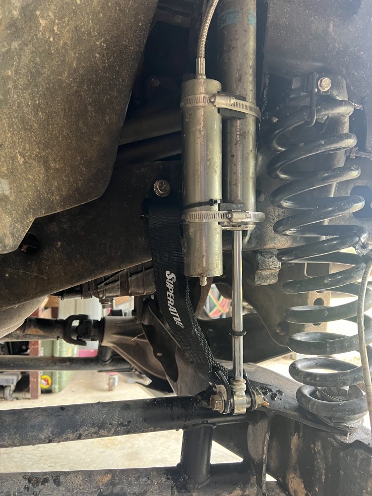

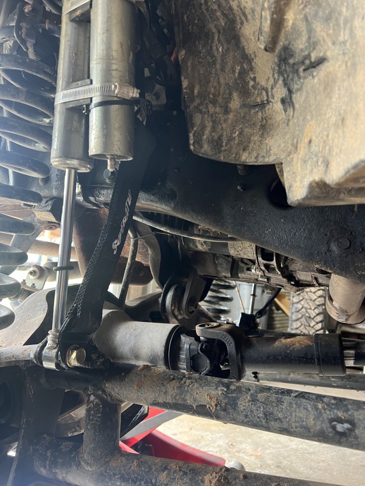

Finally ordered and installed limit straps in the front. Only reason I put it off so long was the spring keepers I built worked well, and during normal droop kept the shock about 1.25” from over extending. I”m happy to have these in and protecting the awesome bilsteins as I plan to start upping my aggressiveness in whoops.

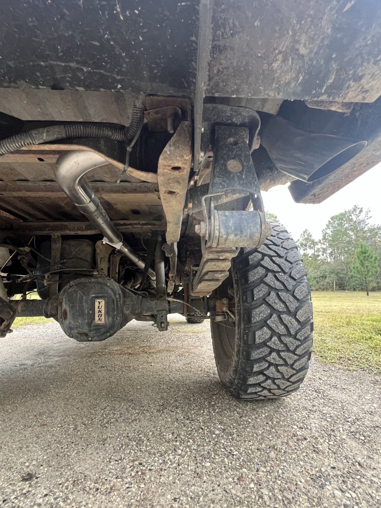

Got jealous after seeing @DRanger024 new exhaust and decided I needed a bit more noise than my previous 2 muffler system made.m which was probably quieter than stock despite the headers. Plus after putting my sliders back on the exhaust dumping in front of the passenger tire was burning the paint off the sliders. So I made a full exhaust all the way out the back with 2.5” pipe and a 2.5/2.5 Thrush turbo muffler which is about 10% smaller case size than the Walker I had on before, while also being 2.5” vs the Walkers 2.25”. I would have bought one of their welded mufflers or something a hair more aggressive but not having a cat worried me that there would be drone or too much noise overall.
This ended up perfect for me! I can’t hear it at all with the windows up and even windows down it’s very very mild. But at idle if you stand next to the tip you hear a nice deep tone that won’t give you a headache. I finished the system off with a 2018 Mustang GT stainless tip and made sure the hangers were nice and tight.

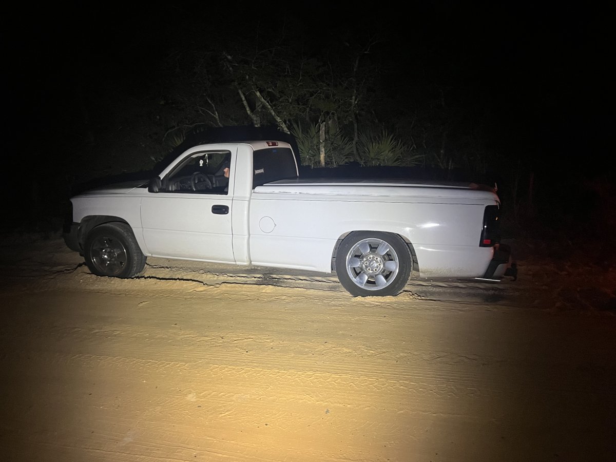

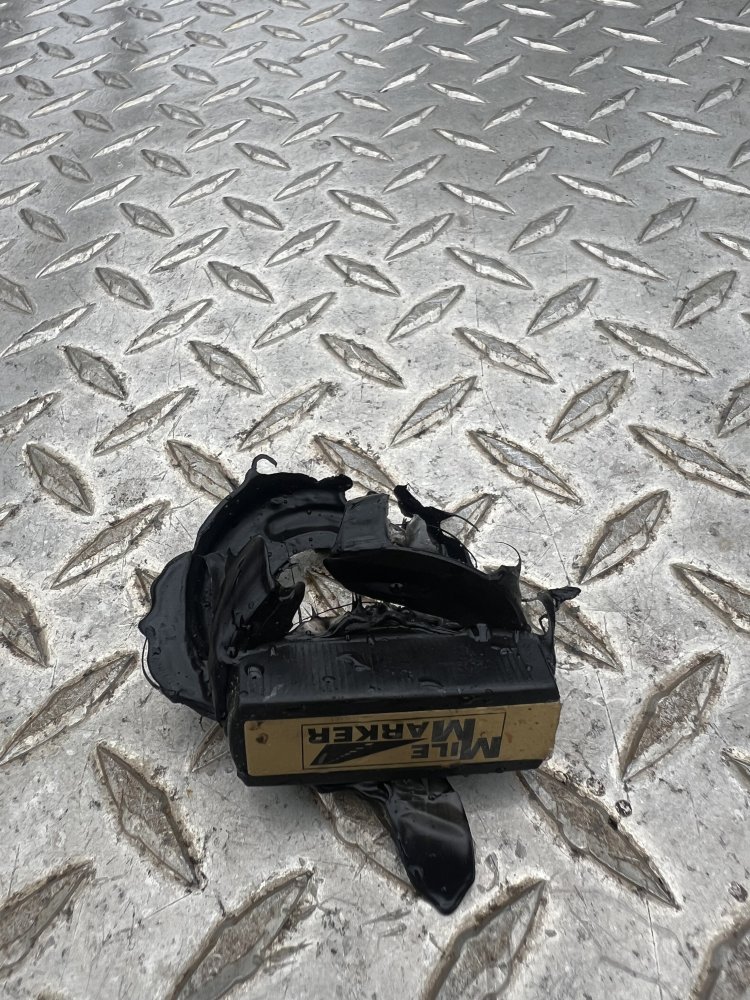

Got a call at 1am this morning and it wasn’t from Santa. A friend had buried his 2wd (more like 1wd) long bed gmc an hour away and didn’t know what to do. I’m not sure why he was out there and not at home with his young child and baby momma, but I could tell in his voice he was desperate so I went to rescue. Only took a bit of digging and a light bump with a kinetic rope and we were both headed back home.

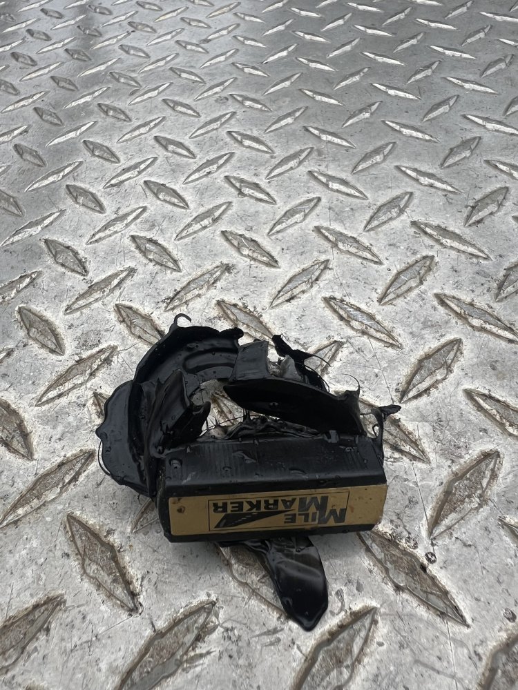

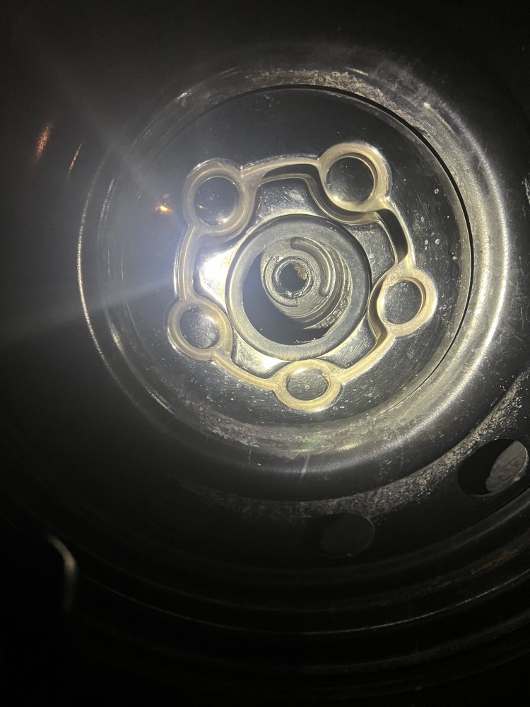

The strange thing is that I stopped for gas 20miles from his location and decided to lock my hubs in at the gas station assuming where he was stuck was possibly very muddy. About 5 miles into the ride after locking the hubs I felt a couple tugs to the driver side like a wheel bearing or caliper was trying to lock up, but kept driving because what choice did I have. When I arrived 20miles later my driver wheel was very hot and my locking hub had melted the plastic turn thingy completely off.
I’m assuming it’s a wheel bearing that’s just coincidentally dying extremely prematurely but the fact it happened directly after locking the hub in has me concerned. I have driven many times with the hubs locked before just out of laziness or forgetfulness.

Here’s the hub selector that melted, such a strange event, I guess I’ll buy new bearings and seals and prepare to pull that side apart again.

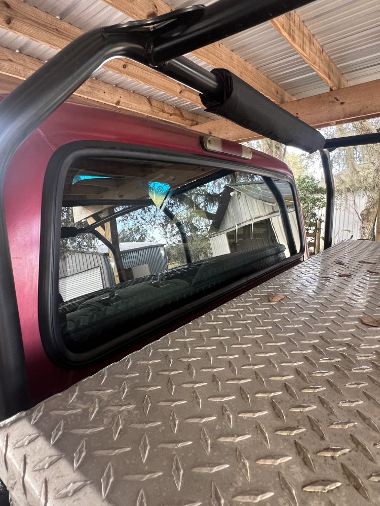

Got my back window that I busted the sliders on replaced with a solid unit, I definitely like it more although I’ll have to get it tinted at some point.

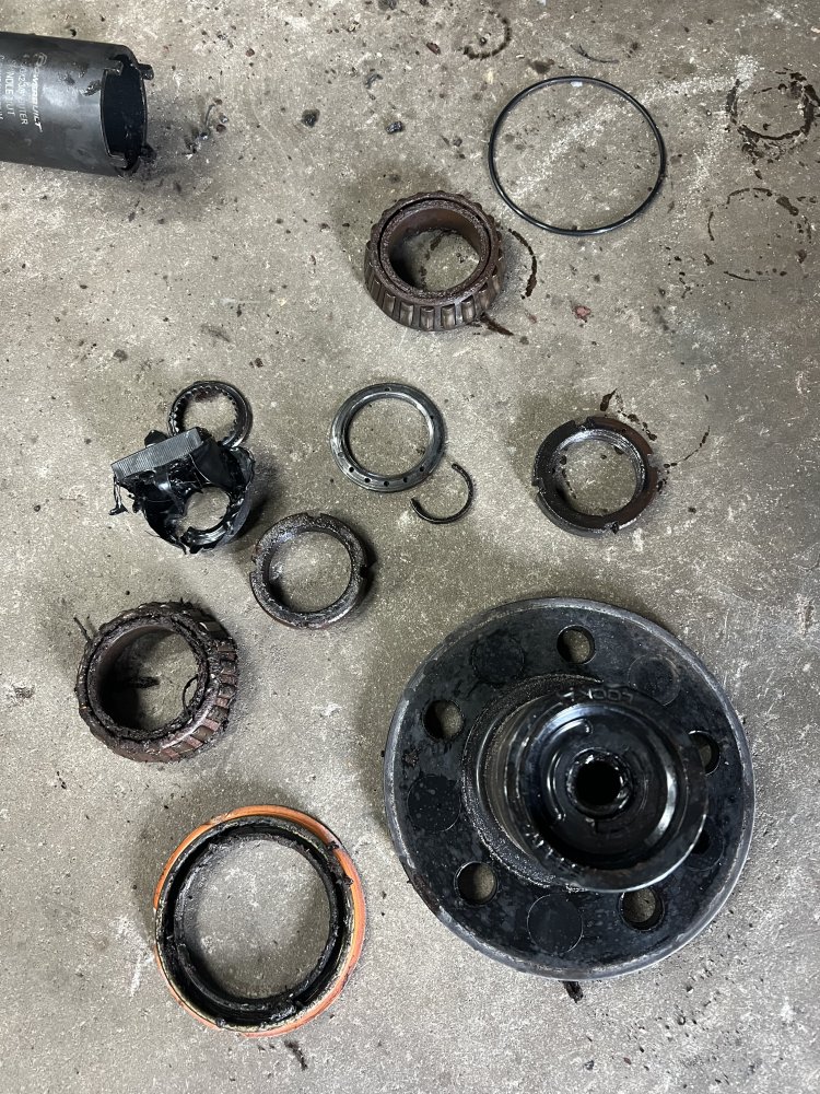

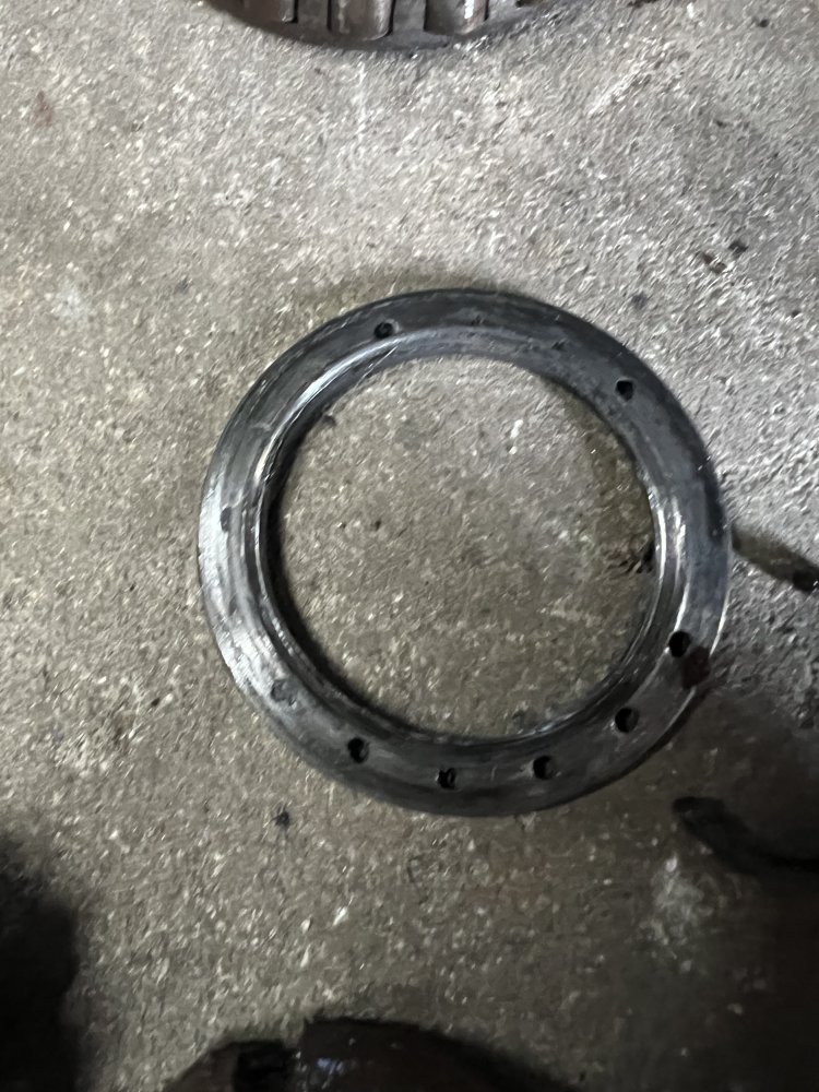

Dug into my mysterious melting hub selector to find some stuff appears to be F*%$ed. Not sure what the culprit was but everything other than the inner locking nut was backed almost completely off. The locking washer thing with the keyed index is missing the inner key completely, and the nut part with the little round dowel that fits into the keyed washer is also busted off. So something bad happened at some point, I would love to know if it was installation error or what. I find it so strange it happened during normal pavement driving.

I would go with "installation error". It is easy to make one there if you;re not careful or maybe not sure how it goes.
Not long after I bought my 93 I had a tire put on it and the kid who was given the task of installing it pulled the wheel off and the previous owners shop had put the hub on with using any locking washers. I was able to see somewhat from the waiting room, but was nigh on to making the window an entrance to the shop
