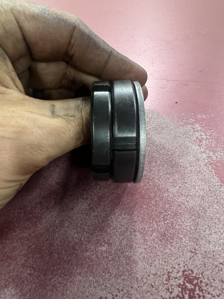

I figured out what I did wrong before. I basically had the stack of lock nuts/washer wrong. I think I’ll keep the instruction sheet in the tool box for now on. Luckily the passenger side didn’t have any issues because I had that one wrong too.

Opps... those spindle nuts have been around since a couple 60's ford trucks I've owned. That lock washer has always been sandwiched.
Another trick... once you get the bearing preload set... if the lock washer won't line up on the pin... flip the lock washer. The holes are slightly off set from the key.
Not exactly sure of the torque spec on the outer nut... but it should be good and tight.

It’s a good system when you do it right. I’m just glad I learned my lesson this way and not the more expensive “wheel passes you on the highway”. Not gonna lie I’d still prefer the unit bearings that come as a pre assembled package and just bolt onto a spindle. But the IFS on those trucks suck and those unit bearings are triple the cost of all the bearings and seals in this system so I’ll just stfu lol.

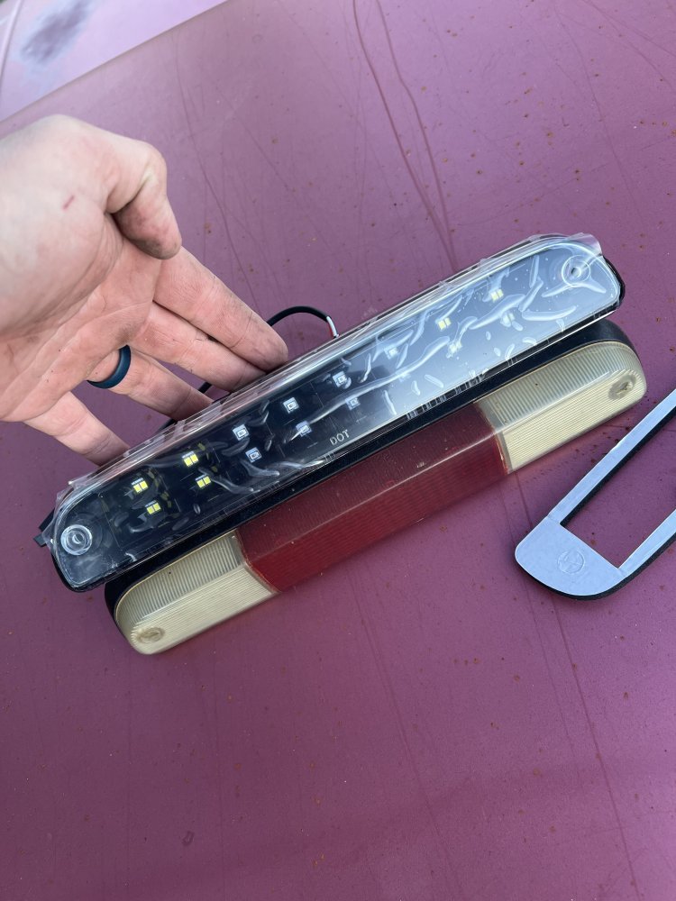

Forgot I ordered a new third brake light. I originally thought my windshield leaked so when the guy came to do the rear window I had him check the windshield as it’s only a year old. Windshield was fine and they spent 20minutes spraying everything looking for a leak to find it’s the dang third brake light. I should have guessed that myself honestly.
Anyway here’s some ugly $18 Amazon led third brake light that replaced my hella crusty probably original leaky boi.

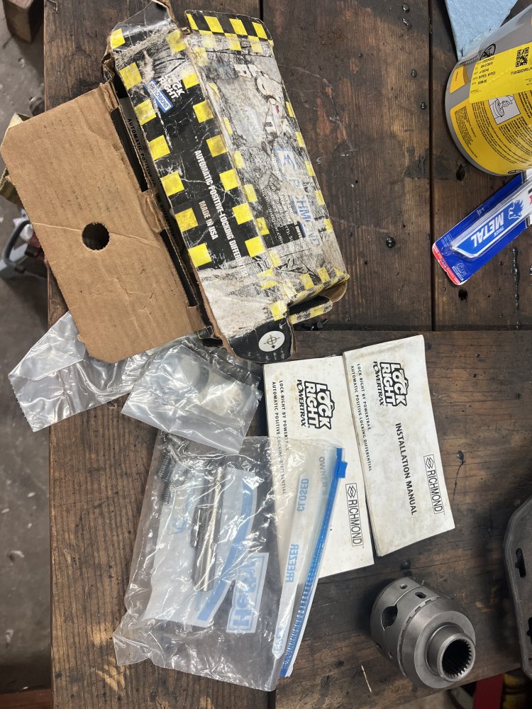

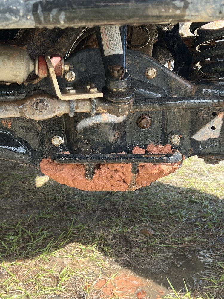

Wasted enough water to hydrate a village this morning trying to wash the clay off this thing. Mud isn’t so bad but thick orange clay seems to never wash off. After cleaning the truck I cleaned up the shop and refound the locktite I have for the front 35ttb. Originally I was planning to run 35s so I was gonna leave the front open, but after actually wheeling the truck I think it’s totally fine on 33s, but I do want the front locker. So I guess I need to plan the miserable tear down of the front to slap that in sometime before summer heats up.
I find it cool that the gears and lockrite I bought were from 2006 and the guy just had them sitting in his garage this whole time.

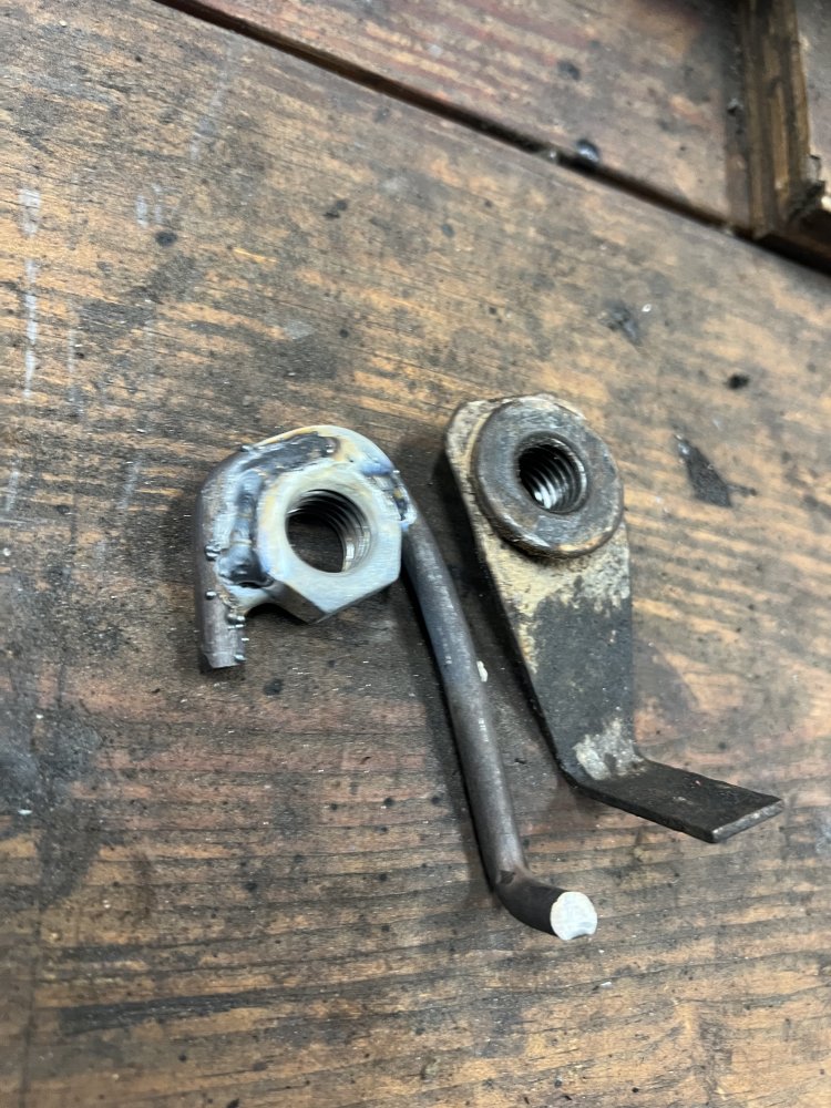

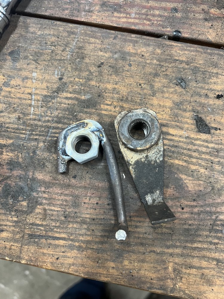

One neat thing I did get done is that the new greaseable bolts are a different thread pitch than the old ones that had the self holding nuts on the backside. So I made my own!

I had thought of doing something similar with my rear hanger to shackle bolts.
I was in a hurry and I ended up using a crowfoot wrench and a 3/8 breaker bar... let it rotate up against the hanger.
You'd think that round stock would bend.
Funny you said crows foot, at first I jumped up to go grab mine. Then I tripped over my Mig lead I hadn’t put up yet, and thought “future me would thank current me if I make this nut like the old one”.
I was gonna make it out of plate like the OG, but the round jumped out at me when digging in my scraps bin. It worked so far for the first one, can’t tell if it bent a little but I doubt it will bend so much that it will back out or fail.

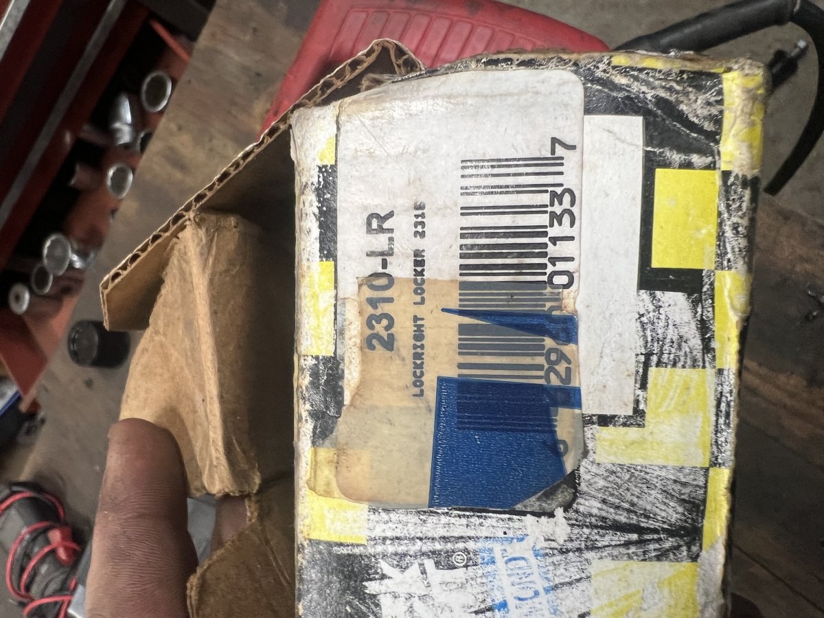

Whats the model number/part number on the lockrite?
Uhhh good question, is old a part number?…… Jk it’s 2310-LR. Google says for a Dana 35 so fingers crossed it fit. Luckily I told my scrap guy not to touch my old diff so I can practice installing it there first. Had to physically double check the little prick didn’t take the diff.

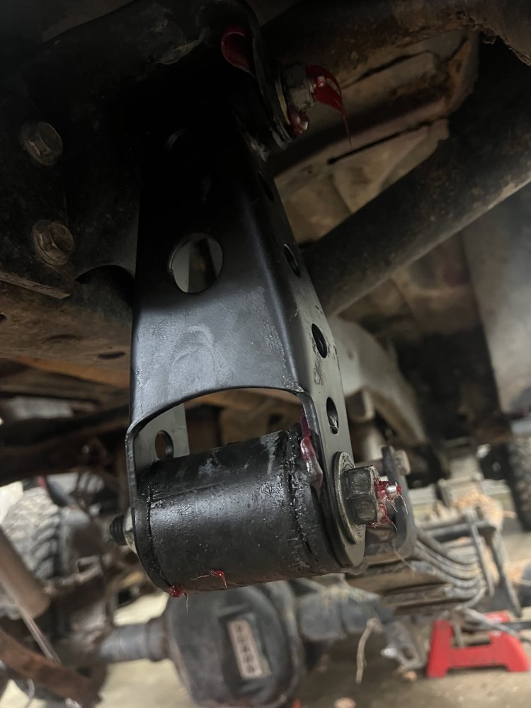

Finished the greasable bushing install to the best that I can with what parts I have. Ended up punching out the poly bushing from the new knockoff 6400s and installing the 1 1/2” bushings and greasable sleeves/bolts. Then on the rear spring eye I simply pulled the original sleeve out and drilled two small holes so the grease will reach the bushings, then installed the greasable bolts. Luckily the rear bushings after being cleaned are in great shape and have the grease grooves in them so I really don’t feel the need to replace them anytime soon. However I will order the Kevlar replacements along with the front spring eye parts.
