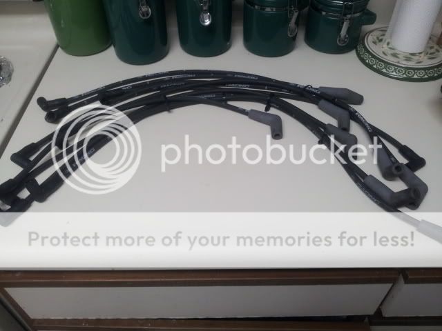

The guy that was giving me what efi stuff he could found out his brother took the stuff and sold. Well his brother is parting out his 306 and the guy got these off his brother and gave them to me for free. Ford racing 9mm wires. But before I pit them on the truck, I will be wrapping the headers and getting wire wraps so that I don't burn through wires again.

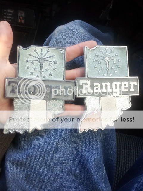

Went to the jy with my buddy and found these. They are made of metal but have never seen another ranger with them.

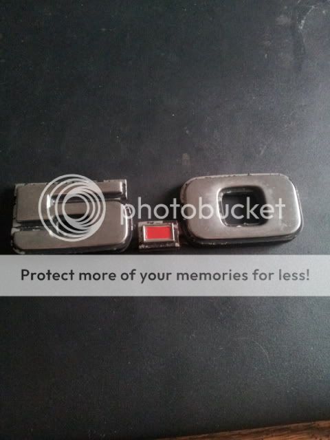

Also got this off a mustang that was there, one had one fender do I took the one it had. I will mount it to the tail gate.

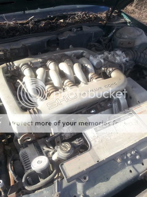

Also find a SHO Taurus by accident when I opened up the hood.

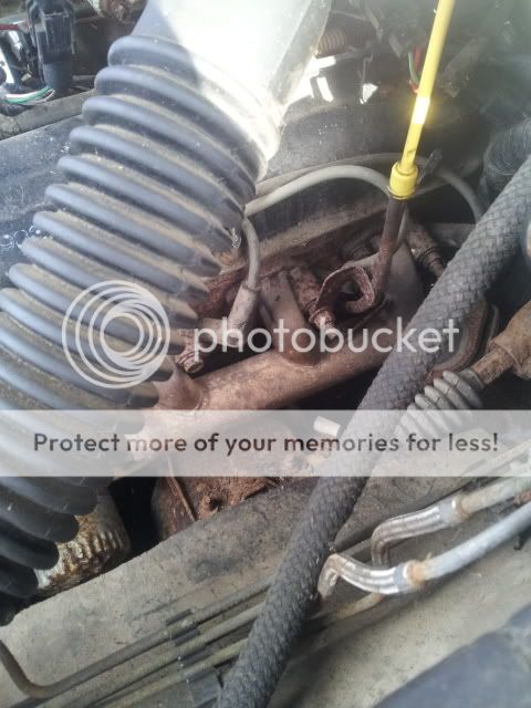

Also a few of my spark plug wires are toasted due to header contact and arcing to them but those and that taste will be fixed soon enough. Other then that she starts right up and can make those mud tires talk to me, something my 2.8 couldn't do, not even on a rain soaked road.

The Taurus fan is only ran on low and they pull 30amps I'm told. It's on because where the temp sensor is, top rad hose neck. To fix it, it needs be relocated to the bottom hose.

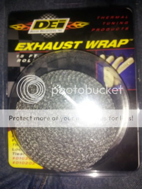

Header wrap came in the mail today. Now to wrap where the plug wires want to come in contact with the headers so that when I go to install my 9mm wires I won't burn them up. I will be double wrapping the areas to be safe.
