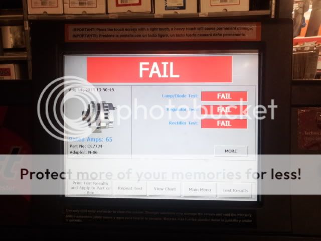

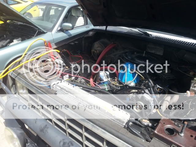

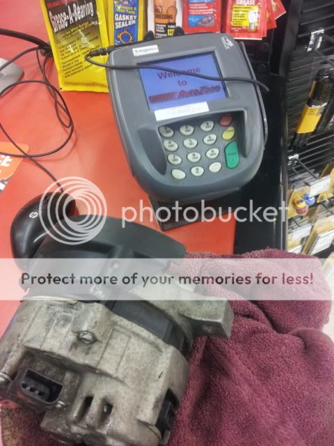

Had to miss work today because the day started with a trip to here because this went out....
They tested it for sh!ts and giggles and this was the result...
The mother in law helped me back and forth to AutoZone and to jump my truck.
Running under its own electric power and tested by starting and restarting the engine.
Total time , 1 hour 45 minutes.
Total cost, $106.99 with the core brought in.

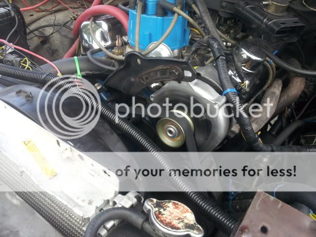

The past couple of days I noticed my dash lights and head lights weren't as bright as normal along with my idle being slightly higher due to my electric cooling fan not putting a load on my alternator dogging down the engine slightly. Good news is, this alternator had a LLT warranty. Bad part is, I only have a 65 amp one, want to get a 100 amp one put in.
Sent from my rooted SPH-D710 using Tapatalk 2
You might look into doing a 3g alt swap if your FEAD allows it, will net you 130 reliable amps.

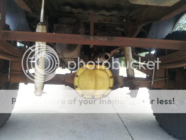

Got a couple of things that I wanted to get fixed on the ranger done. Changed out two of the axle ubolts and now my axle wrap from having bad ubolts that I couldn't tighten is gone. Also rotated my fan and shroud so now the back of the fan motor isn't going to be able to hit the water pump pulley nub and the bolts plus the rad is getting cooled from top to bottom and not all of the top from side to side. The fab dues such a great job cooking that I can leave my hand on the rad when there hot fluid enters and I never have to take it off.
Bad part is, my fan stays on at all times because of the thermostatic temp switch (big term for the switch that tells the fan to turn on at a certain temp) sitting right after the thermostat in the hot coolant that she's in the hose because the rad can't take anymore so now I need to get 185 thermostat sui that the coolant will circulate more often plus my fan switch is made to turn on at 195 and of at 185 and in theory coolant higher then that will pass through to be able to turn the fan on. Only takes 12 seconds out so for the coolant to be cooked by the electric fan.
But until I can get my temp gauge in to add his hot the engine is, but going to touch anything. Couldn't get it in yesterday because the engine didn't cool down enough while I was doing the rear ubolts.

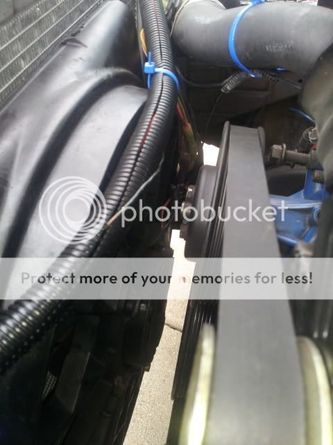

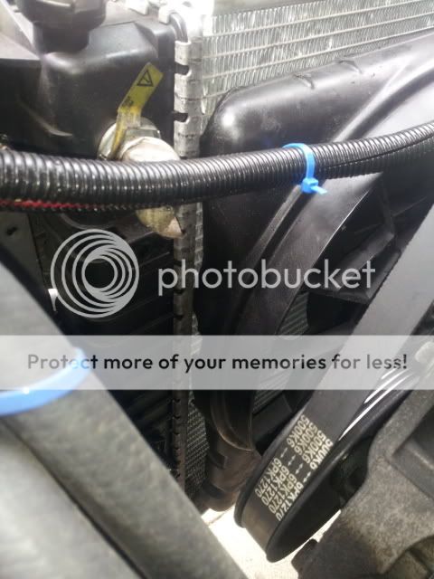

Pictures of the fixes...
New ubolts...
Fan in new location
And the clearance I have between the FEAD and it.
