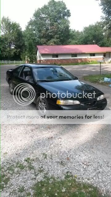

Buddy has a cousin selling this for 750 and may get it next weekend. Only that cheap due to they are moving in two weeks and need the money but also have a third child on the way. 1997 thunder bird with the 4.6, auto and 188xxx miles. Only rust spot it has its above the driverside wheel well. Had a slight coolant leak but looked it up and these are prone to that around the intake. Other then that, anything else about these cars that I should worry about?

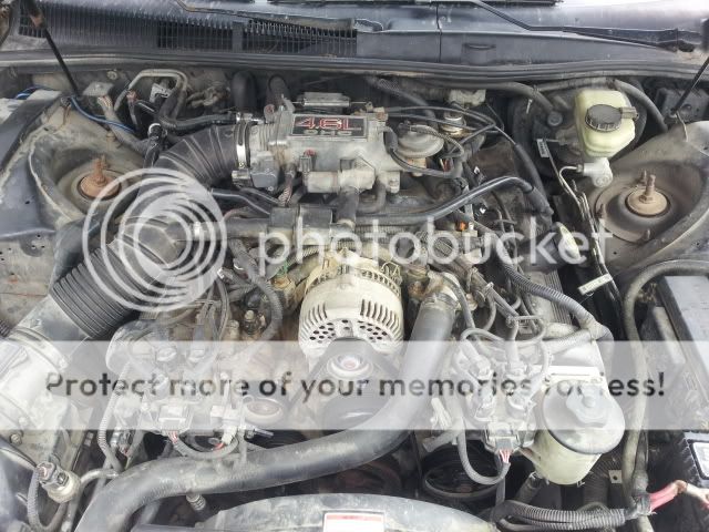

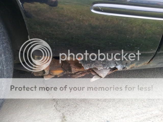

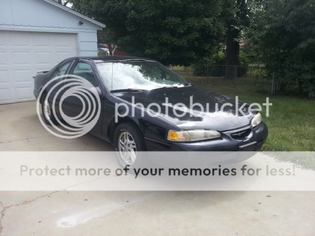

Bought the car. Intake has a coolant leak around a bolt and needs rear tire, one has a leak in the side wall. Body needs some TCL and interior needs shampooing but doesn't smell. Other then that runs and drives smooth. Was told that it has had an intake change to a better one, not sure on that yet.

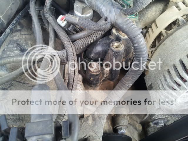

The coolant leak.

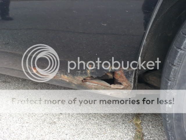

Body rust

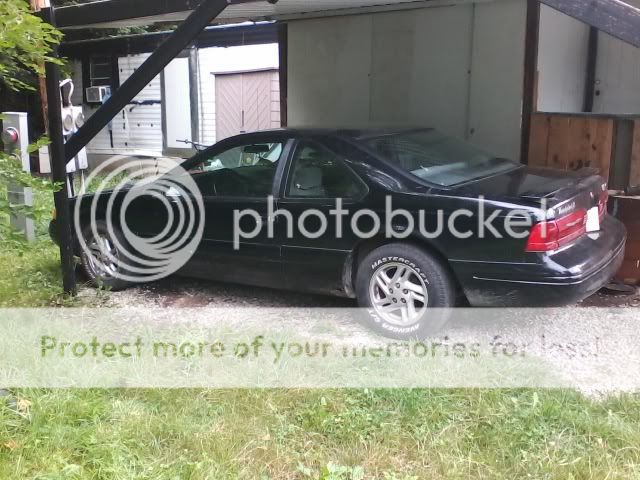

Just got insurance but plates will have to wait till tomorrow. Plus I need to find out what my tire size is, going to replace the rear tires for now.
Sent from my rooted SPH-D710 using Tapatalk 2
Got the plates for her, at least the paper one.

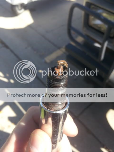

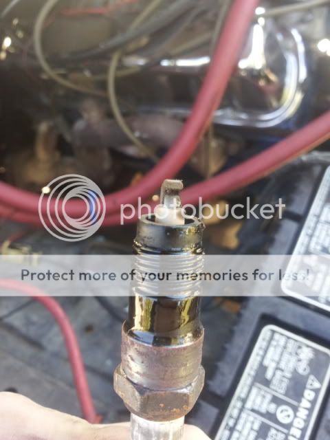

So after a year I decided to pull a couple of plugs and see what they look like. Pulled number one and was surprised that it wasn't black because of my 8mpg I'm getting, kinda looks as if I'm running lean. Also looks like I have a valve letting a little oil pat is glide or exhaust isn't exiting good, need to mark the plug and screw it in to see.
But when I pulled number 4, I got kinda worried as it is nasty and wet but not clean like it's burning coolant. Last time it was driven was during a raining day and maybe a valve stayed open plus the two fluctuations going on?? But not black like expected either.
Going to run the engine to temp, let it cool and pull them one by one and check from there.
