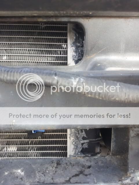

It hasn't leaked the last couple of days sitting in this warmer weather so I crimped the fingers as tight as I could then put some jb weld in the area that was leaking. Not pretty but hopefully it holds till I can afford a new rad.
I also have made it so the coolong system doesn't pressurize but will instead put the over flow tube into a pop can...as soon as I can find my zip ties.

Drove the truck for the first time since I did the plug wire swap and what a world a difference. No more back firing, no chugging, struggling, etc...in 4th gear. Don't have any leaks that are dripping on the ground but I think it's leaking out the lower weep hole to where outs dropping onto the crankshaft and evaporating the anti freeze making it smoke a little. So now I'm probably after a new water pump but I'm going to price out a different one then a new unit from auto zone that it has now that is giving up after only a year.

My water pump isn't leaking anymore but nite the smoke is coming from the center if the rad but nothing is leaking there either.

My first water pump was leaking between the backing plate and the main housing. I got a new pump (just to be safe, it was a PITA to get at) pulled the backing plate off and put the 3H aviation sealant on both sides of the gasket and made sure it was snugged down good.
It was dripping down on the crankshaft pulley just like you said, but from the back of the pump.
To be honest, that actually looked exactly what it did the very last time it was dripping and smoking before I looked again and it appeared that it is coming from my rad.
So what backing plate are you exactly talking about, the one on the back of the pump that has a small gap in it at the base?
I'll try and get pictures of what I'm taking about.
Sent from my SPH-L710 using Tapatalk
Yeah, it is the plate on the back of the water pump. It was a painfully slow leak but I could see it was leaking there and not between the WP and timing cover.
I'll get some good sealant and seal it while it's still in the truck and see id that works.
A slow leak doesn't bother me as much as my truck is smoking at a red light and everybody looking at it for that and not my choice of body pannel colors.
