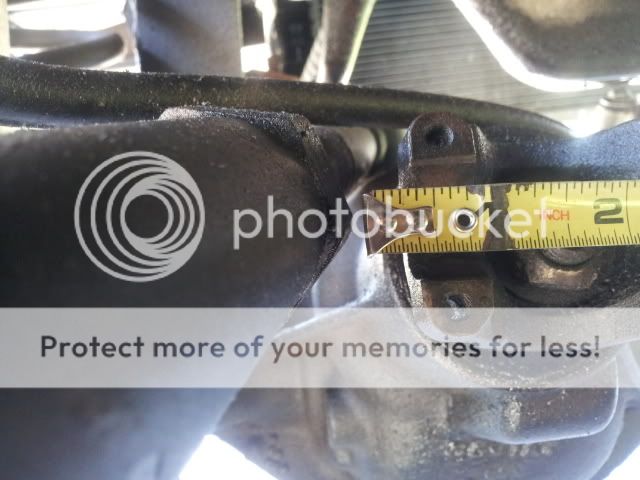

Need opinions. Have a front driveshaft out of an f150 with 1330 joints on both ends. The front diff is where things may get iffy. Going to be running a 1310-1330 conversion joint and that will be fine but here's the new clearance I will have with the 1330 joint next to my long arm for my d30. Think I should just play it safe and get a shaft that has 1310 joints at both ends and just run my conversion ujoint at the tcase or is there a 1310 slip joint that will slide into my current f150 shaft?
You can see that the 1310 use to touch the long arm jam nut but not anymore, my trackbar use to move alot allowing my axle to move aside to side (axle still does slightly because my trackbar mount flexes but we'll fix that soon too).

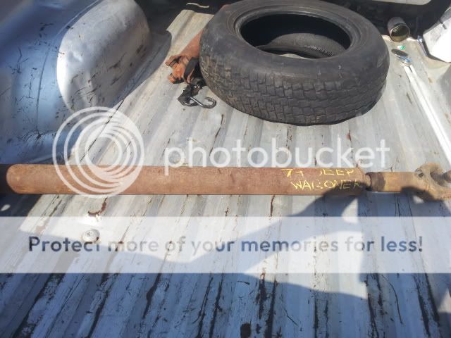

Went to the JY and got another shaft. From the writing its out of a 1974 jeep Waggoner. Good thing is, the slip joint has a grease fitting.

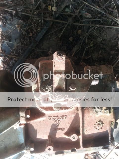

Now I also saw this when I was there. A PTO drive that hooks to a GM transmission of some kind. I severly doubt that it will fit my trans though but it does rotate when the trans does and the lever works too plus the what has no play in it. I wanna say that this trans came out of a tow truck.
Sent from my rooted SPH-D710 using Tapatalk 2
Those where also used in dump trucks, just don't forget to disengage in when driving down the road, I have seen quite a few that got blown apart because the driver forgot to disengage it.
Robert
sent with a American Flag, and a silver dollar coin.
If it were fir my transmission, it would have come out with me.
