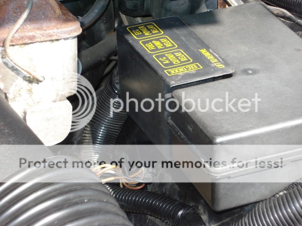

with the taurii type fans i have used double 40 amp setups with no real issues. (thats the feed of one fan speed with heavy gauge wire across two relays) i have hurt the fox 4 cyl mustang fan switches though as i think the cheaper relays pull too much to throw them. this of course is solved with a low pull relay to throw the two other relays....gets to be a bit of wiring but if you pull a 3 pack unit that runs the eec and fuel pumps from certain crownvics/lincolns you will have it all in one nice neat package. i usually have those laying around but i built a few harnesses recently and they were incorporated into those.
this is the relay setup from the vic type cars.
