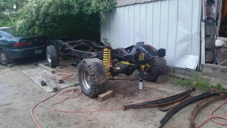

I have a eb d44 I am planning on swapping into my 2wd ranger, now couple of urgent questions seeing as I'll be starting the swap next weekend
1) I read somewhere if you use stock coil buckets with eb loft coils it increases the lift by around 2-3"s? Is this correct?
2) I have the "Y" style steering linkage and it seems to short, will the "T" style work with minor modification to the drag link?
3) will the Rangers front driveshaft bolt up to the eb d44, and rear shaft with a eb 9"?
4) anyone have a mock up for track bar mount, or dimensions/blueprints on a functional one?, (will be using stock eb adjustable track bar)
Depends on the springs, it's really hard to tell though. A 3" EB lift coil might get you 4" in a Ranger, or 3", or 2". Safe to assume that the amount of lift advertised for the coil you're looking at will be fairly close but you will need to try it to be sure because of weight differences between an EB and a Ranger.
already answered this one
Maybe. The u-joints are the correct style, you'll have to remove the bolt on flange on the rear shaft, and measure for length on both. Safe to assume that nothing in this swap is "bolt on"
The track bar must be parallel to the drag link. If it's way off you'll end up with some really awful steering/handling, perhaps not even roadworthy. Build your mounts off that concept. I used a factory EB track bar for mine but had to make it longer and put additional bends in it to clear the engine crossmember.
Some information
Depends on how much the lift coils are designed to lift
No, completely different
Depends on lift but probably not
Probably have to build your own
Good luck
I'm going to use partsmike.com for steering, ordered a weld on bracket for the track bar and adjustable track bar that I'll be modifying to work, as for lift the front I'm not sure how big it'll be but the rear is factory Springs and blocks with the belltech 6400 shackles
